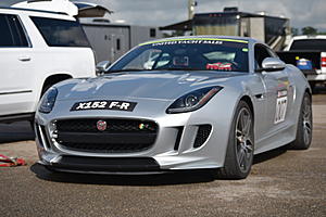

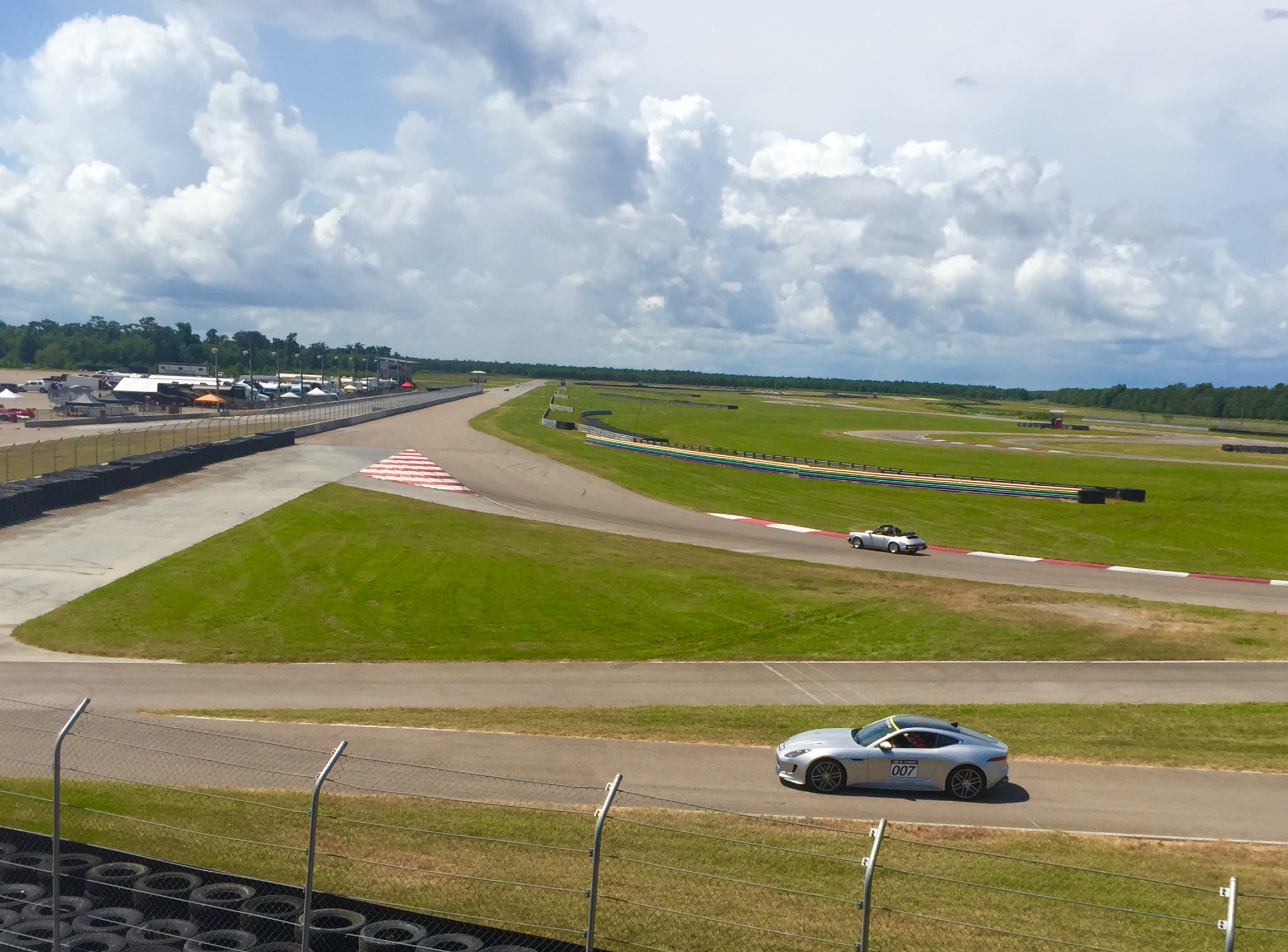

It has been awhile since I've taken the big cat out on the circuit. This past weekend was a Porsche Club race weekend at NOLA, which included an HPDE event for experienced (solo) drivers. Prior to the event, I brought the car in to have it checked out by Jesse my "crew chief" over at Bullard Jag in Mobile, AL. I had him go over the car - we changed the oil, and I changed out the brake fluid to Castrol SRF, and did an alignment - all OEM spec, nothing radical. The rears are not really adjustable but the fronts did need some tweaks to bring them back into alignment.
I experimented and changed tires from the ContiForce in OEM spec to Michelin Cup 2s in a slightly larger configuration: 265/35/ZR20s on the front, and 305/30ZR20 on the rears.
For the street, the Michelins are considerably harsher when cold, but they smooth out when heated up. They are really a "street-able" DOT legal track tire. They handle the rain just fine on the AWD Jag. We did a session in the wet and they performed very well.
On the track, I was able to reduce time by 3 seconds (from 2:10 to 2:07) switching from the Continentals to the Cup2s. And, they felt like they had much more grip - really sticky when pushing hard. I'm not sure what my cold pressures were, but hot starting at 30/32 resulted in 34/35 psi when heated. 3 seconds is a lot, but I am not reaching the times of a Porsche GT4 which is around 2:00 flat.
NOLA is particularly brutal on the front left. The Cup 2s with minimal camber do burn thru the outside edge quickly on the heavy Jag. 3
The Jag performed very well again. Braking was very good - except I did feel some performance loss when braking at top speed 135+ late in the sessions, but otherwise was as good as many of the much lighter race-equipped cars.
The Jag does struggle a bit mid-corner and I do feel its self-preservation nannies cut back on the throttle response if she wiggles or when coming out of high-G turn. That is fine with me, as it keeps the car and its occupant safe.
As usual, the Jag turns head (and ears!) and gets many compliments from the other drivers. It's a hooligan for sure.

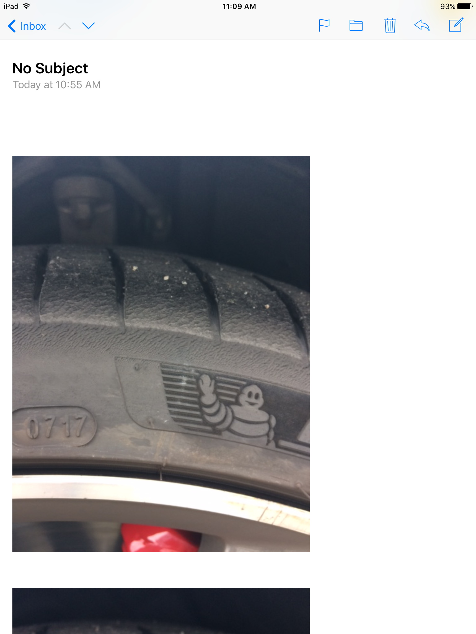

Interested in some tire pressure - tire wear advice.
Had hot tire pressures of 45# and the back end feeling slippy so droped them to 45# and the car felt more settled at the back but thought more understeer from the fronts.
In the past I've debated adding a couple of # to the fronts to reduce understeer with those who say, add a couple of # to the rears to reduce the understeer ( I think , by increasing oversteer...but I'm not sure or possibly it's that I don't comprehend the whole thing)
This will be my first effort at posting pictures. If successful the 1st will show a front tire with Mr Pnu almost loosing his fingers....severe "roll over" and the next being about what I like to see being a rear tire.
Help and advice gratefully received.

Scheesh....should say "dropped them to 43#"

Which tires are you running - the Sport Pilots or Cup 2s?
Either way that is WAY TOO much pressure. YES, spirited driving will cause your outer edge to wear prematurely, but that is part of going to the track with a street alignment. Race cars have 4 - 9 degrees or more negative camber on the fronts to get better all-around tire wear. Nevertheless, all sport tires grip much more with hot pressures in the 30s.
Tire pressure is about balancing the grip. In a perfect world, all your tires will be at the same temperature when you pit in. Similar temperatures indicate equal distribution of the work/grip. This typically means taking more air out of the fronts as they tend to heat up more causing the front air pressures to rise much higher relative to your starting pressures.
Each car, and each track is different - but 45# will get greasy in any soft compound sport tire on any track.
You don't have to worry about under steer on the AWD Jag. Just get your temperatures balanced and she will drive happy happy.
