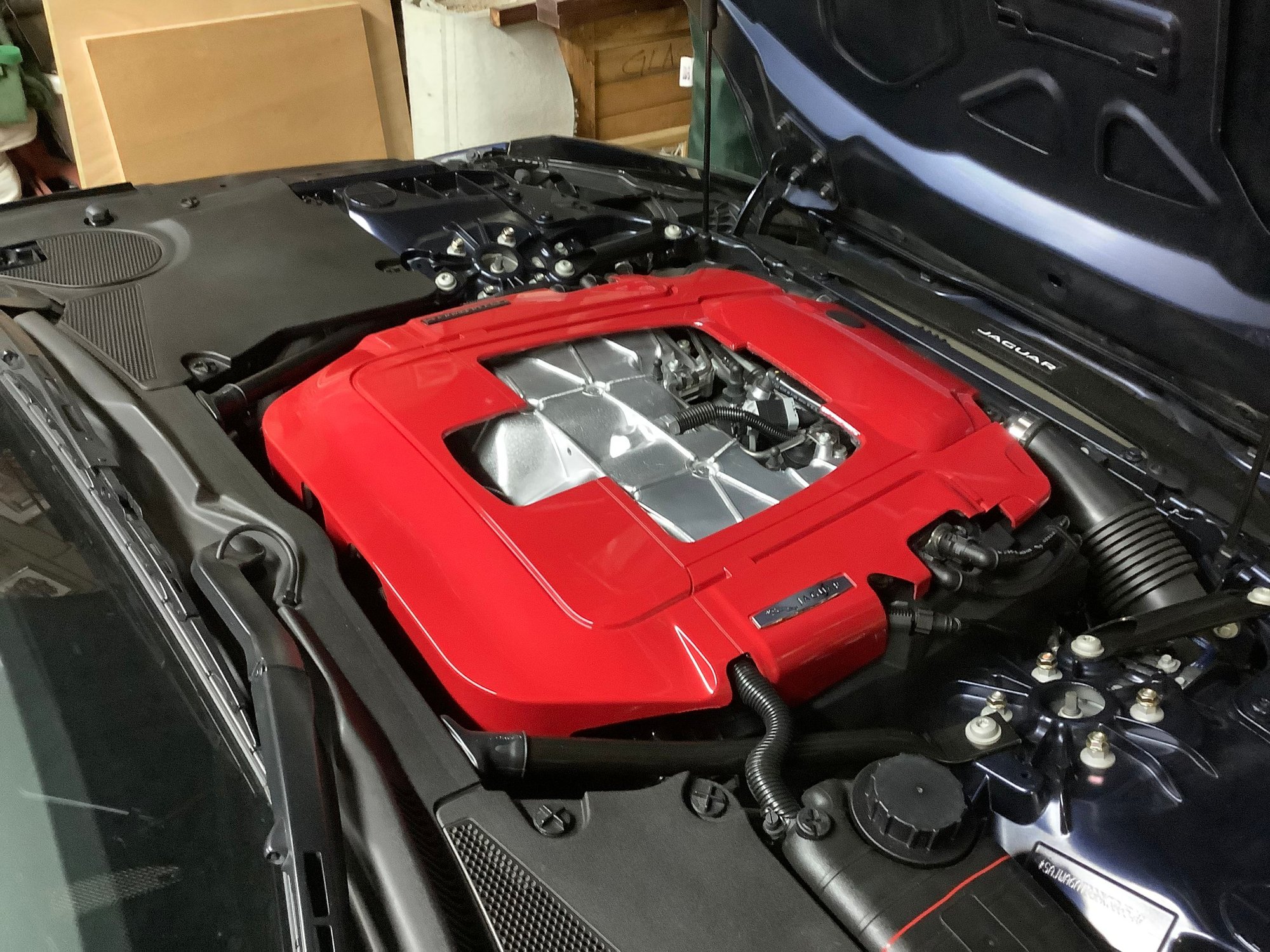

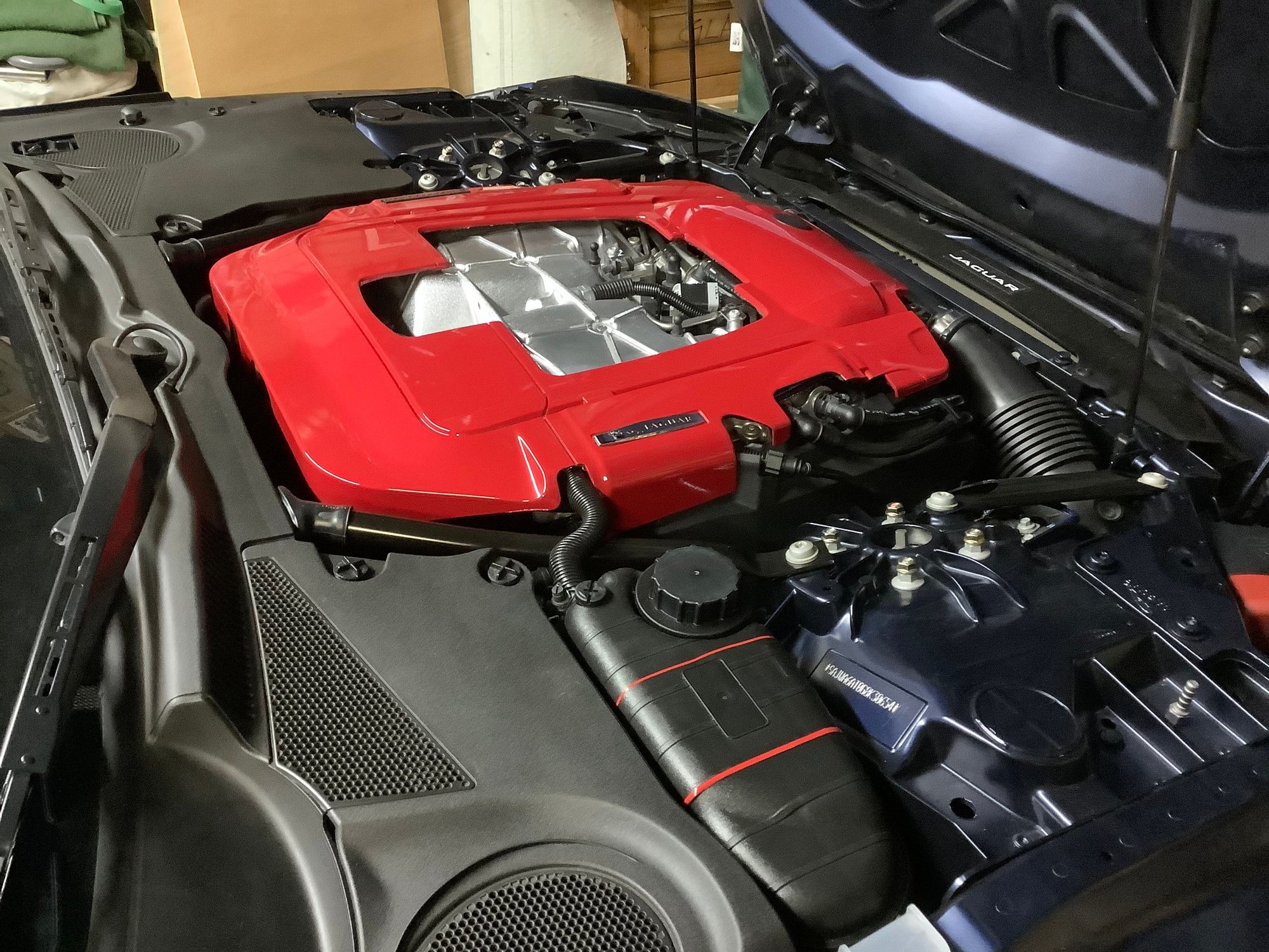

Decided that since I was not using the engine cover for it's purpose, I would try something else and yet still get some benefit from a bit more air out from the engine.

Saved some weight too!

And less drag don't you know.....

excellent paint job . DIY or did you take it to a shop ?

Shop did it and it has a clear coat. And, if I may say so, it really does look so much better in daylight. The photo is from my garage at night.

I like the accent striping on the coolant reservoir tank!

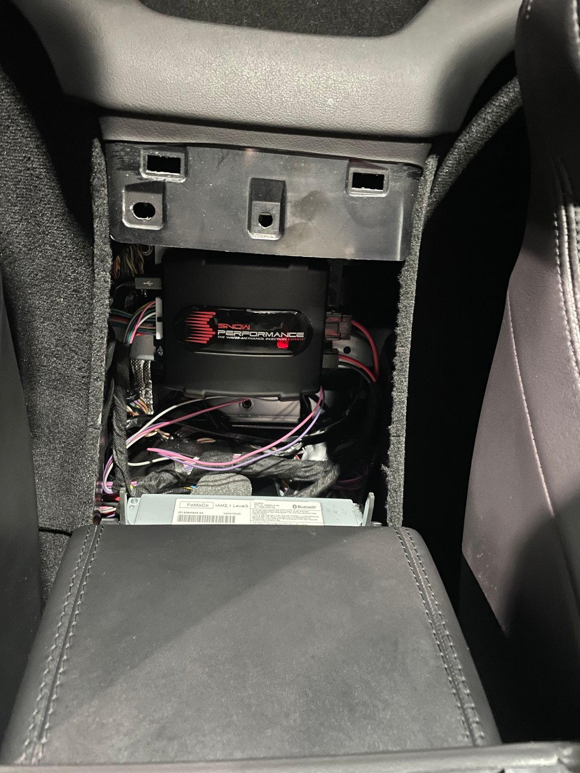

After that it’s probably an intercooler upgrade OR a water meth injection system ($600-1000), oil catch can ($100) If you haven’t checked out TheRocks DIY posts…. He is the MAN!!!!

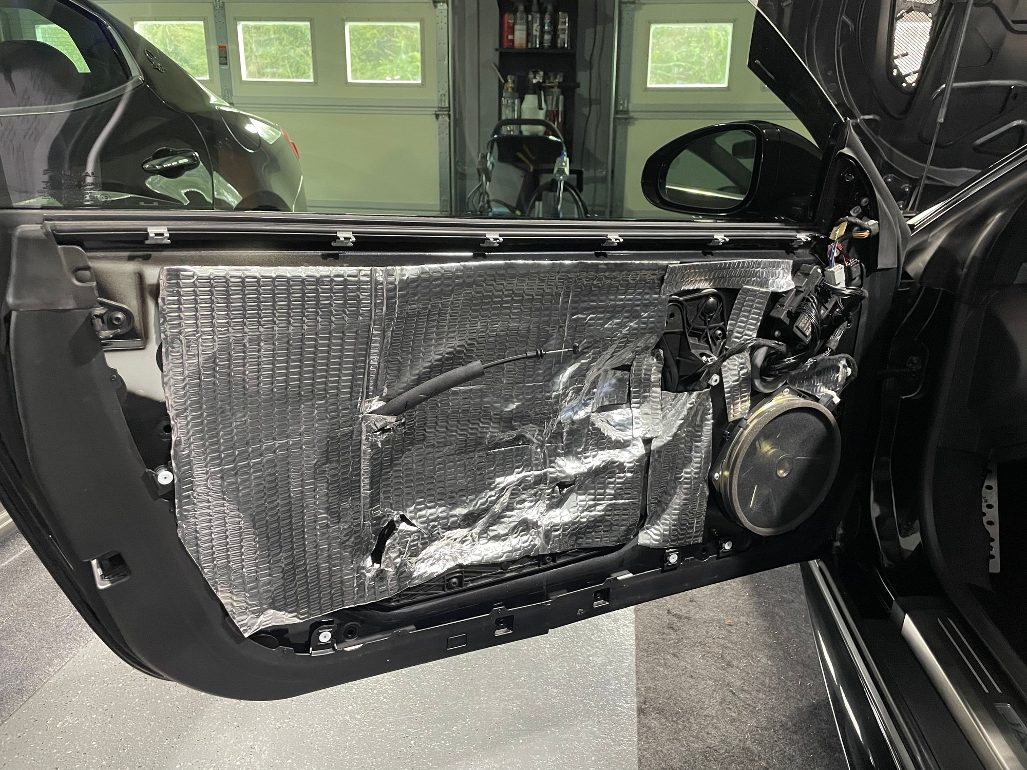

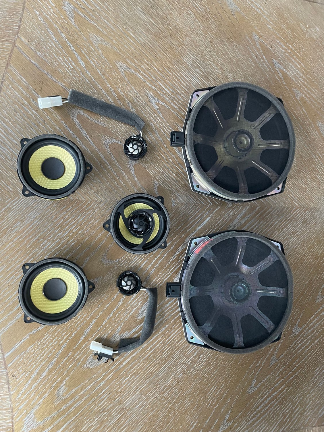

Audio system - despite popular belief, the exhaust isn’t the only sound system on the F-Type😁. If you don’t have CarPlay, check out the UAD add on module. There a number of videos on YouTube on it’s installation. (Thanks you Paul Calvert for your details videos) This is a must have for me…. Waze on the screen is awesome. For your speakers, I would replace them with the JLR Kevlar upgrade speakers for about $600 and dynamat the doors. I used the normal dynamat material on the inside skin of the outer shell and used a foam dynamat material (much lighter to keep the weight down) on the other 3 sides of the door. This will dramatically improve your sound system. Bass is tight and much cleaner/less distortion.

WMI controller installed into dead space behind the armrest.

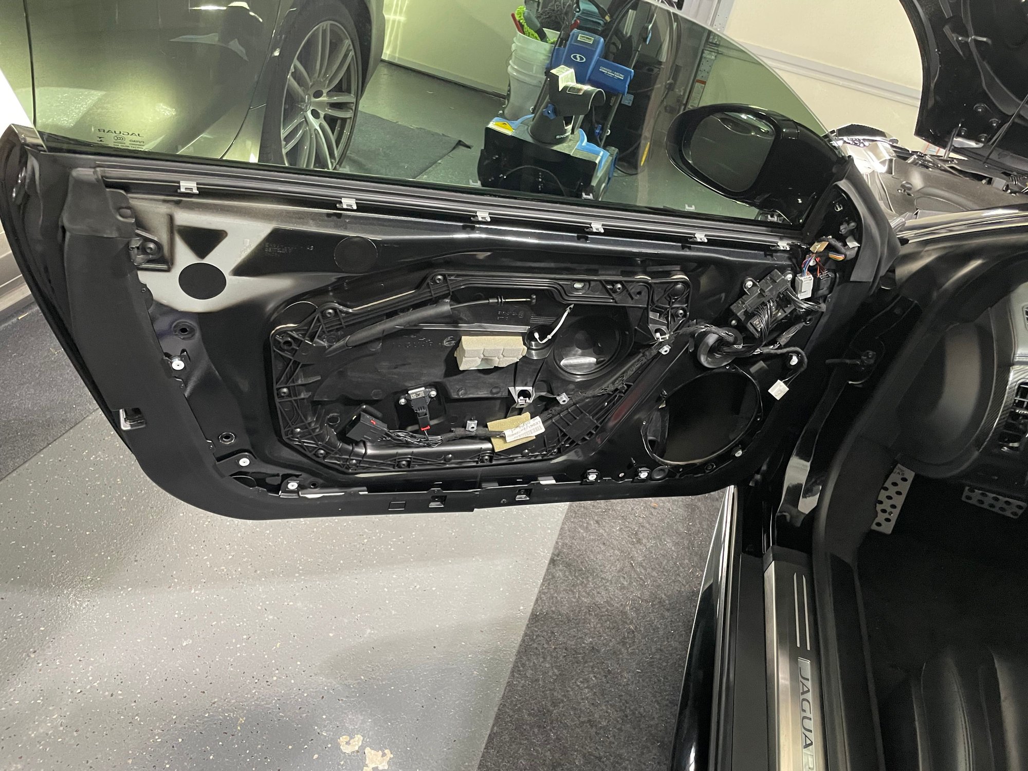

These a huge improvement over the OEM polyprop speakers.

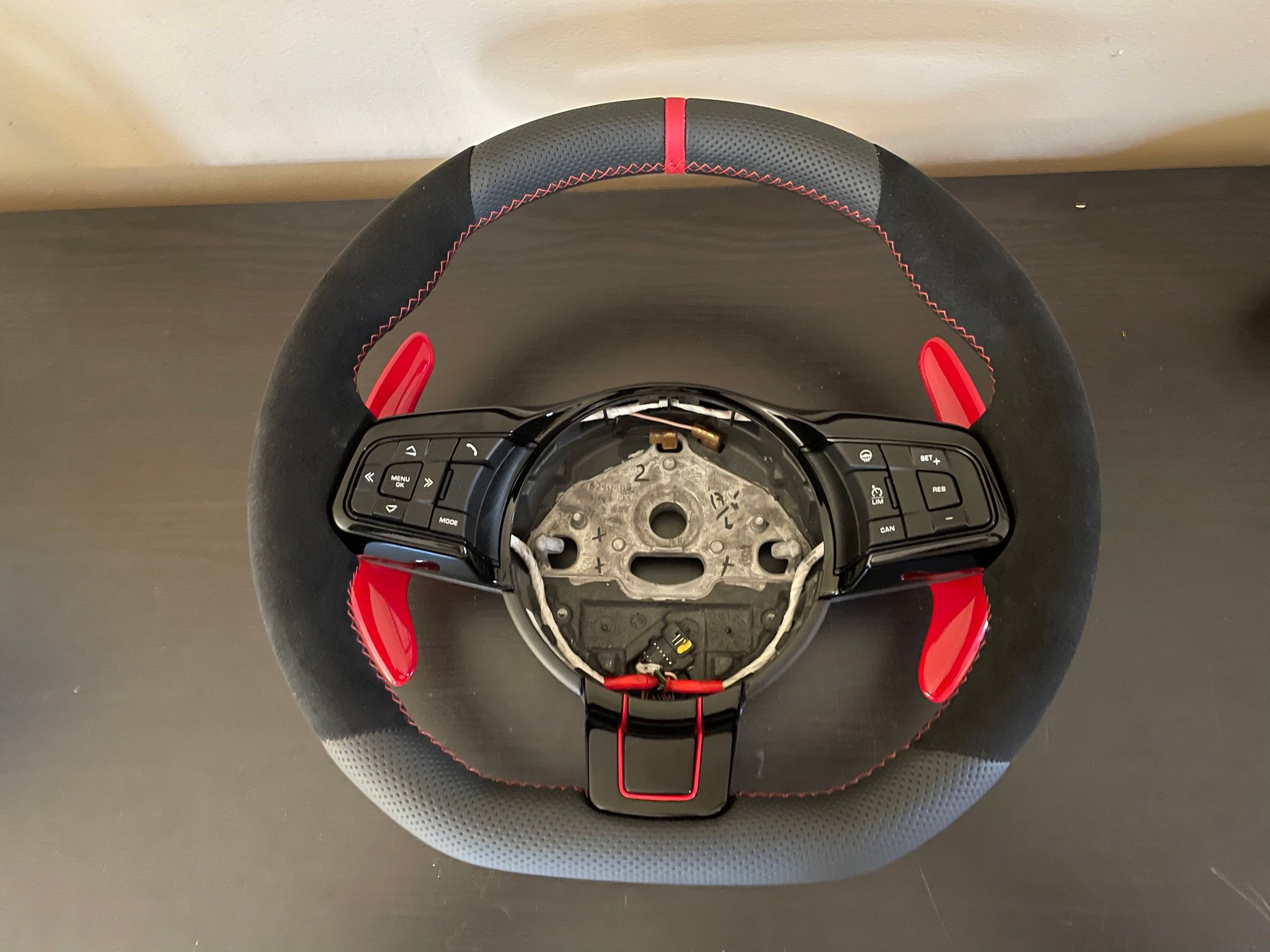

Guardian wheel, heated flat bottom, alcantara sides and perforated leather top and bottom. Extended Ferrari red paddles and accents.

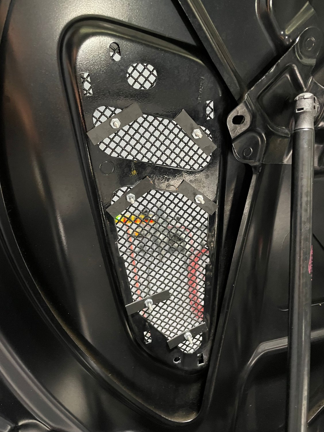

Mina Gallery Hood vents view from the backside. After replacing them, you’ll notice a ridiculous amount of heat come out from that vent compared to before.

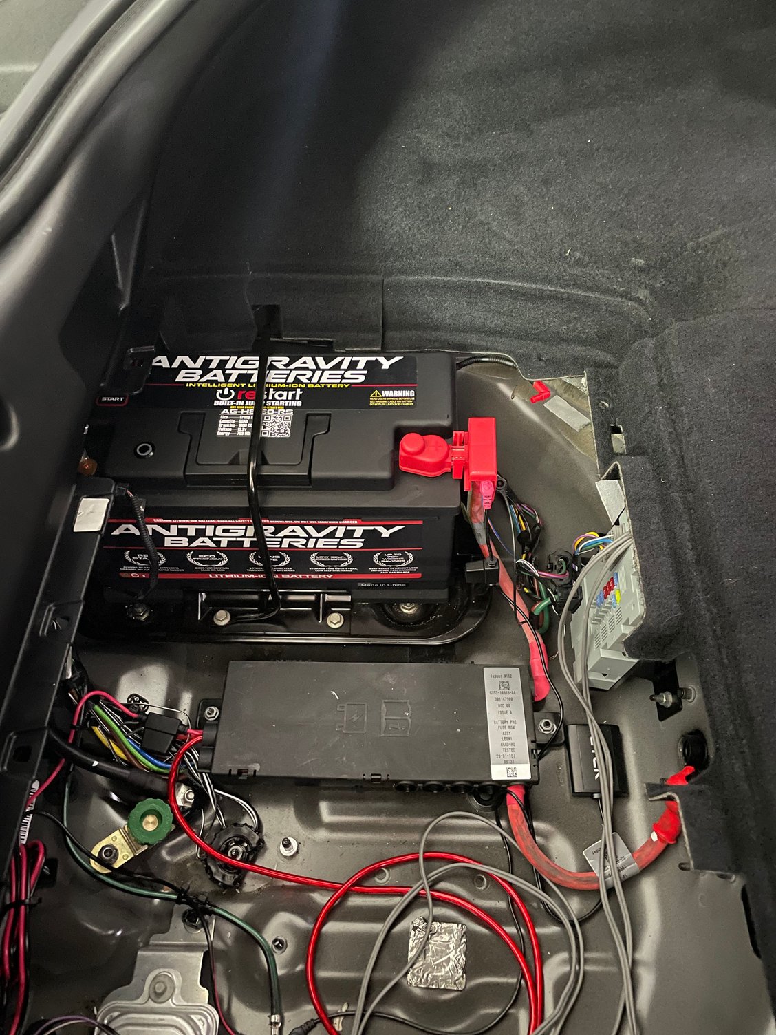

Antigravity lithium battery- built in remote jumpstart (has come in handy a few times) and it’s about 40 lbs lighter than the OEM.

that looks great!

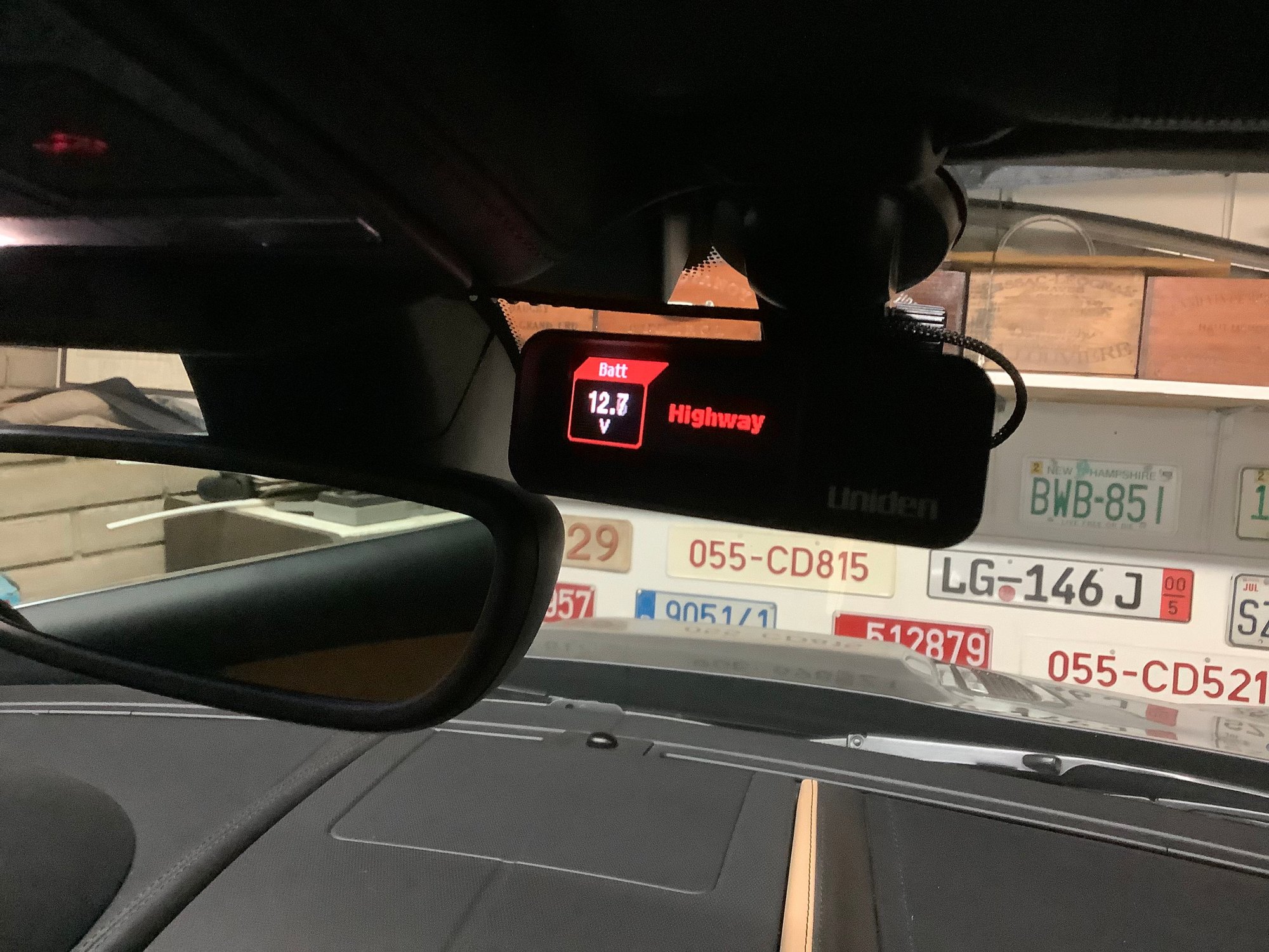

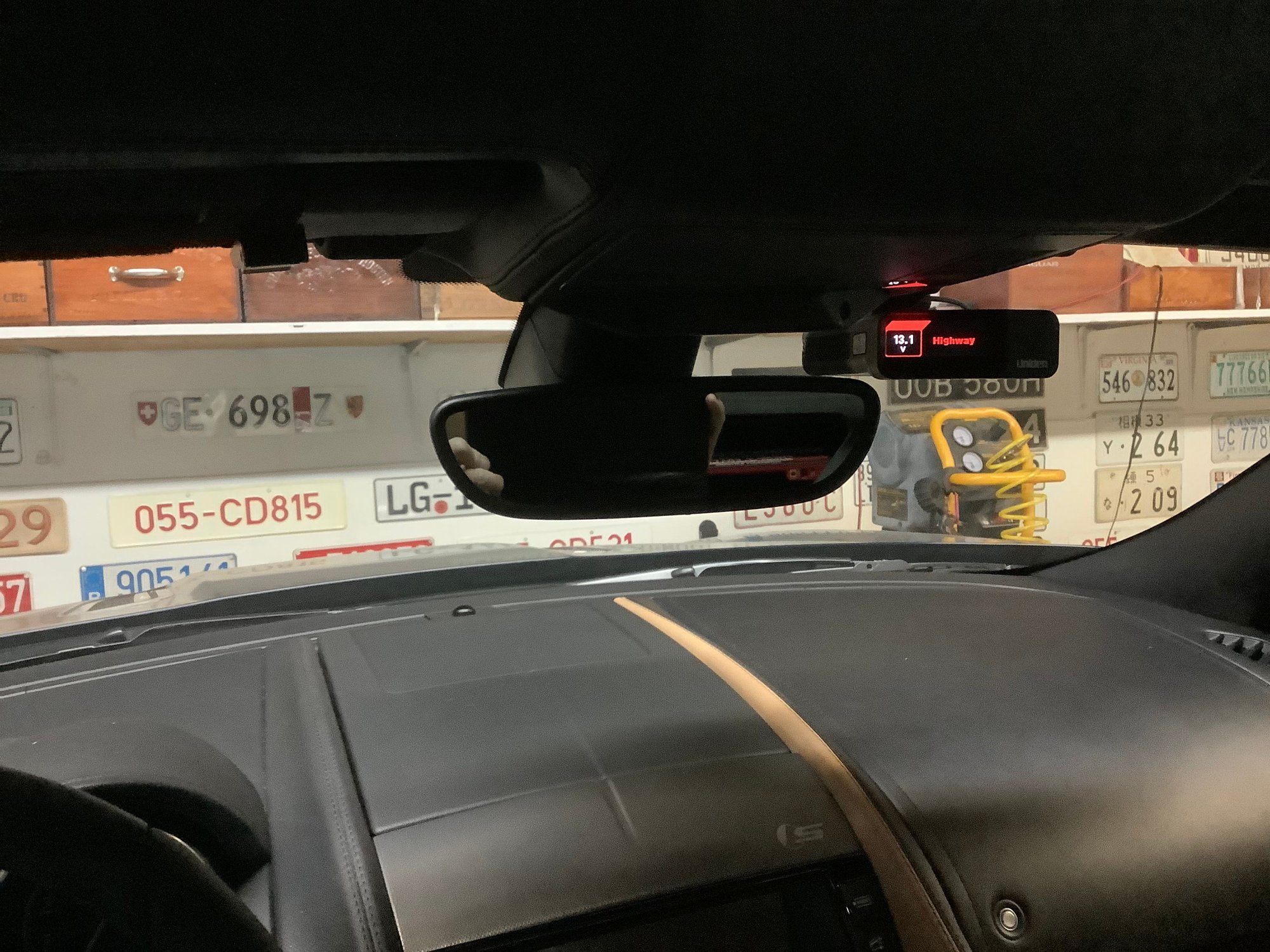

Next update. This time I hard wired my radar detector (R7) to the top lamp housing. When using the Blend Mount and lighter socket the detector was just below the mirror and what with the detector and power wire my view was somewhat obstructed. Ergo, the detector is now up to the right of the mirror out of the way and the R7 display angles to the left so it's very easy to see. The power wire is tucked away nicely. The hard wiring was a bear. Fortunately I had a good friend helping me and we managed to find suitable connections and once that was done it was easy.

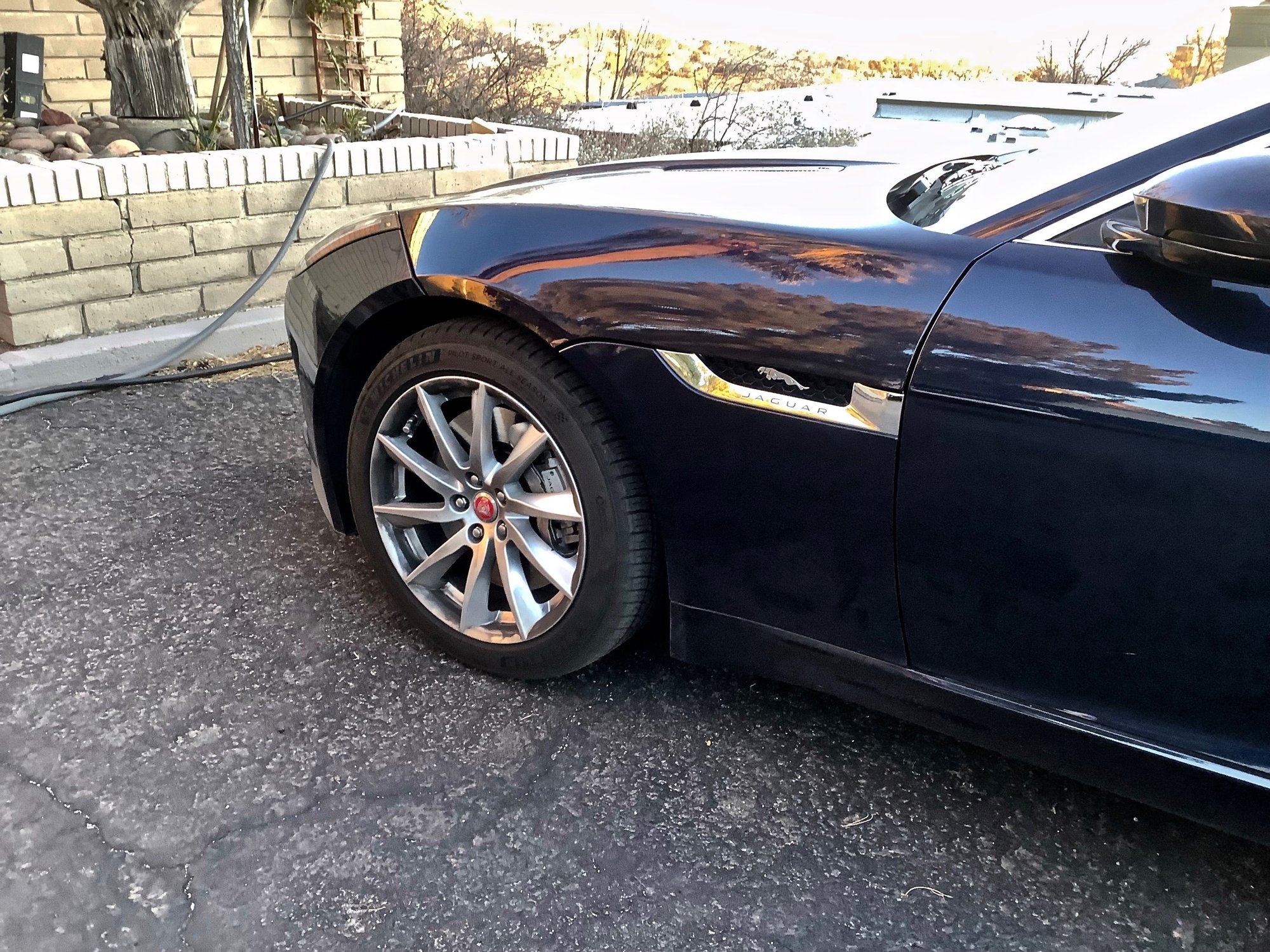

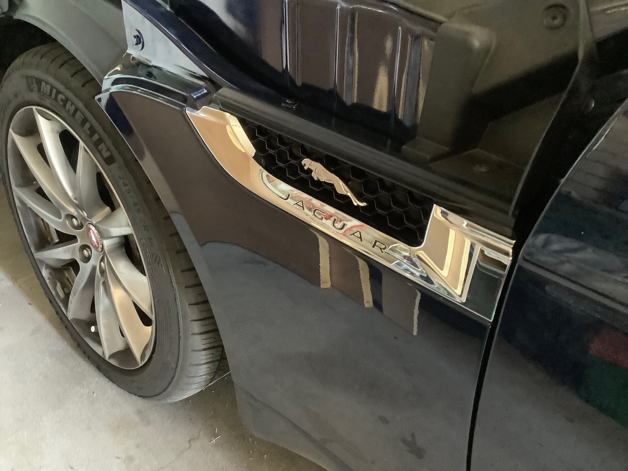

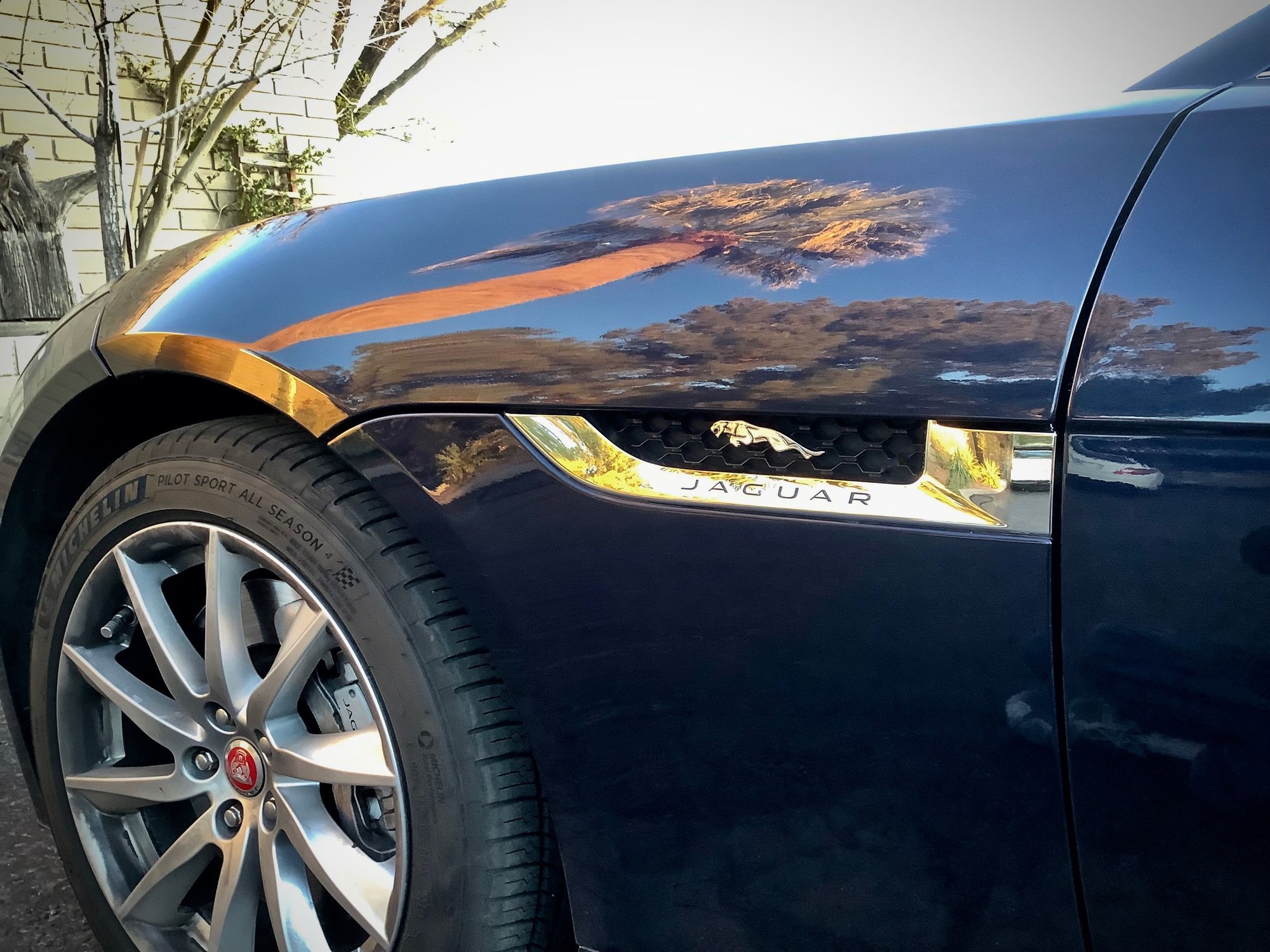

Default Onto the Next Mod
Inserted onto the side air-vents are original Jaguar XJ-6 metal emblems.... I don't think they are too big and they set off the all black grill. I thought I would try them out but the more I see them the more I like them.
They look good!
Might I suggest you also pick out the Jaguar lettering in black or red paint?
I have done that on all of my Jags and IMHO it looks great.
Very easy to do with some suitable paint (I use caliper paint) a small brush some turps and some MF cloths.

It might be difficult to see in my photos but if you look closely you should be able to see that the Jaguar lettering is already painted black...... otherwise, one is barely able to make out the lettering from afar.

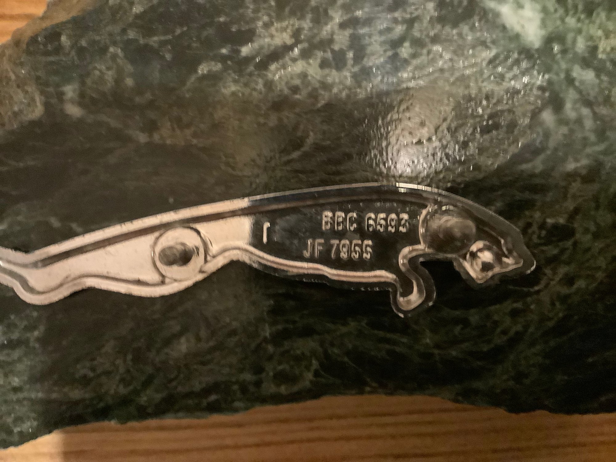

Do you have a part number or a website link for these? Just want to make sure I find the same ones you have... hints for attaching? thank you.

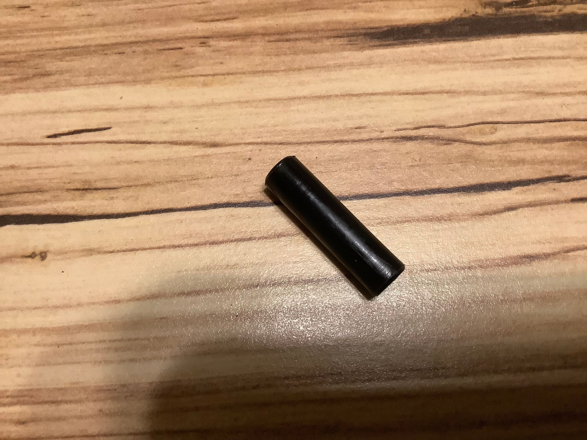

I am not sure if you can order these from a dealer. However, here is a picture of the underside which has the part numbers on them. I just went on a hunt on EBay
and was able to get several. As far as attachment goes, the emblem has two prongs and I took a plastic piece, drilled a hole in it so the prongs fit super tight without any glue. Then I glued and clamped the plastic piece to the rear of the vent which is just flat plastic with JB Weld. Once dry, you just insert the emblem into the plastic pieces and voilà, you are done. Just stop on by and I will do it for you......
Now, just so you know, the emblems face the same way. That means that the jaguar's head faces forward on the left side and rearward on the right side. Still looks good to me but there was nothing I could do about that. I wanted original metal emblems, not plastic, and this was the only solution in the proper size I could find. You might be luckier......

Missed it the first time but now if I look really really hard and squint just right I can see it!
