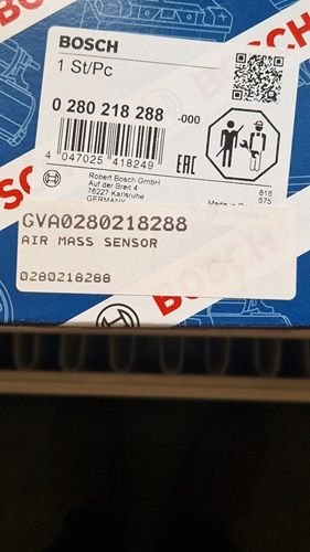

@Zen Beer Like you I went for V8 MAF version of VAP intake on my V6 R-Dynamic. Pipework is the same, only the silicon reducer coupling is different to cater for the larger diameter V8 MAF. I was worried it would throw a fault when I fitted the V8 MAFs, but everything went OK. I already had Mina Gallery fitted previously, so it was a relatively easy install once the wheel arch liners were removed. The V8 MAFs are considerably larger than the V6 originals, so will remove any restriction and allow the VAP intake to flow at full capacity. Top tip, don't go purchasing the V8 MAFs from Jaguar (CPLA12B579BA), much more cost effective to buy the Bosch component (which Jaguar use anyway). The Bosch number is 0280 218 288.

Thanks for that, was wondering about the MAF's without the stage 4 tune. If it throws codes or mixture out of trim will put back on the v6 MAF's for the time being till I get the rest of the upgrades purchased.

You cannot fit V8 MAFs to a V6 without a commensurate tune.
