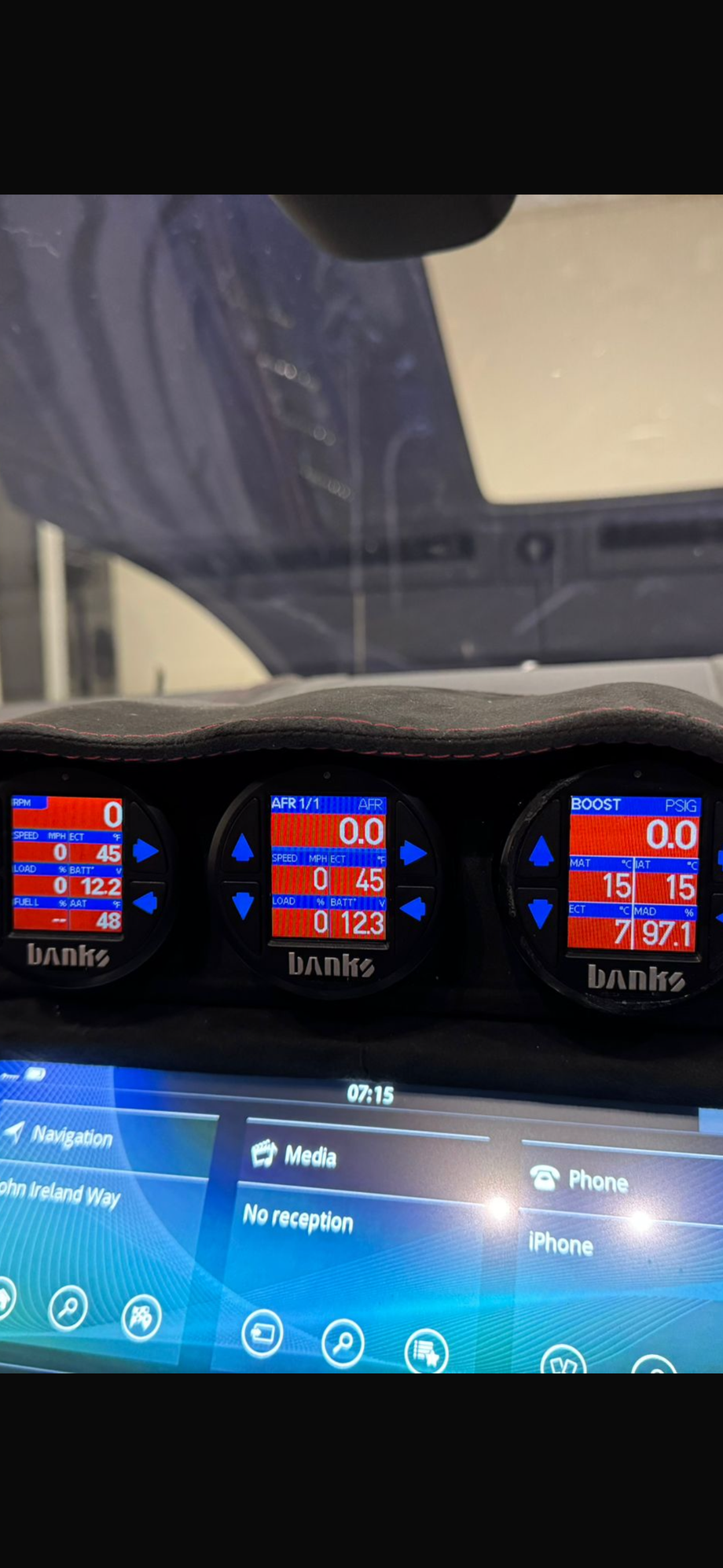

My current fi interchiller set up I have recorded fluid temps as low as -11c pre chargecooler and -9 post chargecooler
i have Banks sensors on my chargecooler flow and return pipework

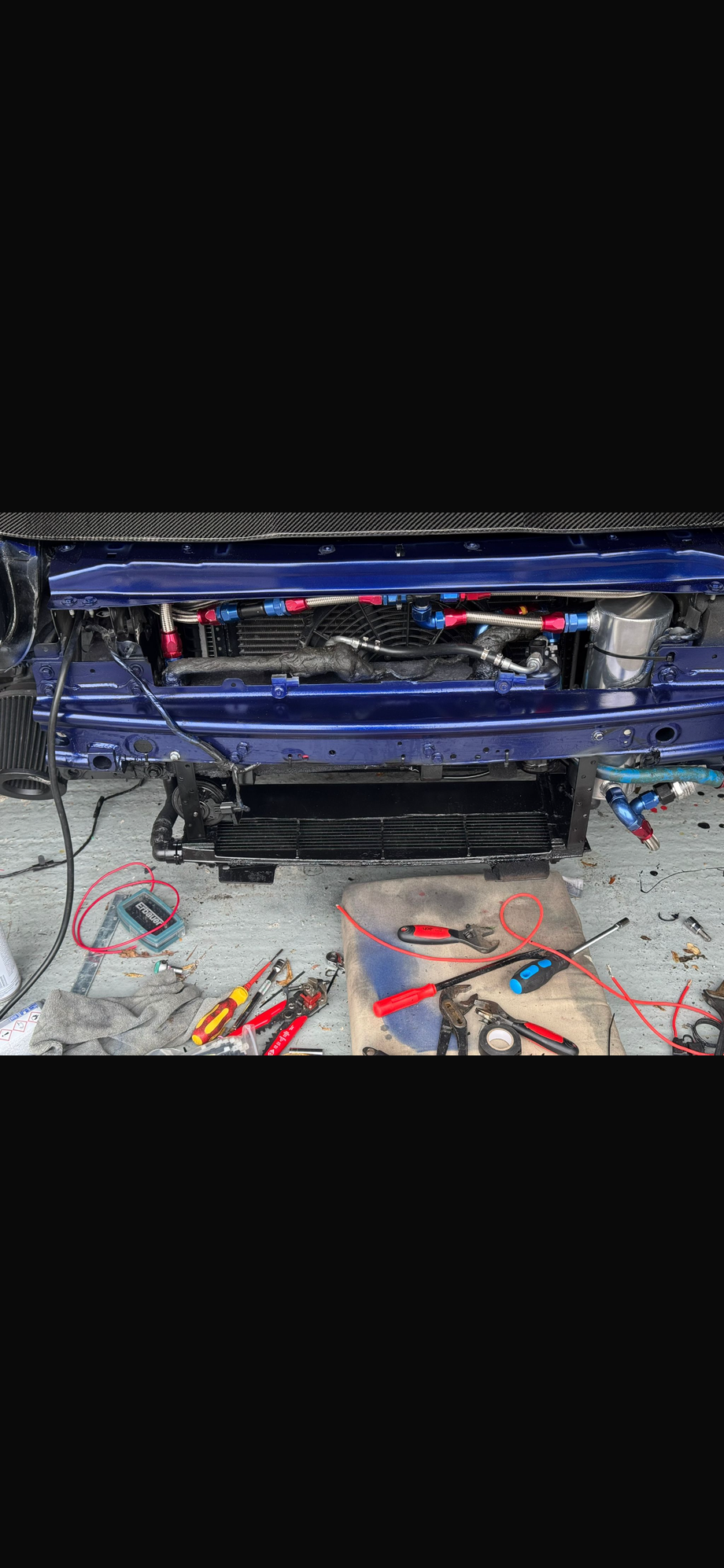

I scrapped my intercooler and went for the universal kit plus stage 2 and added the cwa400 pump and had a reservoir made
i also replaced/rerouted the flow and return lines and separated my system from the engine coolant and had a fill and vent tank made as well
since this picture I have spun the interchiller 180deg
much better for routing the pipes
u can’t do stage 2 if u are keeping your intercooler as there isn’t enough space

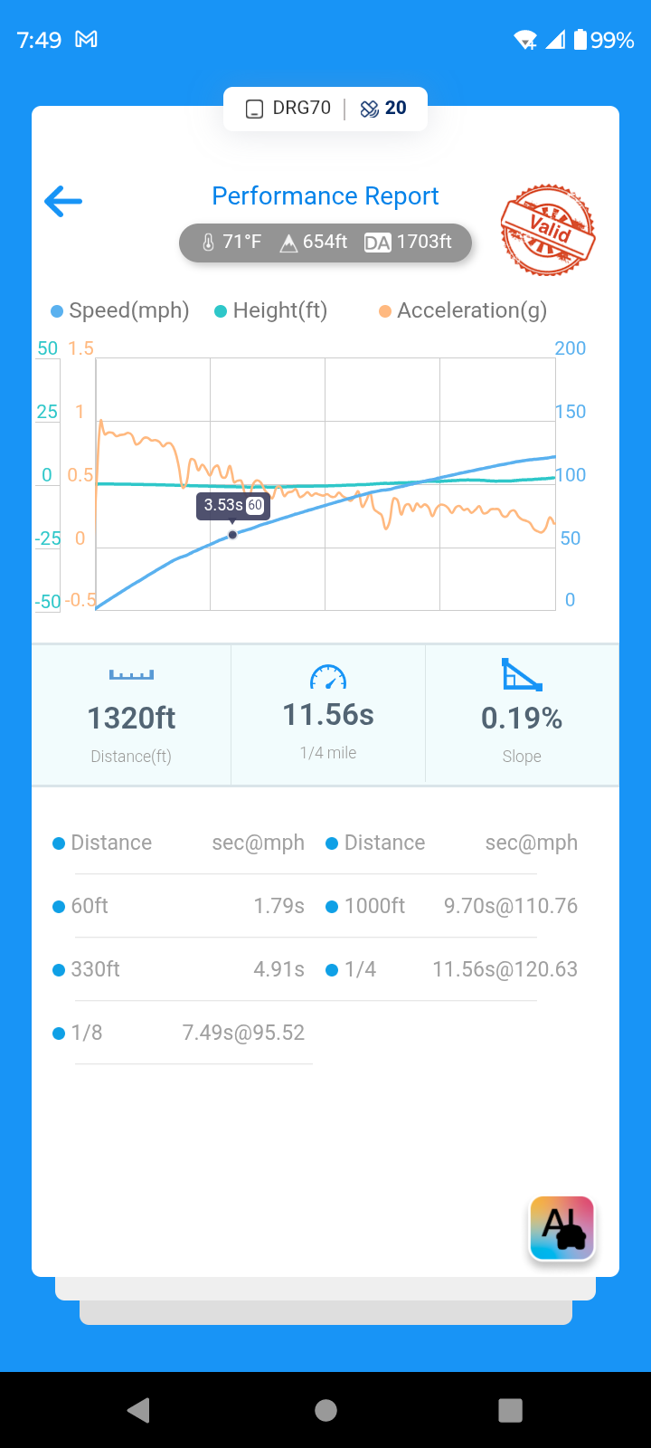

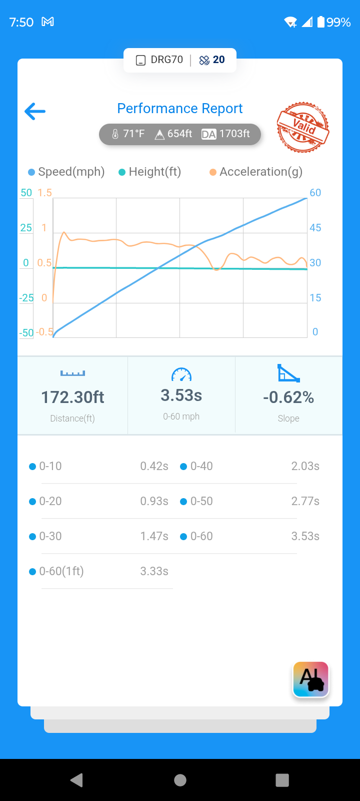

Since I'm in the process of doing dual pulleys, I'll post the "pre" data.
2017 F-Type R w/ new Pilot Sport 4S tires, on unprepared concrete road surface. Unfortunately, I don't know the fuel load, but the driver would have added about 210lbs. Hopefully, I will be able to do a run in the same location, post pulleys. Note that I will not be going to the TVS2300, at least not any time soon. Honestly the stock power is plenty for what I do with the car. The pulleys and tune are pretty simple "just cause" upgrades. Were I to jump to the TVS2300, it would be the end of the car as a daily driver and the start of its life as a dedicated race car.

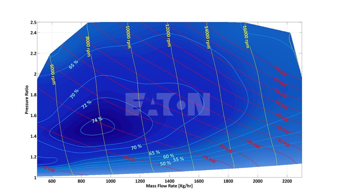

I’ll leave the exhaust part alone, but here is the map. Two key observations:
  1. The efficiency islands are wide rather than tall.
  2. The red dashed lines (sc power consumption) slope down and to the right
In summary the pressure limit is a harder limit that rpm. Boosted Slickety Rickety is correct
