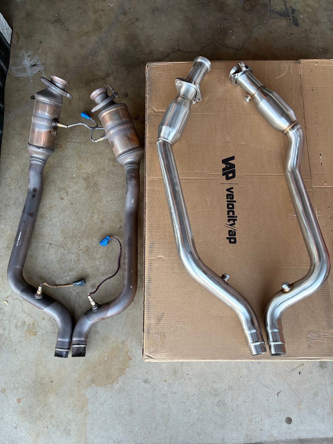

This is my first post on these forums. Im new to this platform, but I’ve been working on and modifying cars my entire adult life. I just installed these on my 2016 R AWD.
Pro’s - High quality, perfect fit, great welds, easy install. Previous owner already had a VAP tune on the car and VAP provided me with an update tune free of charge. Excellent customer service from VAP. These are loud in dynamic mode. The pops and bangs are completely childish, but I love it when I’m in the mood. In normal mode, it sounds like stock.
Con’s - Tariffs if you’re in the States. These will cost an additional 26% between shipping and tariffs. Didn’t know until the email/bill came from UPS when the package hit the border. Just something to consider. These will throw a P0420/0430 code and you will need the tune to get rid of it. That’s an additional cost, but VAP’s tune seems very good and well worth it.
If you’re planning on tuning your car anyway, may as well do the lower pulley and downpipes all at once.

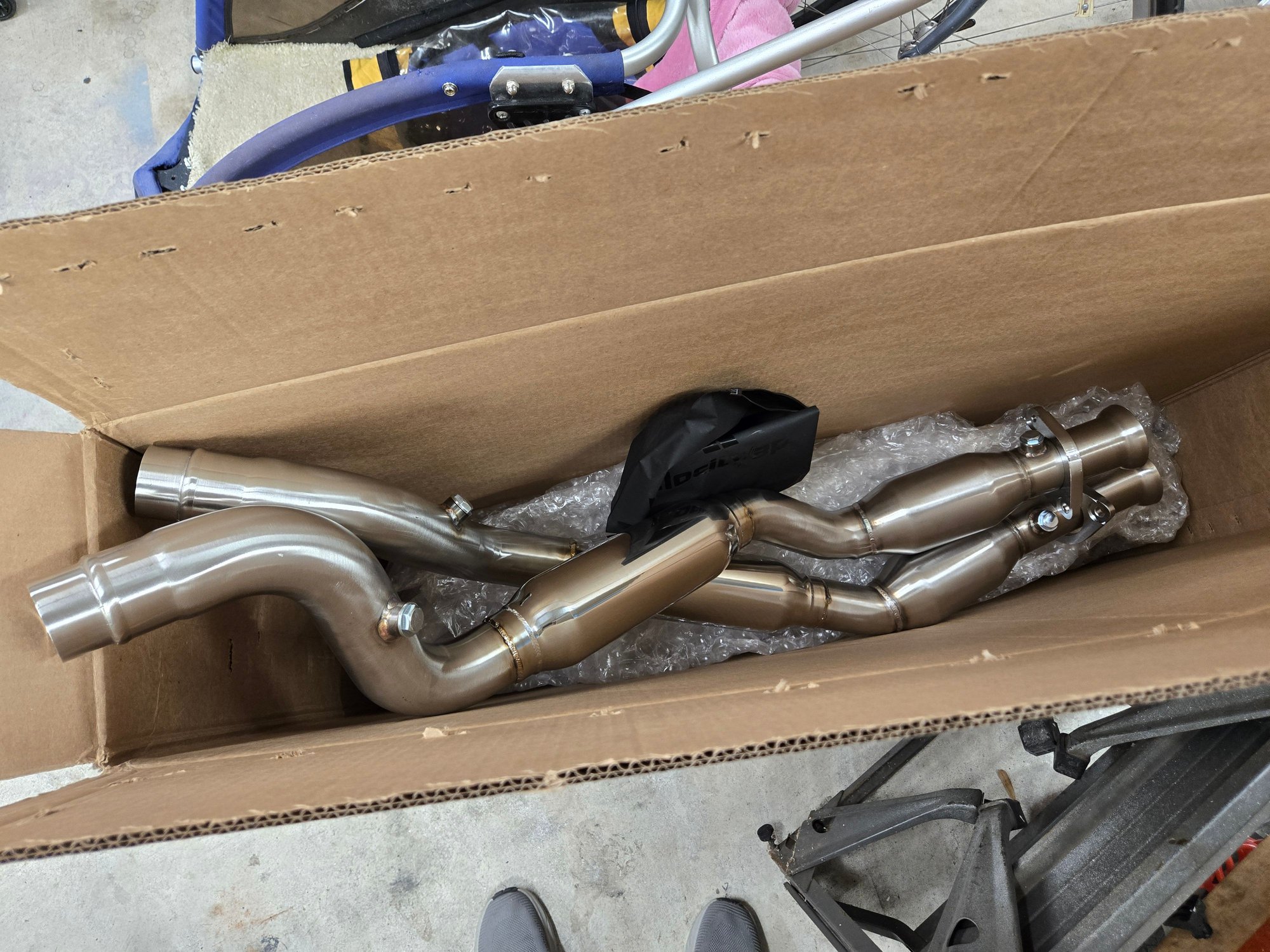

I'm also in Texas, and I'm not concerned about passing emissions. My current cats have been throwing codes due to the typical melting issue, and I've passed emissions by just taking it in for inspection when the CEL isn't on (it's an intermittent thing). I'm sure with the VAP tune there won't be a CEL, so unless you're in a state that does a sniff test I don't think there's anything to worry about.
When I ordered mine it took a while to ship, and it said something in the email about them being manufactured on demand. So I assume someone at VAP is welding them up. The issue may be that the catalyst is imported from China or whatever, so it doesn't count as "made in Canada". According to the always infallible Google AI "if the exhaust pipes meet the CUSMA/USMCA rules of origin (meaning they use a certain percentage of North American content and high-wage labor), they can be imported into the U.S. duty-free". Only VAP can really answer that question though. At this point I'm just assuming I have to take the L on the tariffs, but if not that would be nice.
I ordered mine with resonators, so they look a little different from the previously posted ones. I know there were originally some complaints about raspyness, and the resonators are supposed to help.

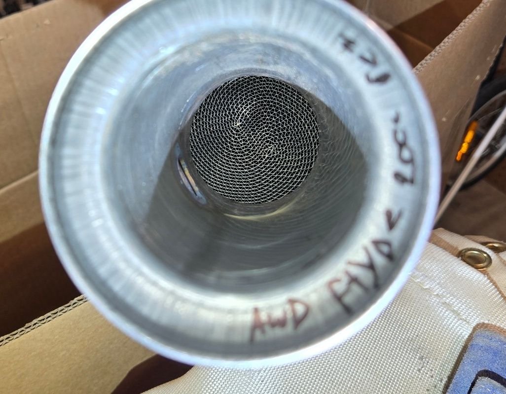

Oh, and since you were asking about what's inside, I went out and took a pic. I've had my stock pipes off and looked at the cat, and it was definitely much finer than this. Also, it was more of a uniform grid, while this is kind of a swirl.

Judging from this pic those VAP cats use a metal substrate (and the VAP web site says they are metal) and I'm fairly sure the OEM cats use a ceramic substrate.
AFAIK ceramic substrate is prone to crumble/fall apart and hence fail a lot more often than metal substrate, that is if metal substrate falls apart at all.
Also the OEM cats are double-brick and at least 600 cell (cell count = cells per square inch of cross-section) so way more restrictive than the VAP 200 CPI ones.

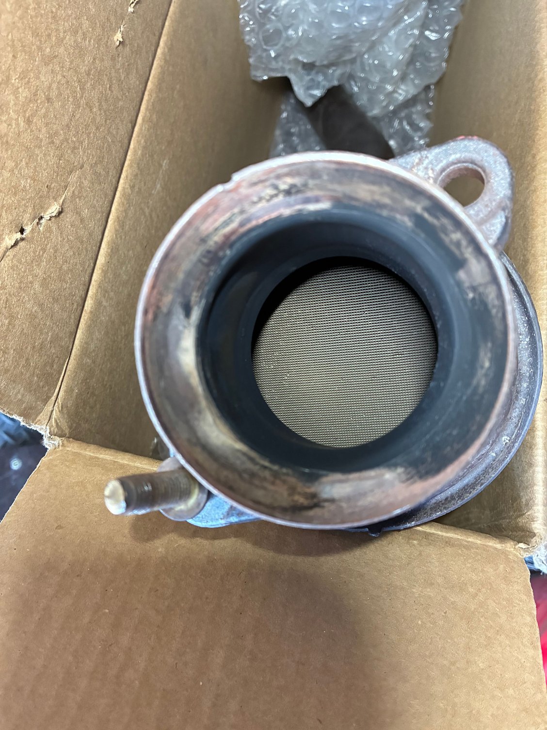

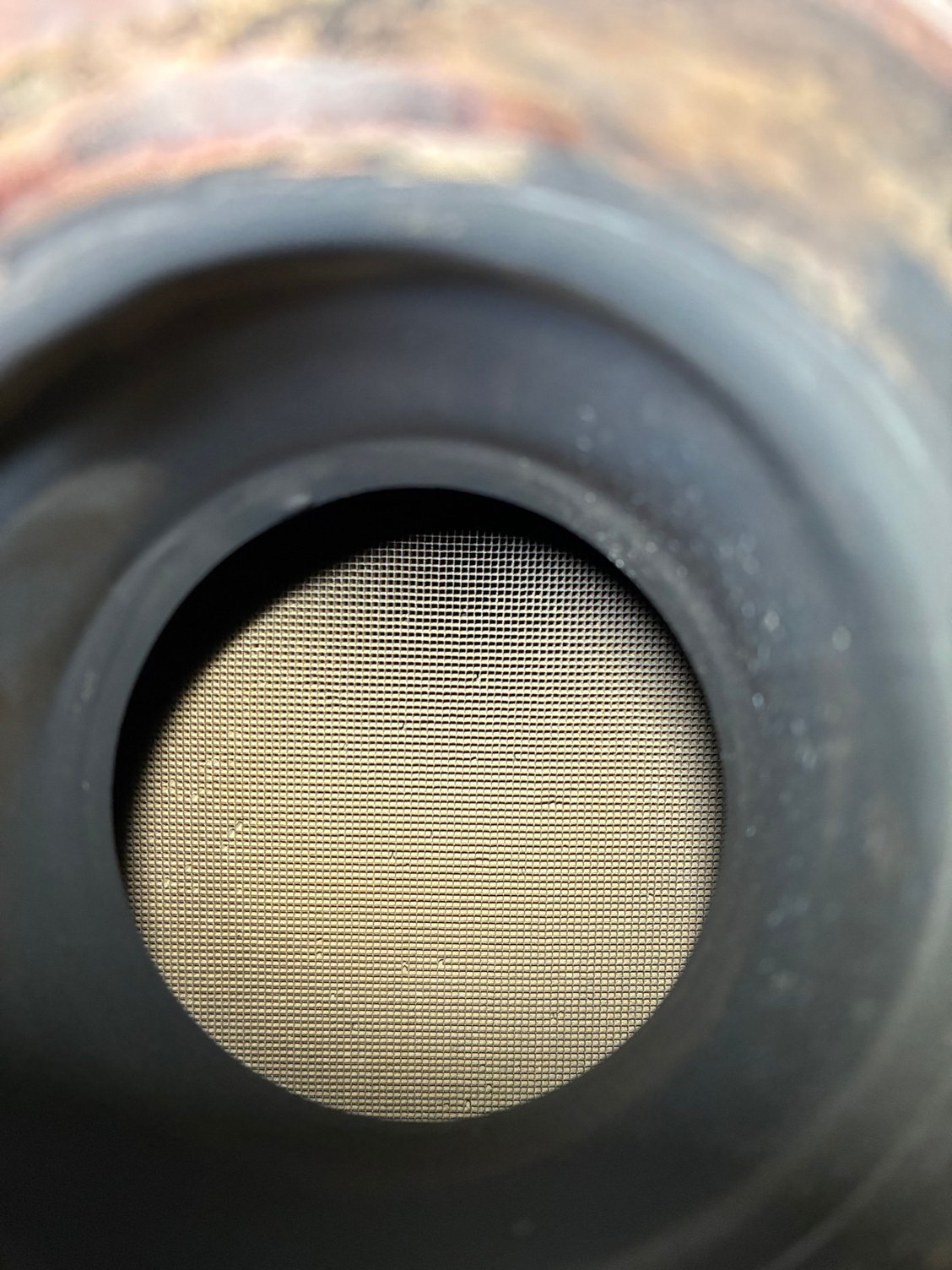

Stock cat substrate for reference:
I replaced the downpipes for a few reasons - but getting more hp was not one of them. I’ve had supercharged/turbo charged cars in the past, and EGT’s are huge when it comes to overall performance and longevity of an engine. From what I have read and experienced (P0420 codes for failing cats at 33,000 miles !?!?!?) with this platform in the short time I’ve owned it, heat management is something needing to be addressed even from the factory. I also live in AZ where ambient temps are regularly over 100 for months at a time. These downpipes, replacing plastic cooling pipes, a larger charge cooler, maybe a killer chiller, possibly meth injection (cooling only, not tuned for performance on it) are on the list of things I’m doing / considering to keep this car healthy and happy.
