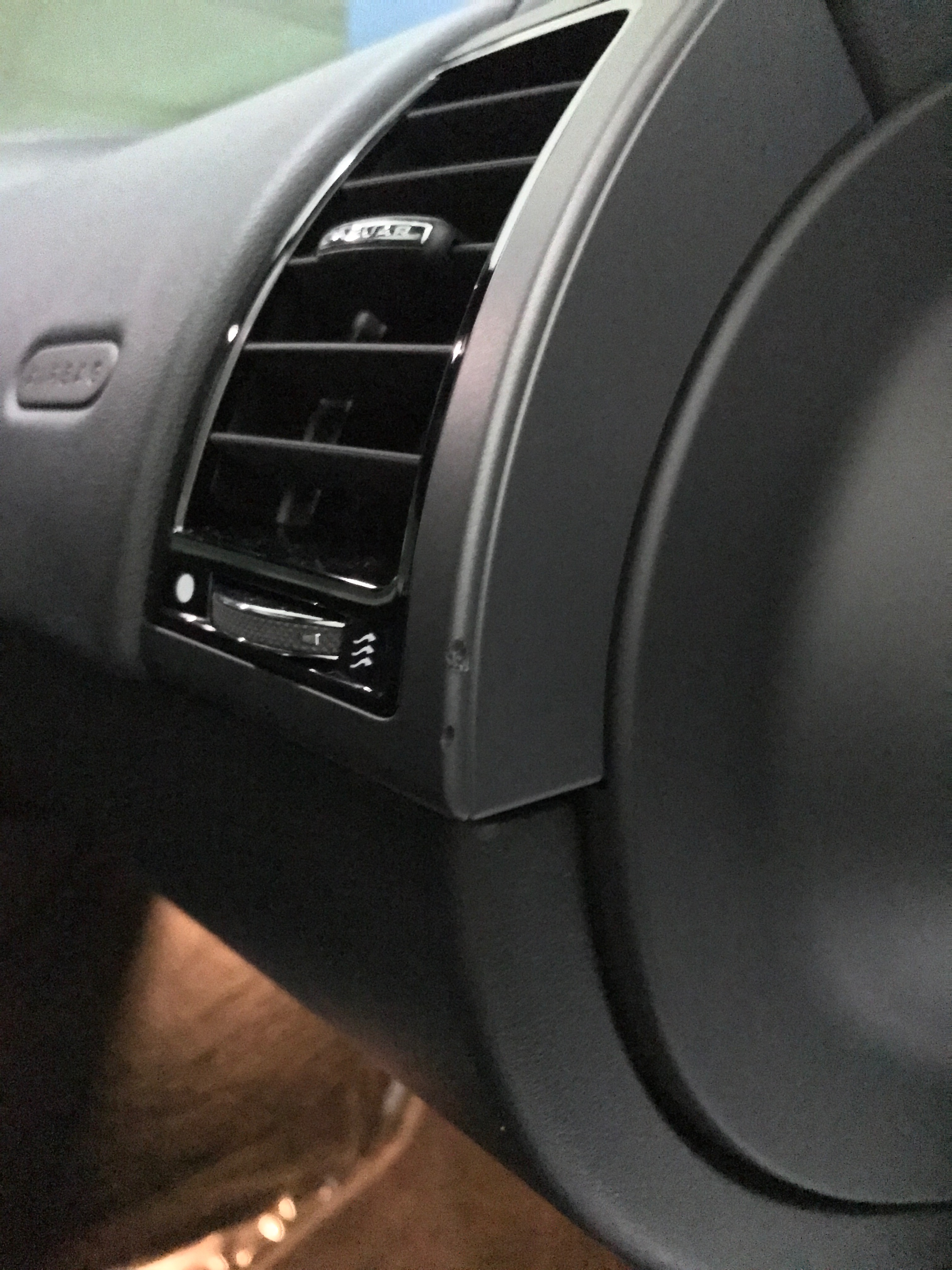

Is it easy to reinstall a new vent grille on passenger side ?
When I bought this car 2 months ago, there was a scratch mark on the vent grille. And the dealer promise me to replace a new one for me. (part is not arrive yet). Should I just leave it ? Or should I take a risk for the dealer to reinstall a new vent ? I don't have trust for the mechanic here. Anyone here knows the procedure of uninstall the vent out from the dash...?

It requires removal of the glovebox; there are two screws under the vent that are hidden by the glove box.
