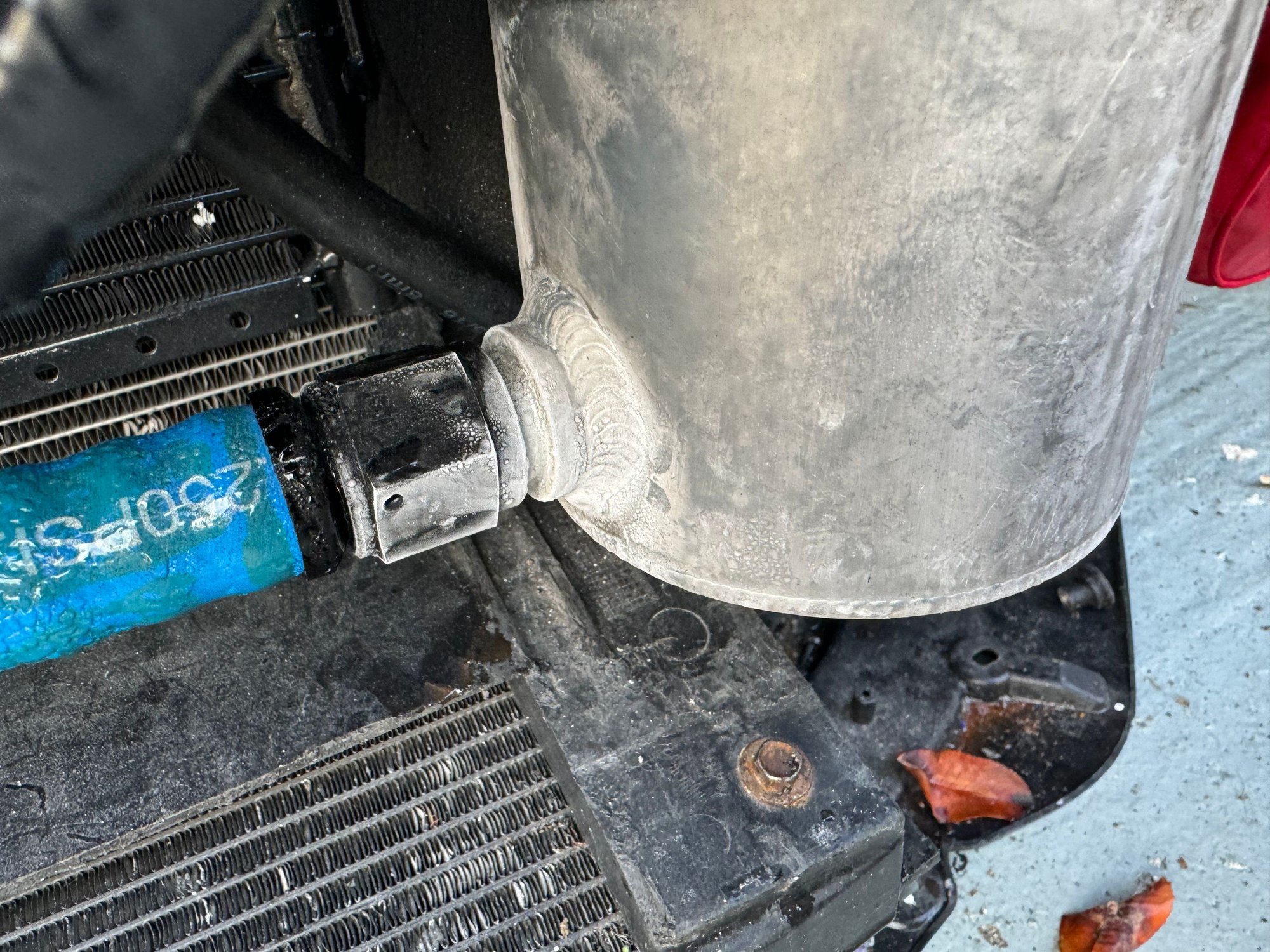

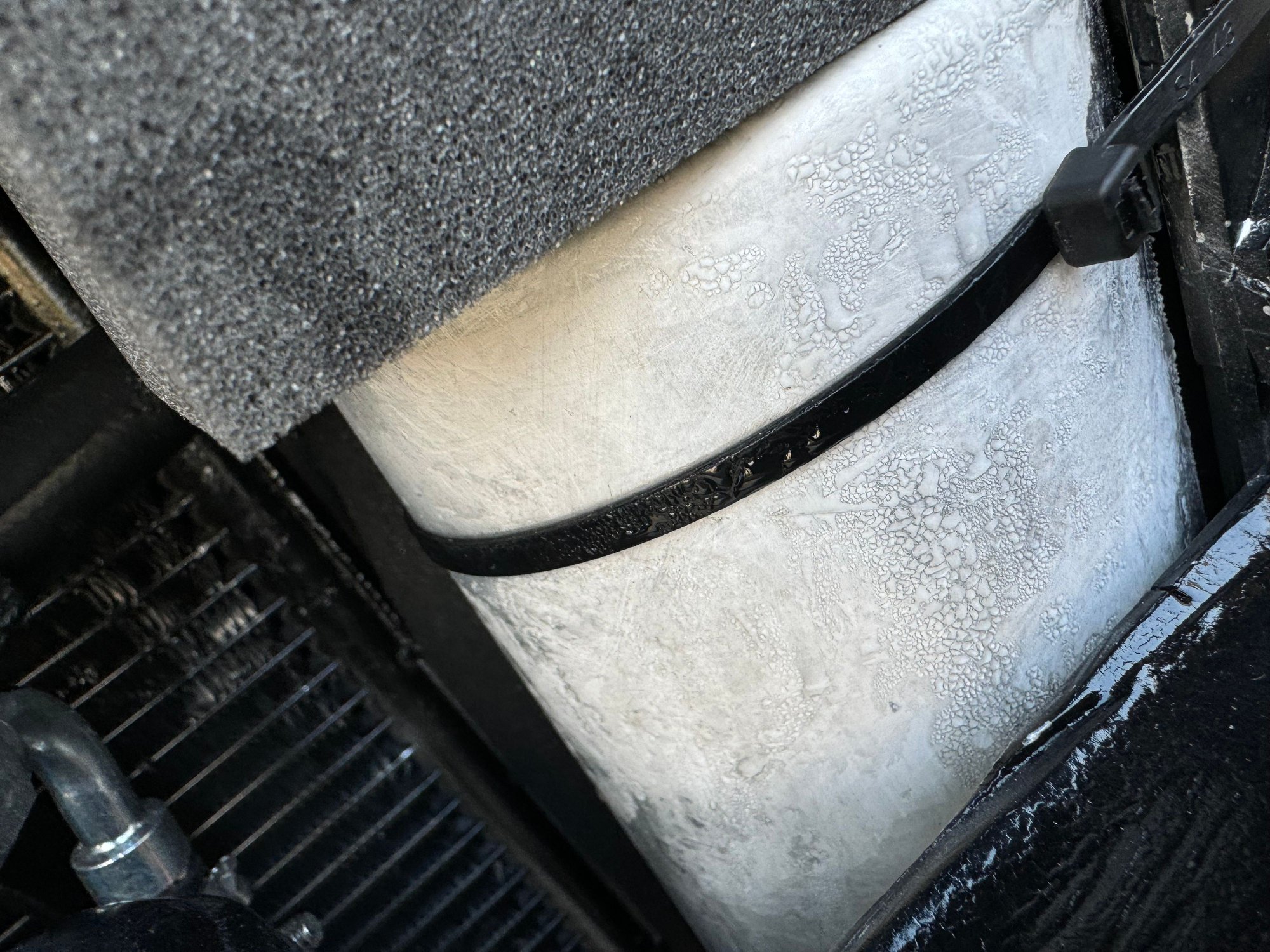

The predator 2 package follows a similar route of pulleys/cold air intake/exhaust/
the game changer is the addition of a chiller for the chargecooler water which allows changes to the iat tables to run more timing
they have reached 725bhp and 1000nm torque but egt are a issue so this has been dialed back a bit
at present they are testing the tvs2300 to see what this will yield
i myself have installed the fi interchiller stage 2 kit and my intake temps have plummeted
however I haven’t had mapping done yet
this is my water reservoir and yes that is ice you can see
i am also running a cwa400 pump which is a monster
