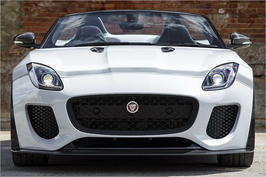

View Poll Results: Which grille do you prefer - standard with bar or P7 with no bar?
I prefer the factory grille with the bar
16.09%
I'd upgrade to the P7 style grille with NO bar if I could
83.91%
Voters: 87. You may not vote on this poll
Vote: Front Grille Bar

Hmm. I like the P7 a lot. I love the D Type hump/s a LOT and dream of having something like that, someday. I like the mouth too.
Question: Why is the bar there on our cars?
I sort of like things "being what they are". I don't like ceramic tile mimicking wood. I don't like a finish that is plastic trying to look like metal. I am fine with my car being what it is.
I made a joke that I bought the base, but I liked the orange button, and my sales guy was like "we'll throw one on there for you". I was like "no no"... but I brought that up in another thread... people badging their cars differently, etc. I guess no one would ever in a million years mistake ours for a Project 7.
Maybe this isn't the same thing, and it's just a fun aesthetic mod per owner's preference. Yes, that's far more likely. I am glad I have settled that with myself, and am now unanimous.
I think I'm trying to talk myself out of spending more money on my car. But I'm also going through a renovation and move out, so ambivalence and wavering is now a skill.

The P7 grill surround is white or grey to match the P7 stripes. I too originally ordered the white for my Polaris white car but ended up with the grey so I'm still deciding what to do with it. I don't like carbon fiber unless it's real so I'm leaning to just getting it painted gloss black (my car has the black pack). My wrapper didn't sound confident about the ability to wrap the surround and have it stay put.....and I was worried about clearances with the additional thickness.
As far as the value of the bar in an impact, I'd suggest it adds very, very little and only at really low speeds.....a non-issue for me.
Glad somebody finally did this. I was 99.9 percent sure it would fit but now it's 100% :-) And dang; does it ever look good!

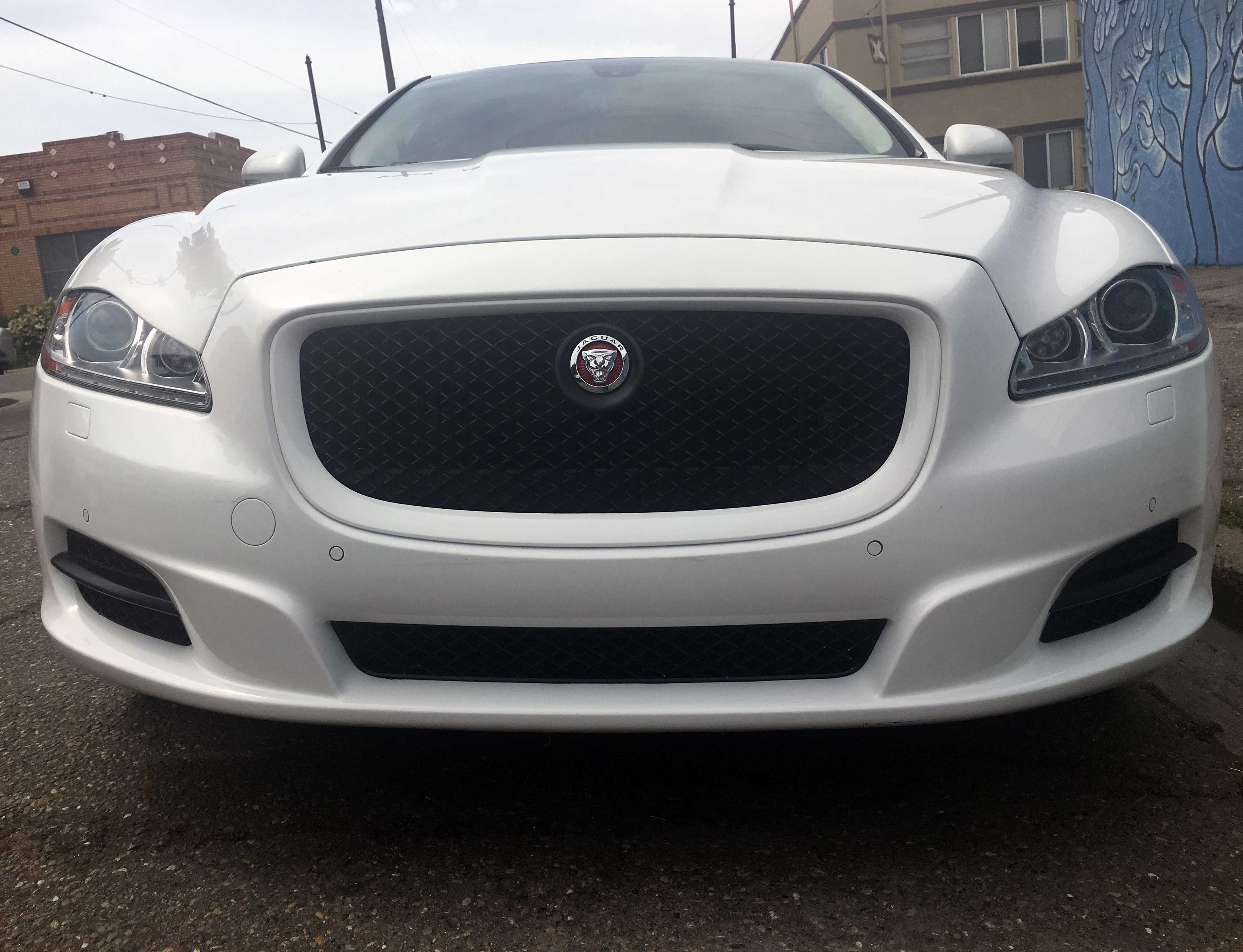

My car didn't have the black pack so my previous surround was chrome. I went to get it wrapped and the wrap guy suggested that I plastidip it instead. The job took him 30 minutes and came out very nice and clean. Looks as if it came factory black and just like wrap, you can easily go back to stock with a peel. This was the correct solution for this particular part because he stated that the wrap will start to peel because of the shape of the surround.
Is the white surround actually polaris white or is it a white other than polaris and thus clashes?

I ordered white and I planned to keep it white. The issue is once the surround is installed theres no removing it without starting over. I'll photoshop the front with a white surround. It's not prominent enough of a part that I'd spend hundreds changing it unless of course it happened to be chrome. I'll take a close up of my plastidipped surround for you so you can see what it will look like. It blends fine with the grill, no glaring difference.
Personally, I feel that having the surround the same color as the car transforms the front from a large mouth bass to a small mouth bass which I think gives you a far better look. Heres an example of how I did the very same thing on my XJ. Both Jags have huge oversized grills, the coded surround tones it down. Judge for yourself.
Of course the surround NEEDS to be polaris, not just any white.
Attached Thumbnails Vote: Front Grille Bar-jag-front.jpg
