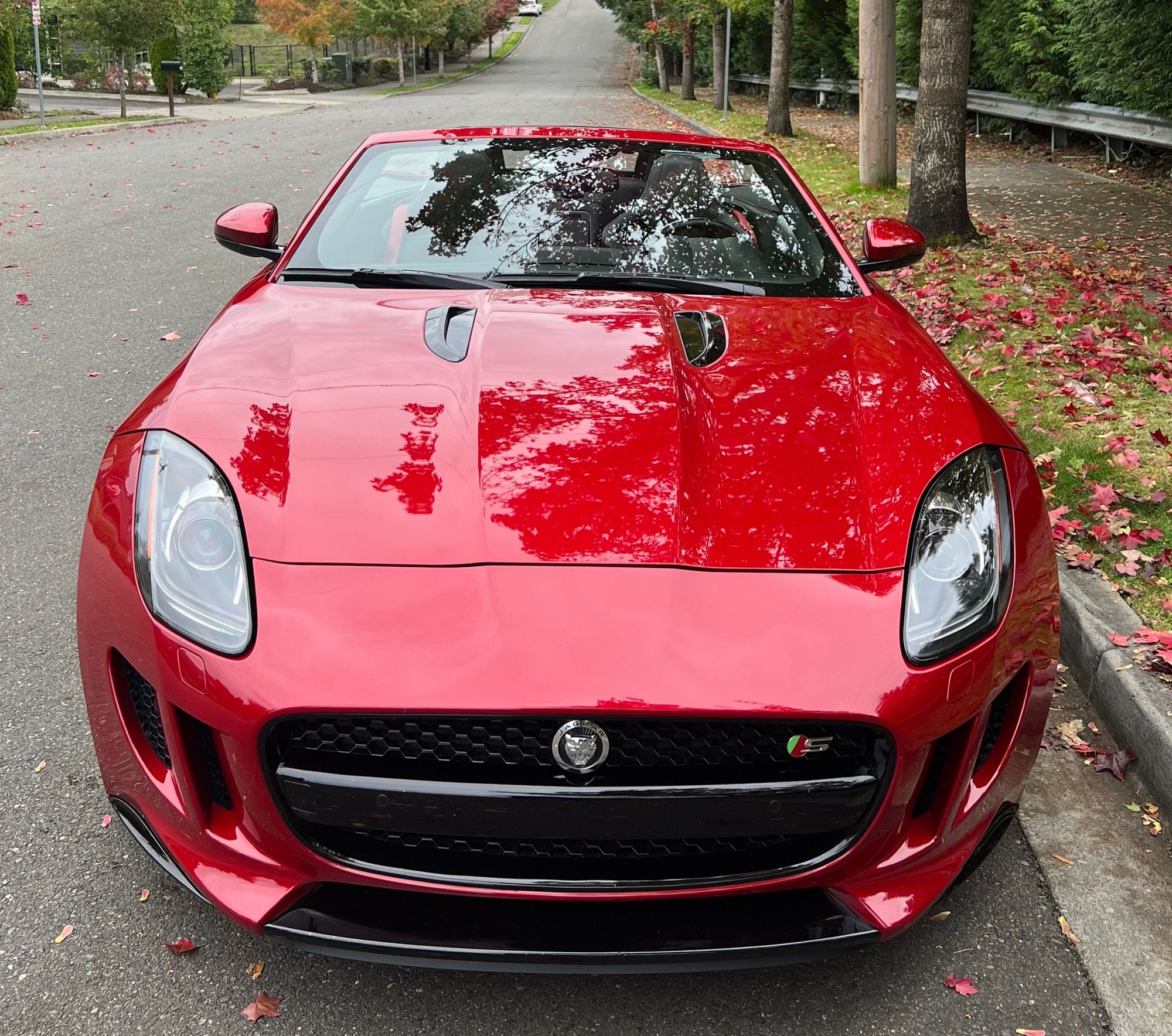

I did PPF on the nose (hood, front fenders, front bumper, headlights) along with the back of the mirrors and the lower rocker below the door. And then ceramic coated the entire car (minus the cloth roof, obvs.)
PPF protects you from rocks, bugs, and tar.
Ceramic gives you the shine back that PPF kind of dulls, and also protects you from UV radiation, pitch, acid rain, bird dirt, and repels quite a bit of dust and sheets away water.
That combo gives you a pretty worry-free car that stays cleaner and stays beautiful longer. Quick detail and microfiber is enough for most cleanups and when you do hand-wash it it's a quick job because of the ceramic coating.
