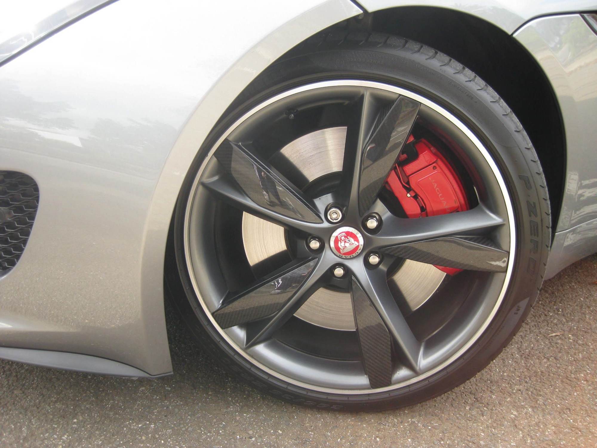

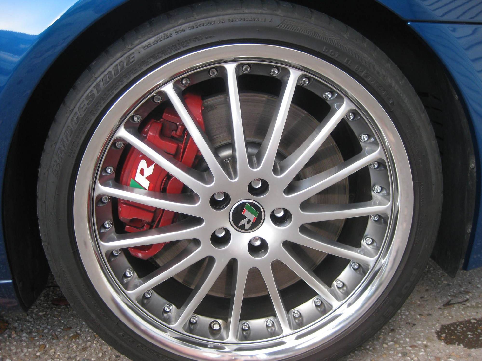

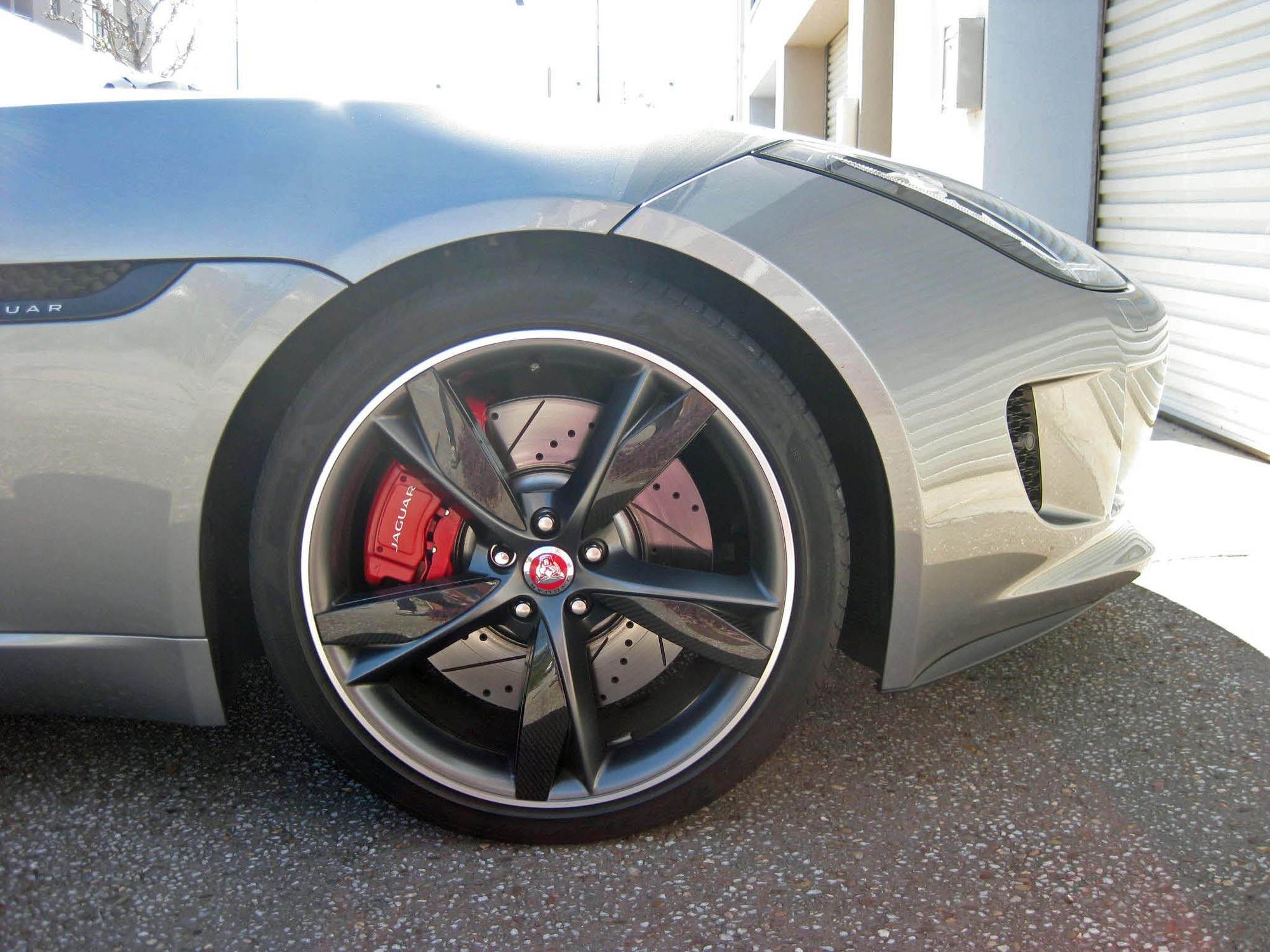

Here's some pics of my handiwork:
The XFR with repainted calipers and "R" decals (pic taken after some brake dust had settled on the calipers):
The F-Type as it came with factory red calipers and faded "Jaguar" decals:
The F-Type with new decals (calipers still original, not repainted):
