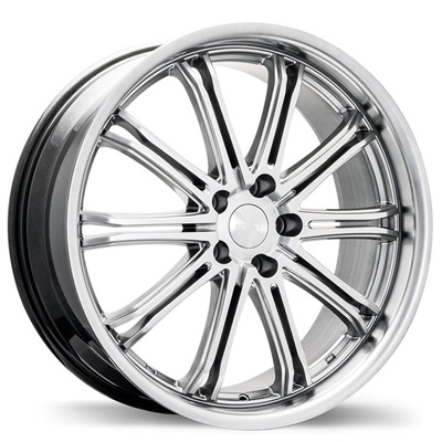

Lined up these Fast Oasis wheels for my winters.

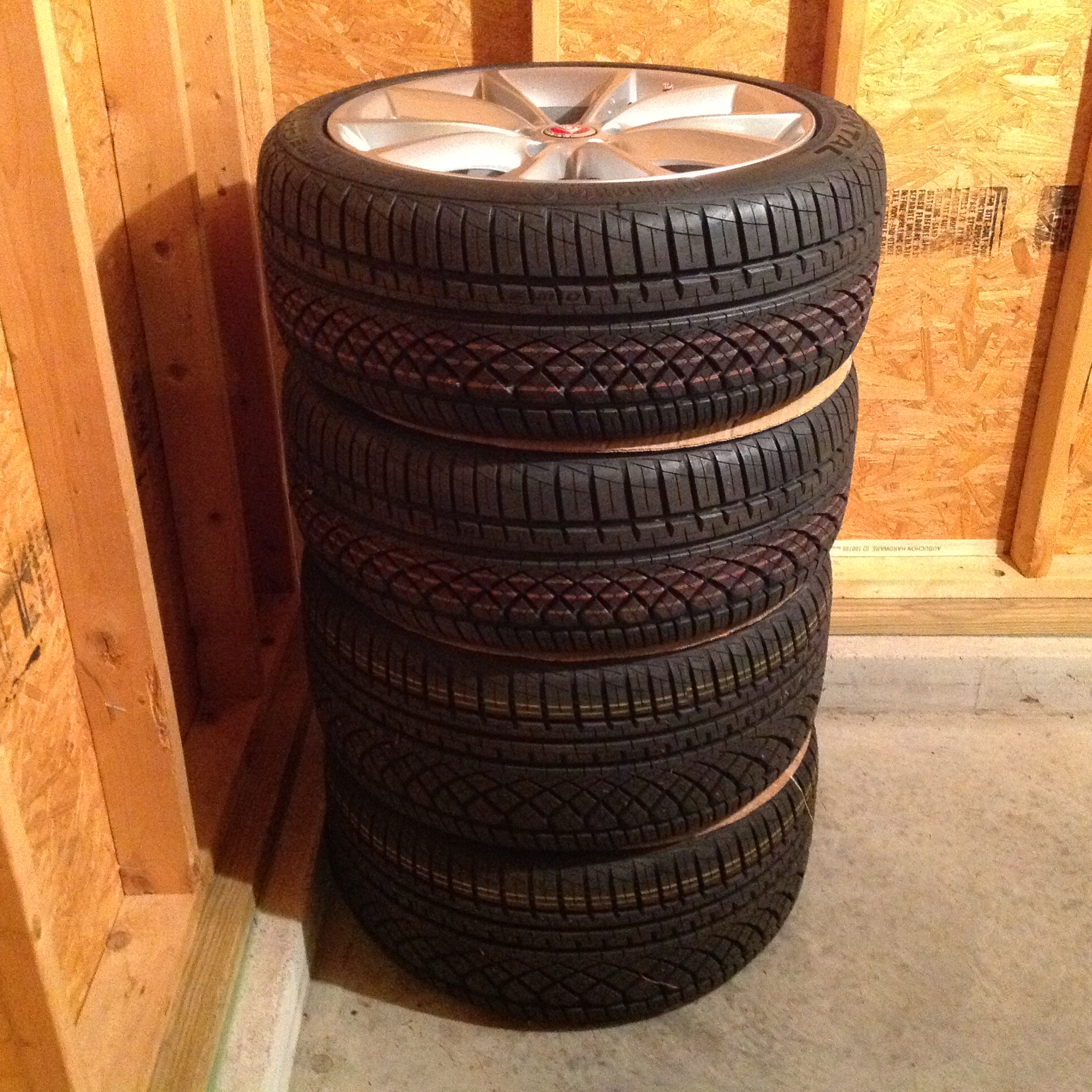

Ready for winter...

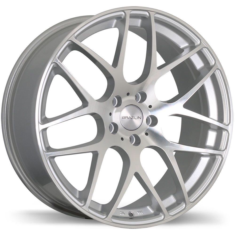

In the end, I decided to bite the bullet and buy wheels and rims. I'm getting Braelin BR06s staggered setup on Blizzak LM32s. Hopefully, this will stick the car to the ground.

Those are very nice and will look great on the F-Type. Can you publish the size and offset specs here?

Specs are:
Fronts: 19x8.5, 45 Offset
Rears: 19 x 9.5, 25 offset
The bore holes are custom drilled -- 63.3mm for a perfect fit.

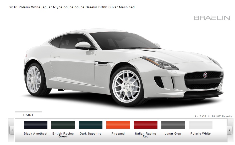

Manufacturer is Braelin -- out of Quebec. Their website has a customized viewer to show what these rims will look like on any color F-type -- pic attached showing these BR06s on Polaris white (seems like their viewer may not know that the 2016s come standard with the panoramic roof ).
Truth be told, my first choice was these in black -- but they were out of stock until late december. So, I settled on these in silver. Still looks good in silver -- since my summer/stock OEMs are the 19" black and diamond turned the silver BR06s will give me a different look for winter.

Thanks. I like silver better on Polaris, obviously.

Can anyone who is good at mathing tell me the difference between using these in the rear for winter at 19 x 8.5 with a 42 offset versus the stock 19 x 9.5 propellers? Hopefully it is not too noticeable....

It should be OK. The difference is only about 1/4". The offset of the rear Propellers is 27mm, to compensate for the extra 1" of width. The front Propellers are 49mm.
It would be like mounting your front tires on the rear. If you want to test fit, you could simply jack up one side of the car, and try that.

Thanks Foosh. I was hoping it would be marginal.

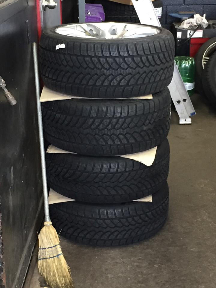

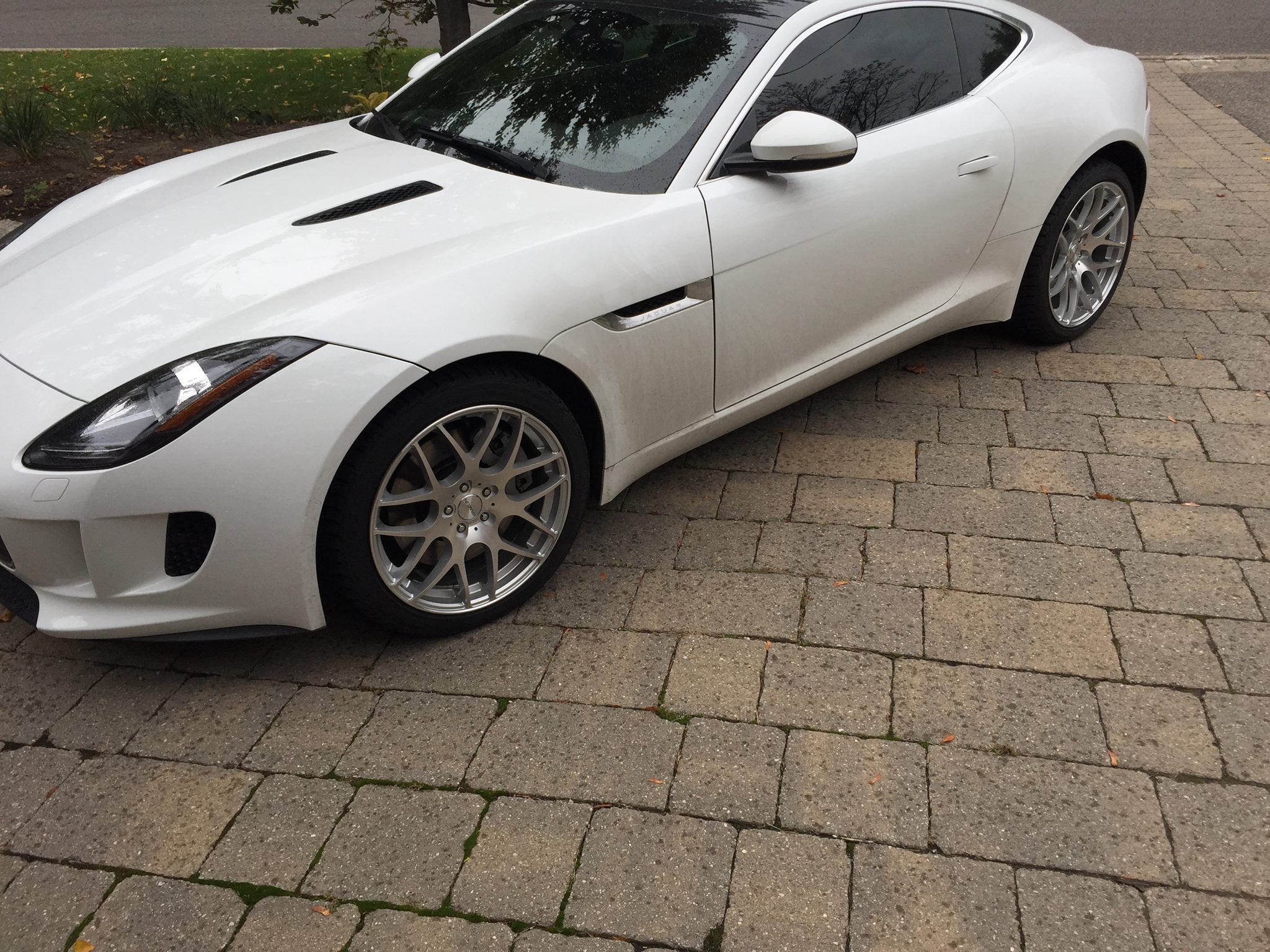

My winter wheels/tires came in today. Mounted (please excuse the dirty car!)
Pics attached.
