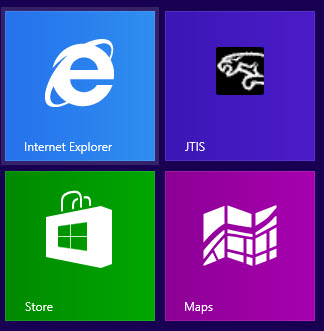

I just got a new desktop PC and wanted to get JTIS in it. Thanks to the excellent materials and instructions of jimlombardi I got the new version of JTIS21 and got it working! In two evenings... here are the critical points in my case, with Windows 8 Professional 64 bit:
  • download the program and instruction as instructed
  • follow the instructions carefully - be prepared to work out the DAO350.dll and JJTIS.ini files, especially if you have had the previous version installed or with an installation attempt before
  • MS Help software update -x64 did not work - apparently I'm not missing anything critical
Jim's instructions are here: https://www.jaguarforums.com/forum/g...rchives-65926/
Now I will collect some more courage before I update JTIS13 in my laptop with Win 8 Pro 32 bit… It had JTIS in it already when I upgraded Windows and JTIS kept working ok after the upgrade.
Jouko
