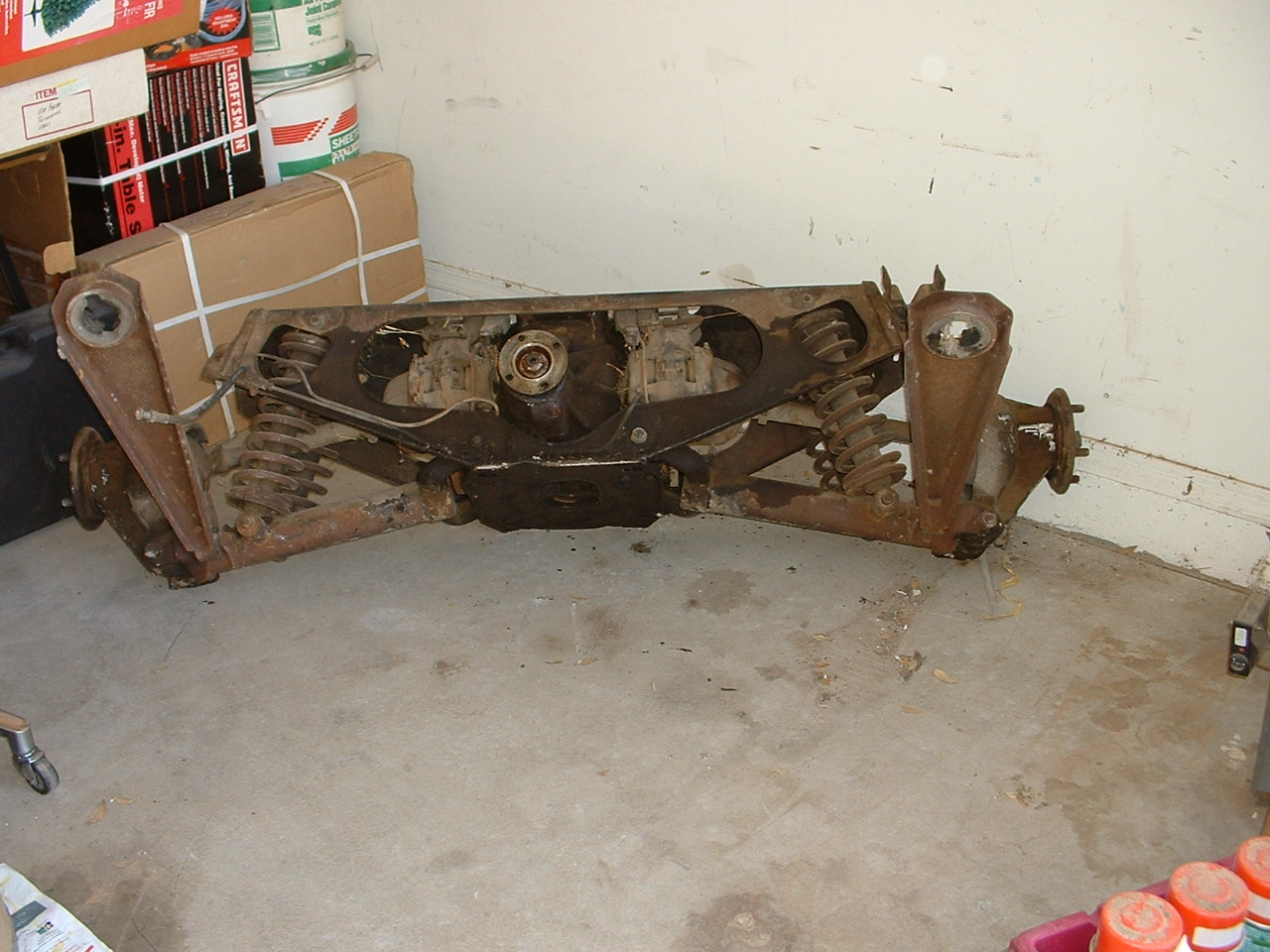

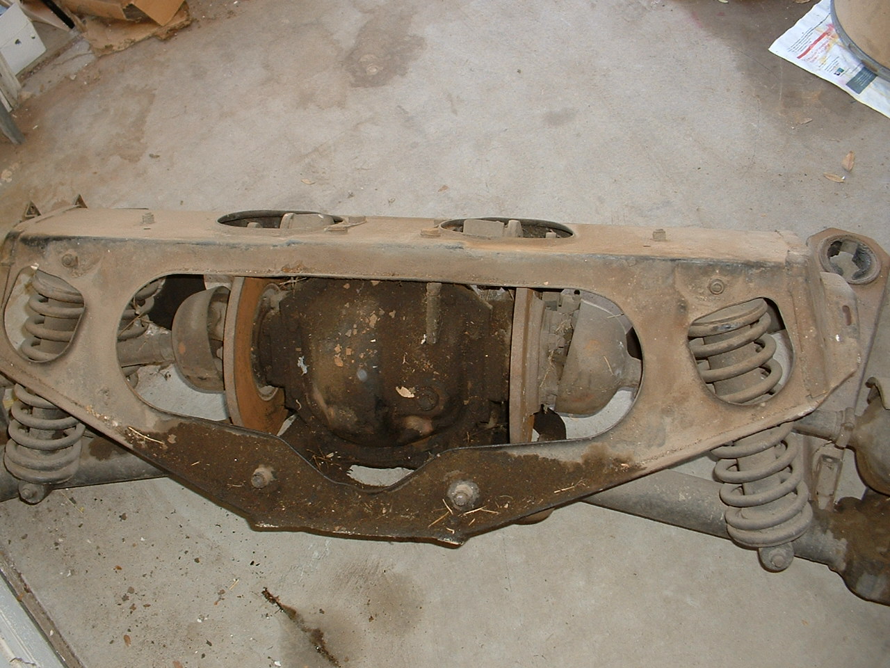

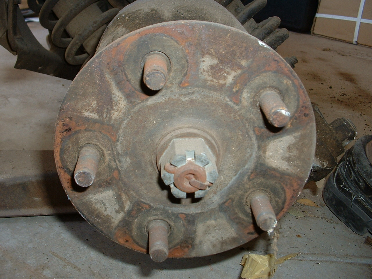

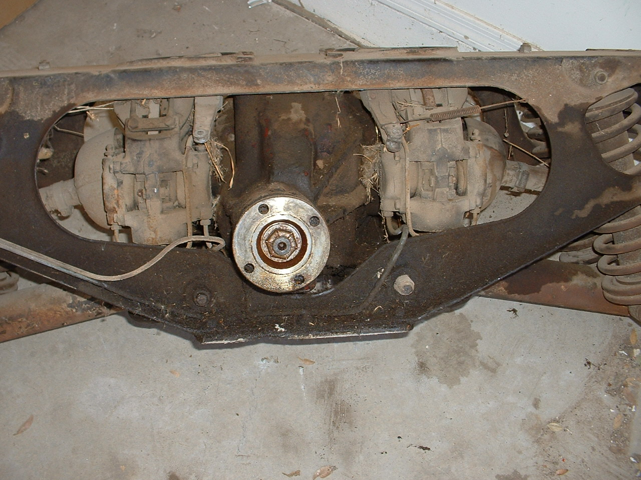

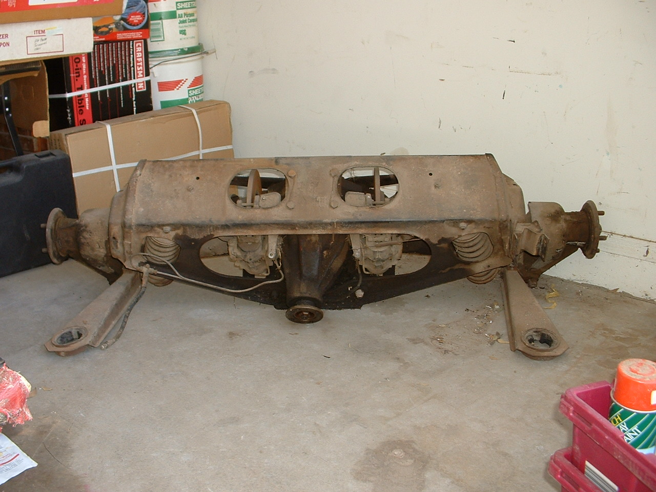

Can someone please identify the make and year of this rear axle assembly?
Sincere apologies for the less than stellar pictures.

The same basic design was used on many models.
75-93 XJS
68-87 XJ6
72-92 XJ12
62-70 Mark 10/420G
61-75 E-Type/XKE
63-67 S-type
67-68 420
Someone with an eye for details can probably narrow things down to some extent by looking at brake pipe and calipers and/or other detail items.
Based on sheer numbers my guess is 80s vintage XJ6/XJS
