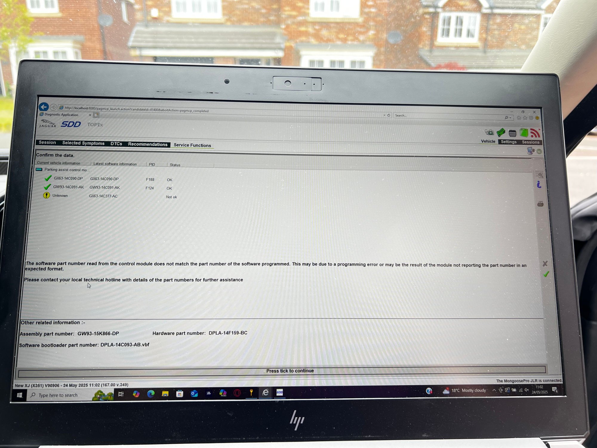

i have plugged the sdd in and it said there is a problem with the module. I’ve swapped out the module and it hasn’t made any difference.
this is now the error on the Pam module
The software part number read from the control module does not match the part number of the software programmed. This may be due to a programming error or may be the result of the module not reporting the part number in an expected format.
can anyone suggest my next step to fix this issue please? Thanks in advance
This is the message when trying to update the module back to as built

StokerC,
Are you using SDD on-line or off-line?
The procedure for reprogramming modules begins with the existing module in place.
Reinstall the original module and try "reprogram existing module".
If that fails, clear codes, system reset and go to diagnostics.
Follow the procedure.
