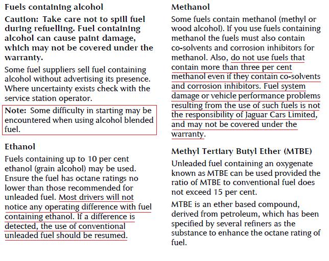

(UPDATE)
I changed gas stations this past week (was filling at 2 other stations) and the codes has stopped. Any relation to this? As long as there are no codes, I am sticking to this one station.
This may explaine my problems; the Owner's Handbook has this:

Old Jan 19, 2012 | 08:49 AM
  #33
Likes: 17,018
My XK8 Handbook has exactly the same section. It's hardly a glowing endorsement for these additives and tends more towards 'can' be used rather than 'designed' for.
In the UK our standard unleaded fuel is 95 Octane. This normally contains 2 per cent grain alcohol but can contain up to 5 per cent.
I take my car over to France twice a year where I cover around 2000 miles. In France, 'E95' containing 10 per cent ethanol or grain alcohol is replacing the equivalent standard unleaded. I avoid this stuff and use the alternative but costlier 98 Octane unleaded. There's no noticeable difference in performance but the lining of my tank and fuel lines aren't being subjected to the corrosive effects of ethanol so it's worth the small extra cost.
On the XK8 forum reports of fuel pump failures in the US are common whereas they are comparatively rare in the UK. That tells me what I need to know about 10 per cent Ethanol, Methanol etc additives.
As an aside, I'm paying £1.31 per litre for 95 Octane. This equates to $7.64 per US gallon. Interested to know the fuel cost in US and Canada.
