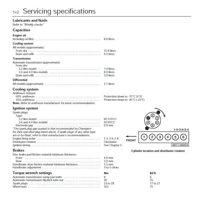

On the other hand thank you for your feedback! I ordered a 12 qt case online of Royal Purple 20w50 online a xj40 4.0 takes 8.5 qt's right?

According to my XJ40 Driver's Handbook (been on the bookshelf for a lot of years!) and Haynes Manual, it's 8.0 Litres including oil filter which equates to 8.45 US Quarts.

I stand corrected, thank you for the information Graham.
