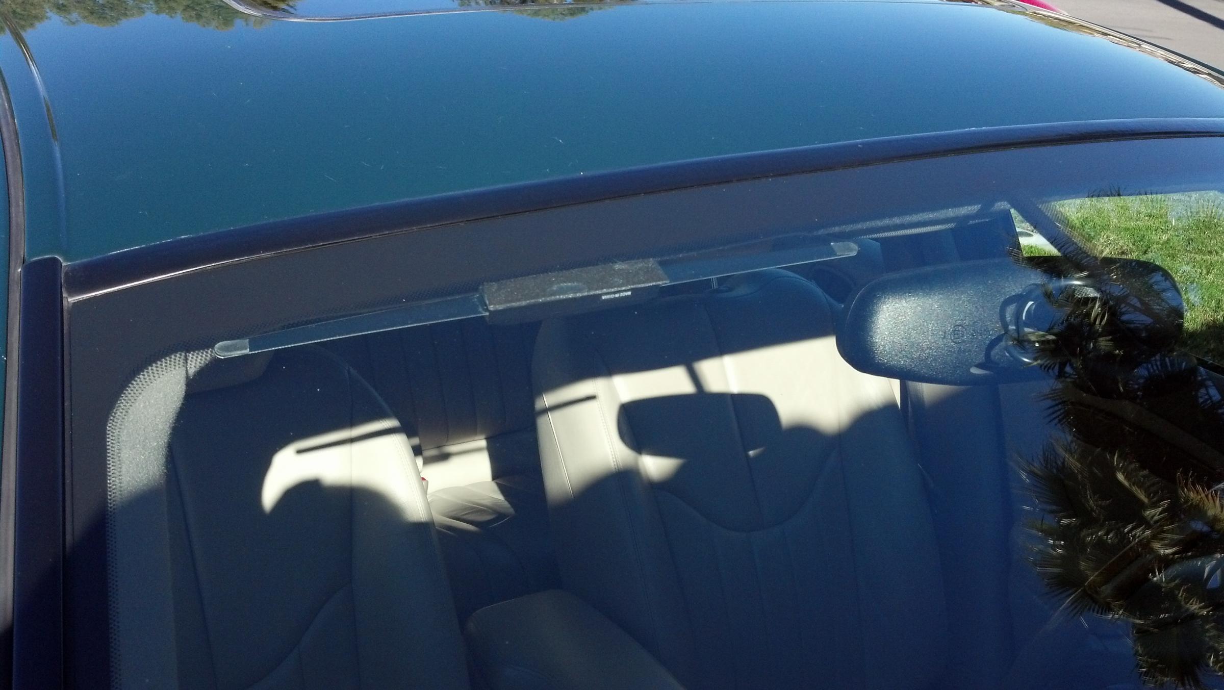

I recently purchased a 2001 S-Type from a used car dealer, noticed this during the test drive, he couldn't answer. Apparently it's no longer inportant considering I'm not using it and the car runs great and I'm happy. I do want to remove it, but before I go ripping it out I'd like to know where it ends up. It does have a red led that lights up when the ignition is on.

Looks like an internal antenna. Def not a factory part

Agreed,either for cell phone, or car stereo.
I have one on the "late" XJ-S. Powered up with an ignition feed.

Remote Starter antenna.
I have one too, probably the same brand. Look around for an I.D. sticker for the remote starter unit hidden away somewhere, or the unit itself.
They are quite pricey, and difficult to install (and remove), so you likely have one installed!
Possibly all you need is to replace the lost $25 remote to make it work!

Or to disconnect it so the PO can't make it work for 'vehicle recovery' purposes!

Probably a CODE-ALARM F50/F55.
It was a popular aftermarket remote start for Jag and Ford products.
Google for info.
PM if you can't find.
