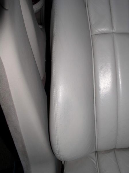

Here's an example from an X308 I had:
Typical wear on the side of the driver's seat (RHD). The surface has gone completely in places, exposing the base coloured leather beneath.
I considered having the section replaced but was advised by a local vehicle upholstery specialist to refinish the existing with water based dye and clearcoat.
The results was better than hoped:
Several companies supply cleaners, matched dyes and clearcoat or even complete kits.

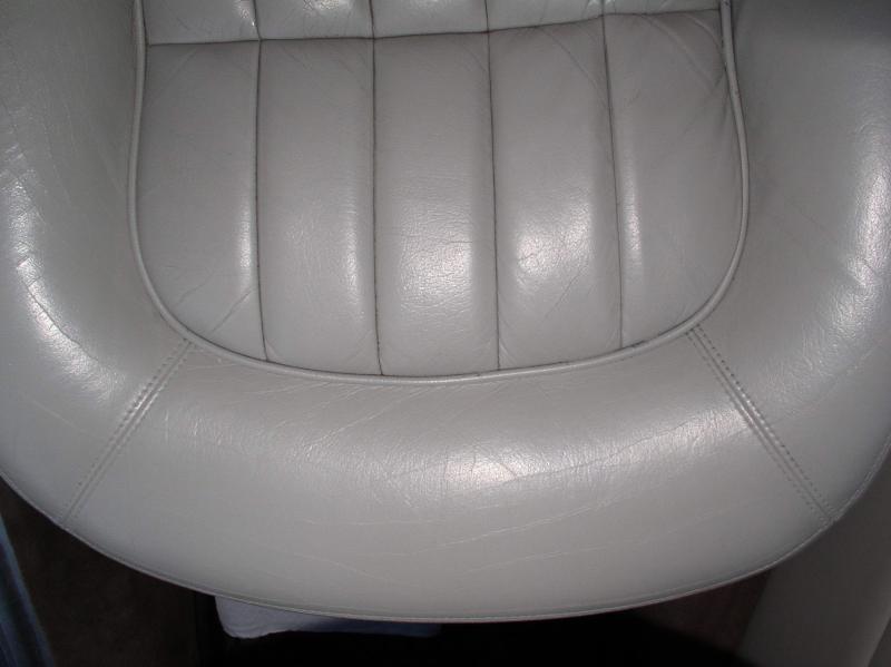

Although I've only done this on individual panels - the seat back shown above and the driver's cushion shown here..............
............. I know others have done entire seats with satisfactory results. I certainly wouldn't hesitate to do a full seat or full interior if required.
The secret is thorough cleaning and abrading. Other than that, I'd apply both dye and clearcoat by spraying to obtain an even finish.
