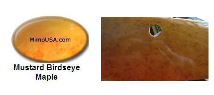

Well, I got the kit finally, but am returning it - look at the difference in the "sample" chip that's online, and what the kit turned out to be. My XJ6 is penrose yellow and I was trying to go with that theme, but the kit turned out to be darker than the original wood, which is also birds eye maple. Oh well. I think I'm going to refinish the original wood instead. Anyone torn apart the dash to take the wood out?
Caris

Hello,
Original wood is Walnut, either "burr" or figured depending on trim level. They yellow dramatically over the years, a large part of this is the polyester finish turning colour. You probably made the right choice as new wood can still be had through Jaguar (or re-veneered) for the S3 XJ6, and those stick on overlays are, in my opinion, a temporary cheaper fix. They never seem to look like the real thing to me. Good ol' Chinese manufacture most of it. The XJ dash wood is screwed to a metal sub panel, and is pretty straighforward, if a bit time consuming the first time you do it. Main anchor points are near the LH/RH air con vents, a few bolts under the black dash top, and 2 small nuts behind the coin tray (trip computer on later cars). Start taking off all the black trim (and steering wheel) and it will be pretty much explain itself as you go along.

Hey, thanks so much for the tips on taking the dash out! The original wood is in great shape under its finish - the finish is weirdly wrinkled, maybe from heat? (the car has lived its life in Texas). We have dash kits in three of our other non-Jag cars, and they look very nice, but besides the color being so totally wrong, the puffy, plastic look on top of what is a flat, elegant, analog dash setup just looked ... fake. Just as well the color didn't suit, so I got out from under this possibility. Now, just have to make the time to have it out of action for a couple of weeks - hate to not be driving it. Thanks again.
