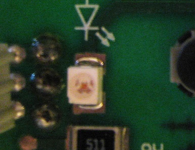

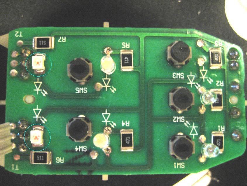

Well I have two swtiches done I will post pics tommorrow but having problem findingthe surface mount diodes, don't know the size maybe one of you can helpme here is the pic. This is the dimmer, trip and fog light switch.
I also need help in removing the window switches, I'm afraid of breaking the wood. I posted my reply in the S-Type forum.

Close up...

two switches that are in progress

Well update .. I received the plcc-2 and got the color to match.Next this weekend will be the window switches.

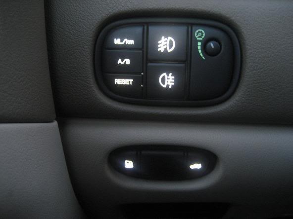

well progress.......
Notice the big difference between the green and white..... it is much cleaner
