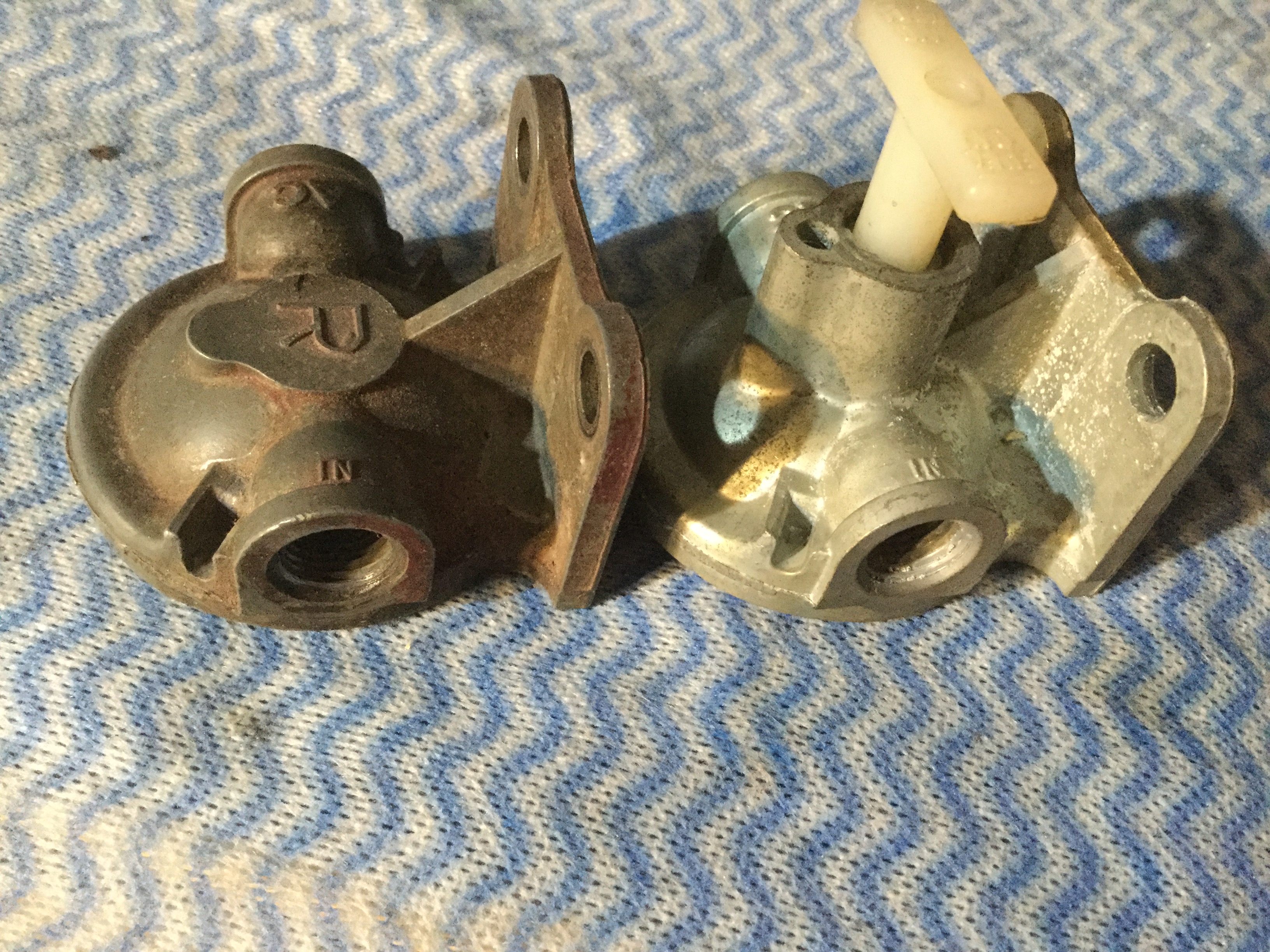

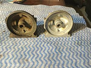

The filter element cannot determine the fuel flow, this can only be determine by the filter housings internal porting. As the filter head is bolted to the inner wing it can only be fitted up one way, the fuel line to the filter is steel so the orientation should not change.
Here are photos of the filter bowl that I have just taken off my car and a new one with a cut off screw showing the fuel coming into the bowl enters from the centre and exits from the outer. Also the only filter element was a brass(?) gause disc? Usuals do not list a filter only the disc.

Robman - I realise the filter element doesn't have any bearing on the direction of flow but I assumed petrol would flow through from the outside -> in and out throught the centre. I don't know why I thought this.
My filter housing is the one with th 'R' on it. I've removed the filter, replaced the gauze and put a disposable in line filter on so I can see how rusty it gets.

The filter you have shown is the v 12 filter and is incorrect for your car. the correct filter should have a hole through the middle so the fuel enters the bowl and filters back through. This allows the sediment and crud to be seen as it is captured in the bottom of the glass bowl.
