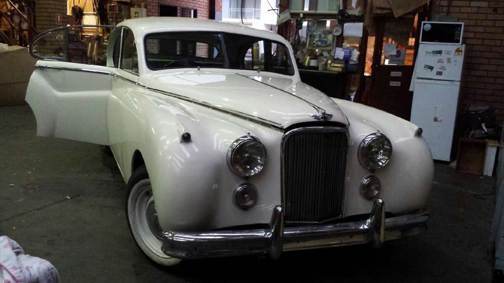

BTW, here is a photo of the old girl just after the front windscreens were fitted. It looks a treat.
