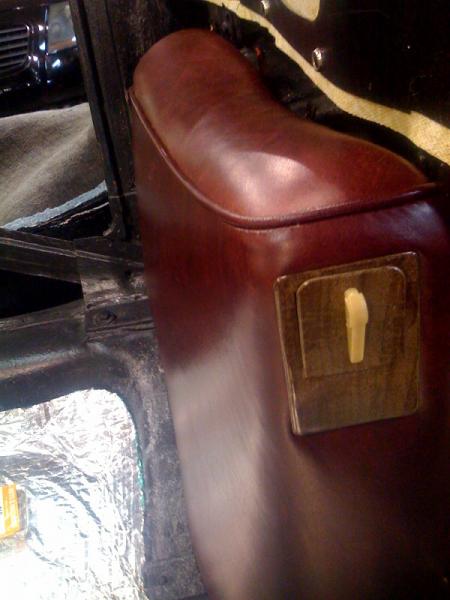

These old Jag's large amount of book matched wood interior is what often makes them so loved and unique but it can cost big bucks if it is badly damaged. The beachwood material is not easy to obtain as it is rare to find it from beachwood over 1.5" in diameter and the restoration, coloring, etc. is best done by a professional for a factory finish, it is not like buying a faded or worn desk and you think you can just sand it and throw a coat of varnish on it. Costs can go up to $5000 for a new dash that is almost all new veneer or even with mild damage, say a handful of small spots that need repair and then color blending you can easily spend $2-3500. If any of the veneer is completly gone plan on spending a lot of dollars. The wood can be a huge cost many forget.

I wish you the best of luck. The wood on Jaguars is a old school skill that takes a lot of experience. I was lucky that a friend of mine used to do that professionally. Remember the wood is not solid but veneered and book matched so it appears to be a solid piece of wood. That type of wood is basicaly from a bush so getting larger diameter veneers of the same quality is very hard let alone to book match it. Sure it is fun to try to do it yoursef but I highly recommend to think about getting a pro for the wood as that is one of the parts that really is clear if the car was put together well and it might save a lot of grief.
If your wood is in bad shape I would highly recommend entertaining Jose's offer or find a better condition one used. The hard part is repairing any worn areas, coloring it properly, finding and knowing how to properly re-veneer, knowing the right materials, and all of the other prep work. Applying the many coats of clear is not as hard but still takes skill to make it look like the high quality furnture grade that Jaguar created back in the day. If Jose is willing to part with a quality dash ready for clear then that would be money well spent if his price is good but it would only be worth paying for it if the entire veneer is not worn too deep. Once you have to make partial repairs without an entire reveneer that is a difficult and not for the faint of heart. If it requires reveneer the dash is not worth much as the labor and cost to bring it back to showroom is big.
I would have to say the wood is a hidden cost that most do not realize as it can cost as much as repairing any rust or body issues. Body work and rust are a lot easier for the do it yourselfer to attempt than trying to learn a lost and dying skill like the wood on a Jag....

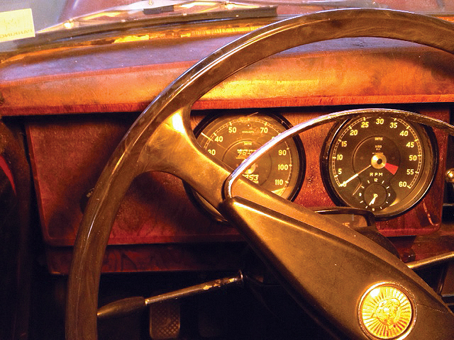

I've seen some incredible work by British Autowood in Orlando Florida.

I don't doubt it's a tricky business refinishing the wood in a Jag. But I have to say that I met a fellow a couple of years ago at the Forest Grove Concours here in Oregon who refinished the wood himself. Had never done it before. It was a beautiful job.
My only related experience is with my Packard, recreating the simulated wood on metal. I'd never done that before either. I'm kind of fussy about authenticity, so I chose the original woodgrain that a few months after introduction of the 1940s the dealers rejected. They didn't like the mottled aspen grain. But recreating woodgrain can be done by an amateur. It will be a few months before I start on the wood this 3.8, but this is what the starting point will look like for me, in the attached photos.
I guess what I'm saying is It's worth a try to do it yourself, if you get support from others who have done it. You learn a new skill and you have the satisfaction of saying Yes I restored it myself. If you mess up badly, then you can still pay the big bucks and have the satisfaction of saying that I paid for this myself.

reFINISHing is a whole lot different than rePLACing. Be very careful, use steel wool a lot, when it's stripped, re-glue any loose edges and hope you don't rub through the veneer in any places.

No, I would not use this as the primary technique. Just saying that something similar to wood refinishing, and as daunting to a neophyte, namely faux woodgraining on metal, is doable and worth giving it a go. But I can see that it might be used to replicate the veneer in small areas, like an inch square, that might be missing. The GrainIt Technologies people make a small silicone roller to impart the grain. They have just about any grain imaginable, and colors, too.
the problem I see happening in the last 10 years, are ultra-exotic restorations using highly exagerated veneers applied to classic dashes, veneers that were never used by the factory, and it detracts from the character of the original dash which came with more subtle veneers. Just my opinion, but Jaguar never used Zebrawood veneers or ultra-Burled veneer with 20 coats of polyurethane. I'm sure you've all heard the saying: "KISS".
