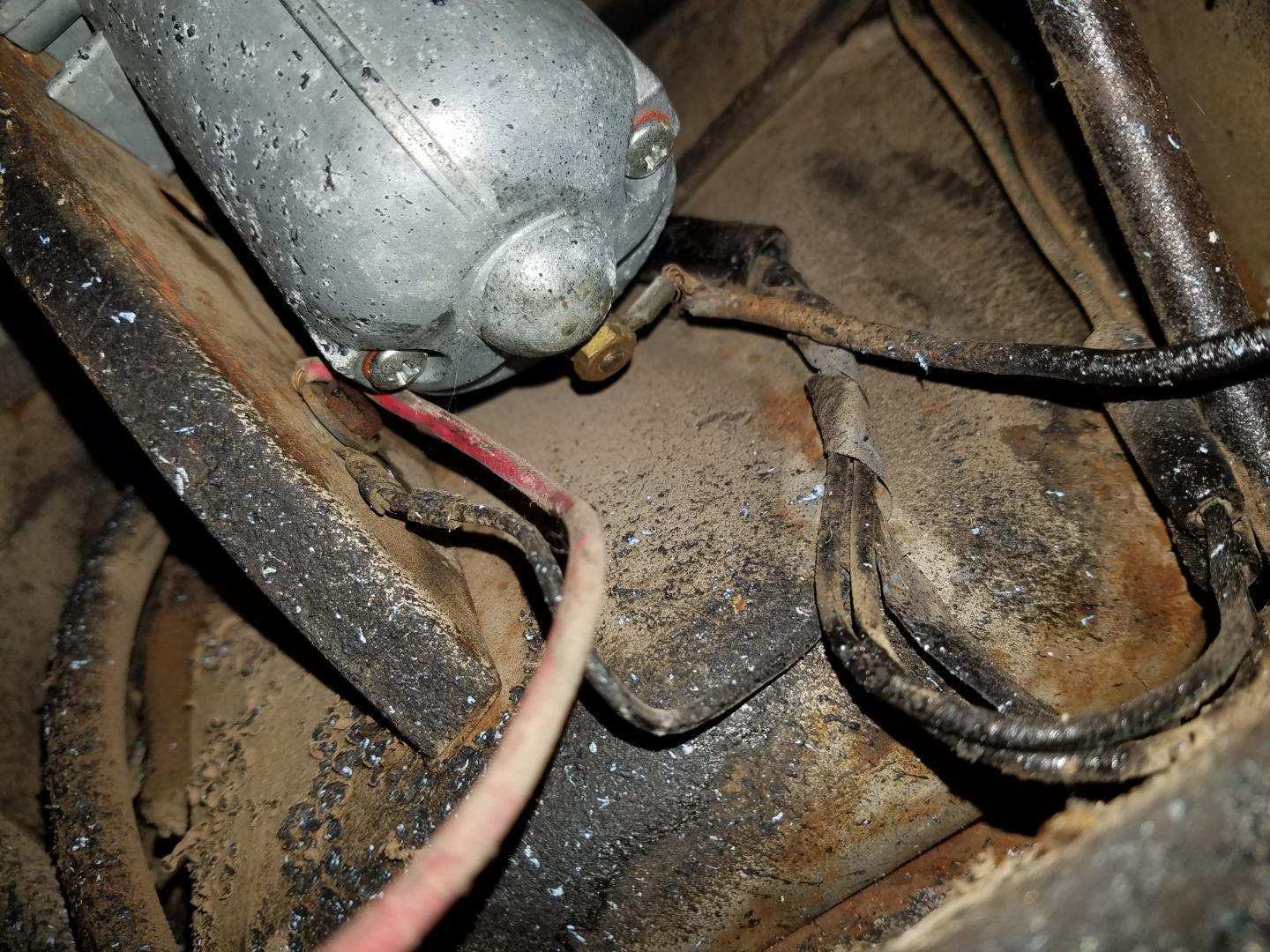

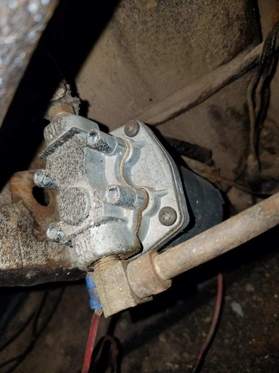

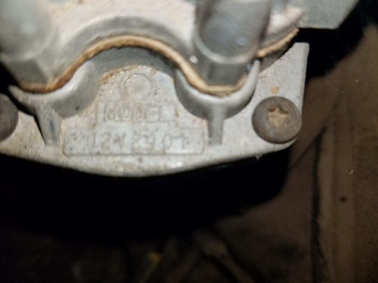

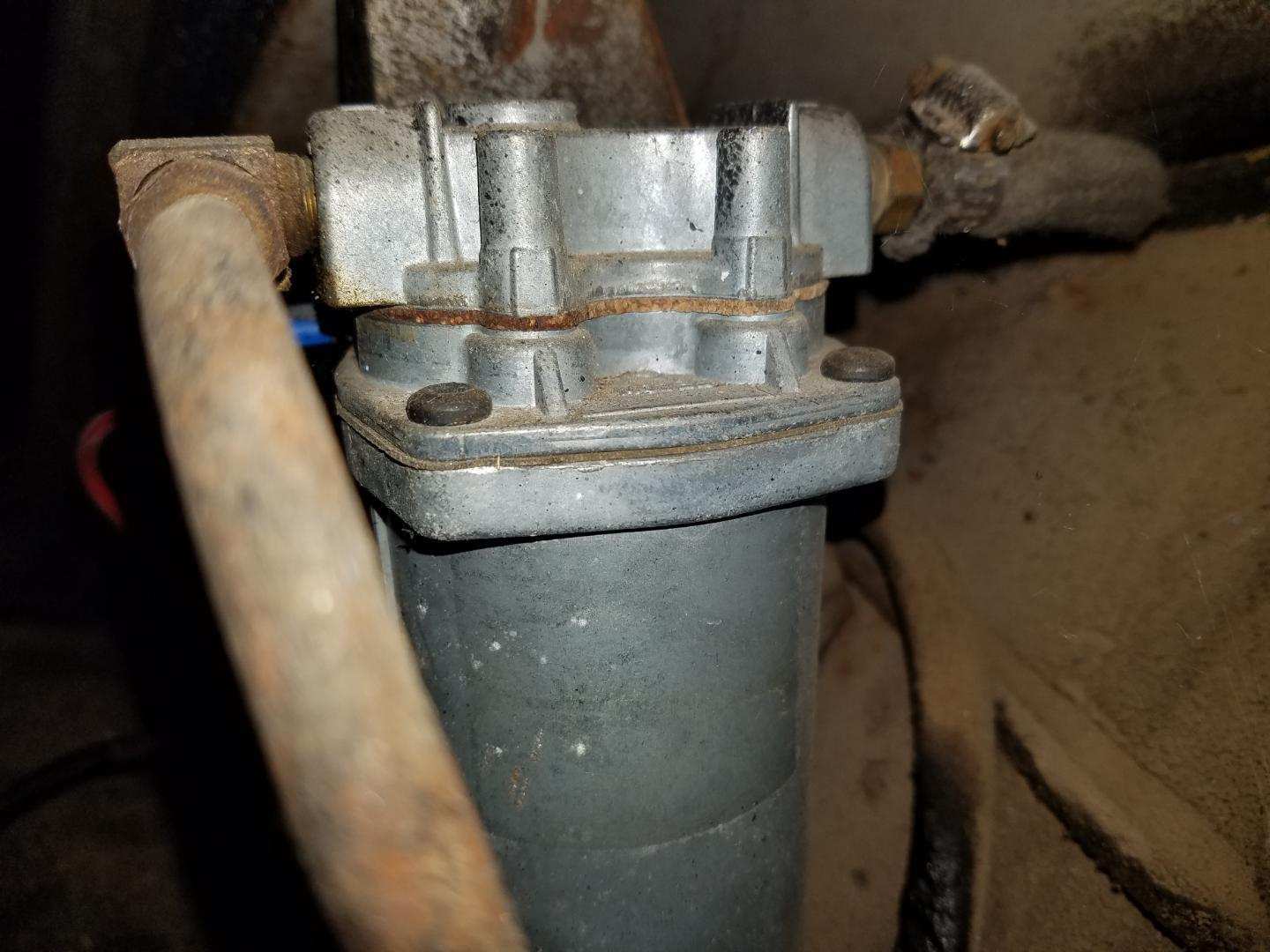

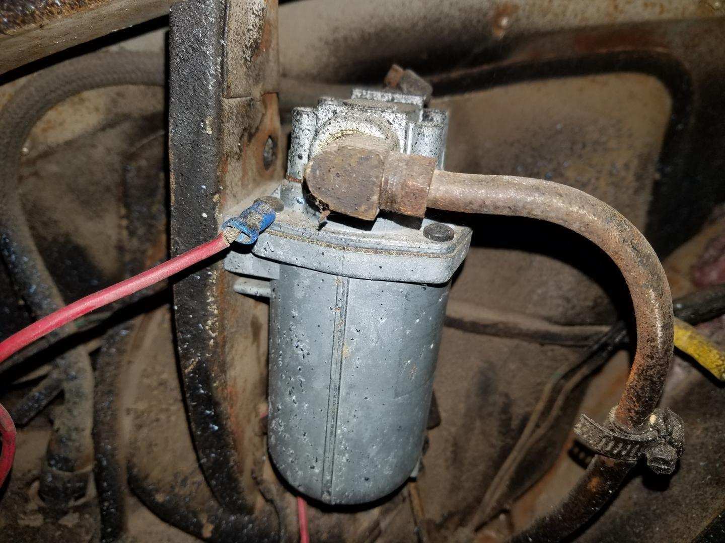

Can someone tell me if this looks like Jaguar fuel pump? I can't tell the model number on it and not sure where to find replacement for it.
I remember I bought ignition parts from online store in Michigan but lost my bookmark to it. Anyone knows their URL or can recommend other N. American shops with parts for old jaguars.

That is not an SU fuel pump--looks like an AC pump.As far as the correct pump or a solid state one any of the major vendors have oodles!

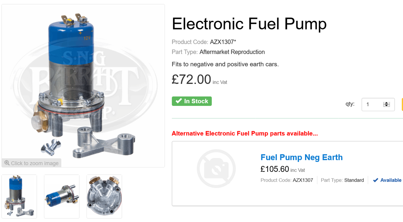

An SU fuel pump looks like this: -
People commonly fit the electronic models now, not those with points. The old type were the ones that used to give the "tick, tick, tick" when you switched on the ignition. You can still buy these : -
https://rimmerbros.com/Item--i-AZX1311
or you can spend more money and buy the electronic ones
https://rimmerbros.com/Item--i-AZX1311EL
