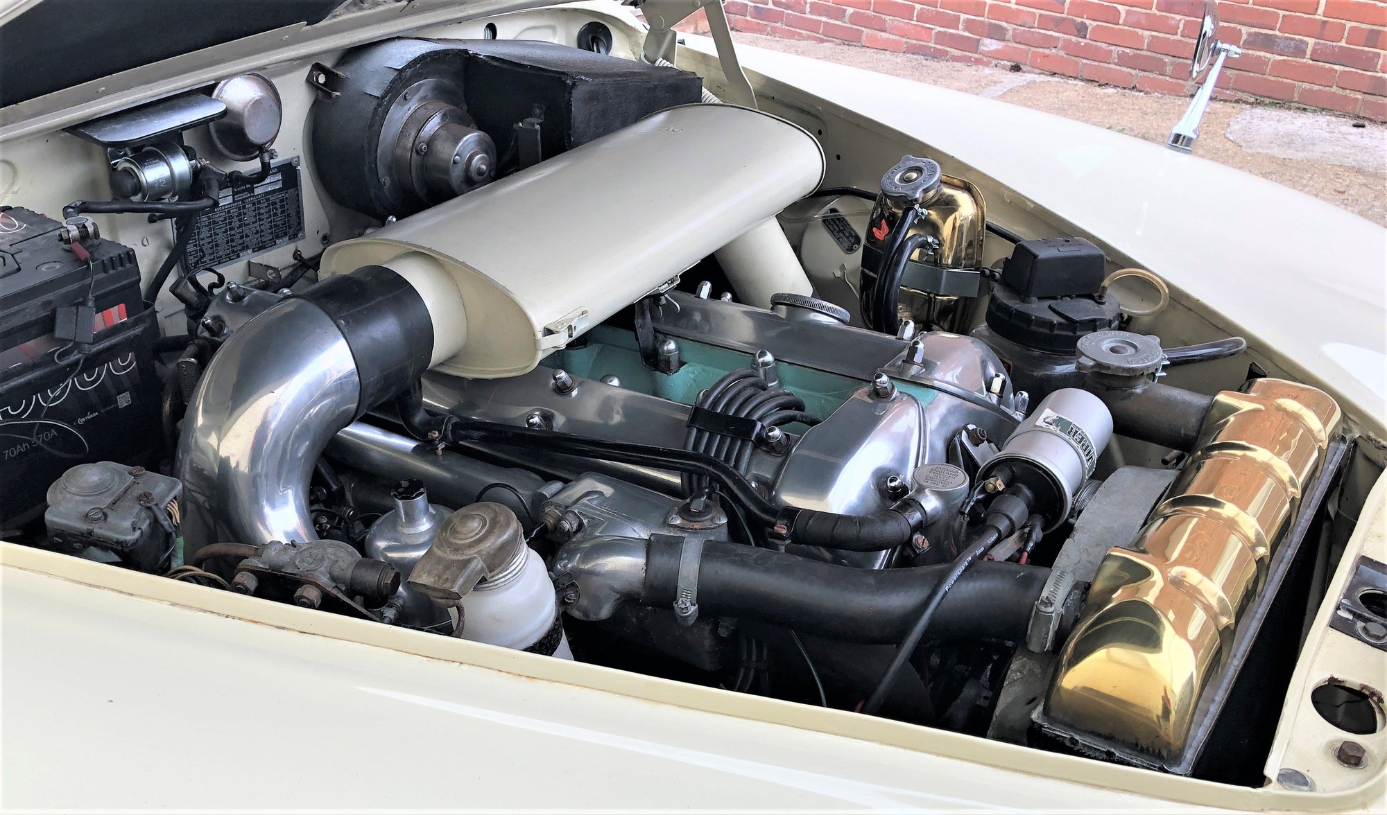

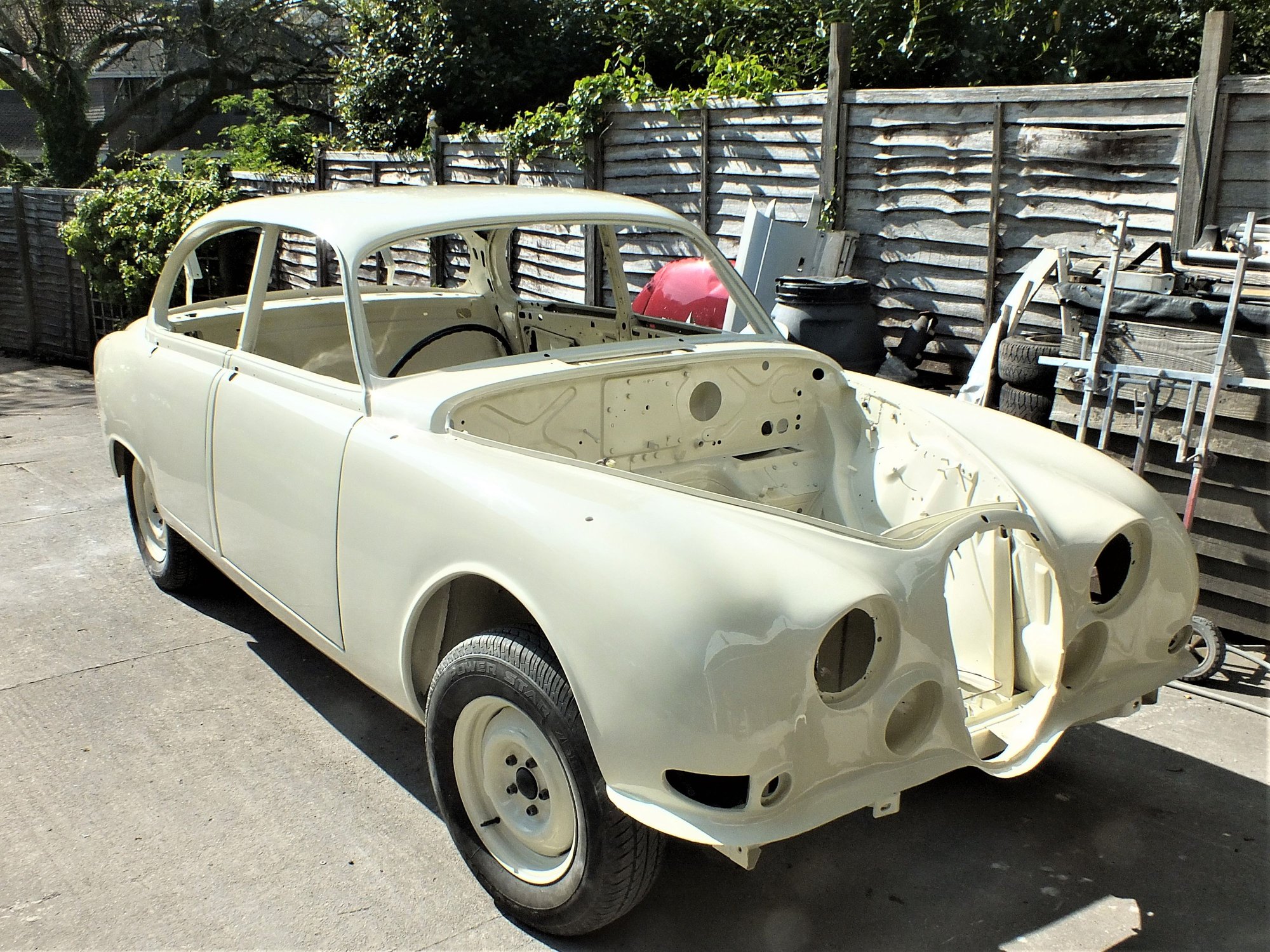

One of my pet hates to to go to a classic car show to see these beautiful cars but they all have their bonnets closed. When you ask if you can view the engine bay you are presented with a dirty unkept engine where the engine bay has been painted black. This happens even more so when the car has had a colour change and rather than pull the engine to paint the engine bay the same new colour they paint it black. My S Type was resprayed top and bottom so the bottom of the car although treated with an underseal, I used Tetrosyl White Stone Chip, was then over painted the same colour as the top of the car. This included inside the wheel arches. The new products you have on the market now allow this but in the 1960s and 1970s underseal was like a black bitumen product that was sprayed on the underside of the car, could not be over painted and in time became brittle and cracked. The cracking allowed water to seep under the undercoat and you would then get rust which you could not see.

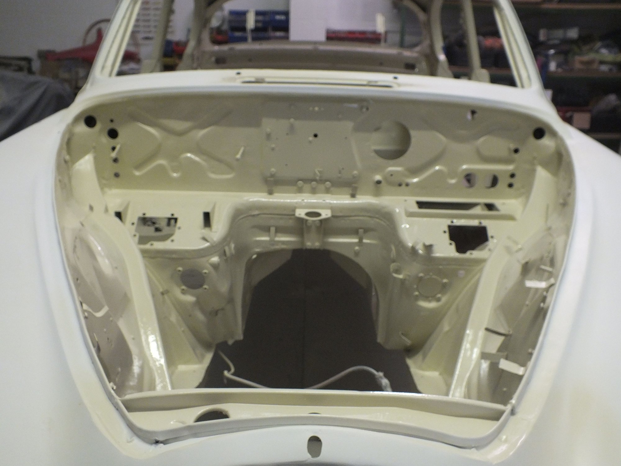

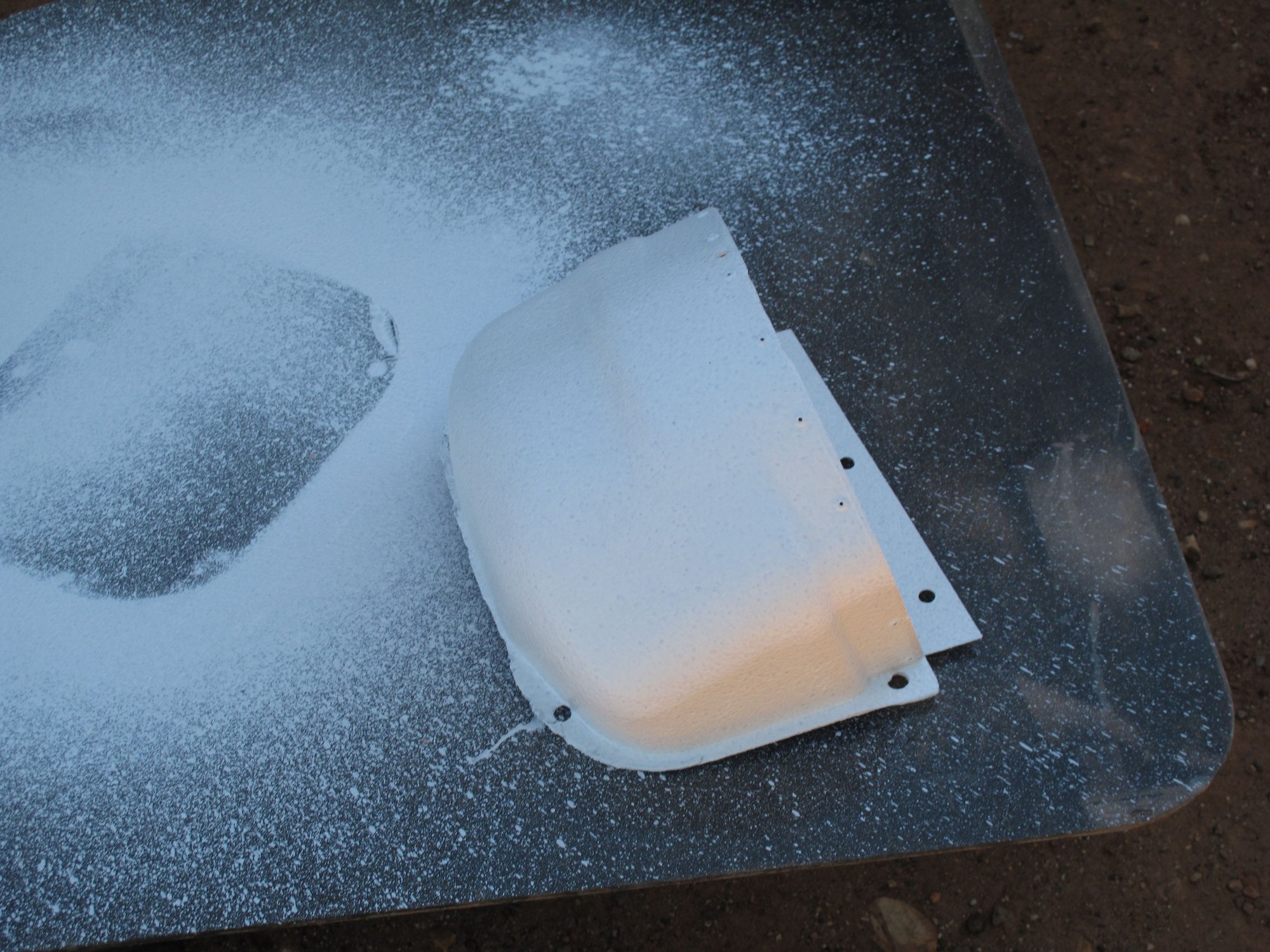

See under-body & wheel arches being painted car colour after sealing compound. Today we would use anti corrosive stone chip/Shutz etc. after dipping or spraying. As I had no dipping capability we used BASF/Glasurit Porsche self healing primer & spayed every nook & cranny as first coat for everything top & bottom. All double skinning of the monocoque, inside doors etc.
Pity their Phosphating & initial primer dipping did not work a little better.

Very possible Peter. On an Old English White car everything was Old English White. Under-body, wheel-arches, under bonnet & engine compartment.

OK, wow! That’s the way to go! That’s beautiful looking.
I hate the look of this stuff. Originally then they sprayed the undercoat directly on the primed underbody, wheel wells and through the the engine compartment. I’m disassembling the engine compartment now. Lucky for me this stuff is soft as butter thanks to a lifetime of oil and coolant leaks.
Thanks for the great photos.
