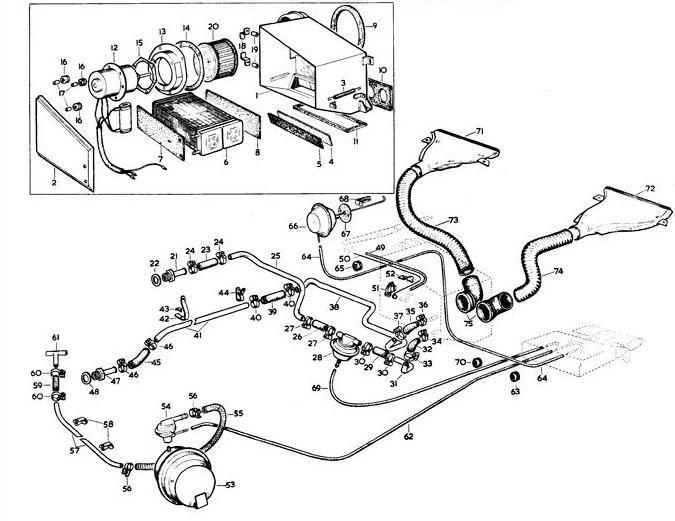

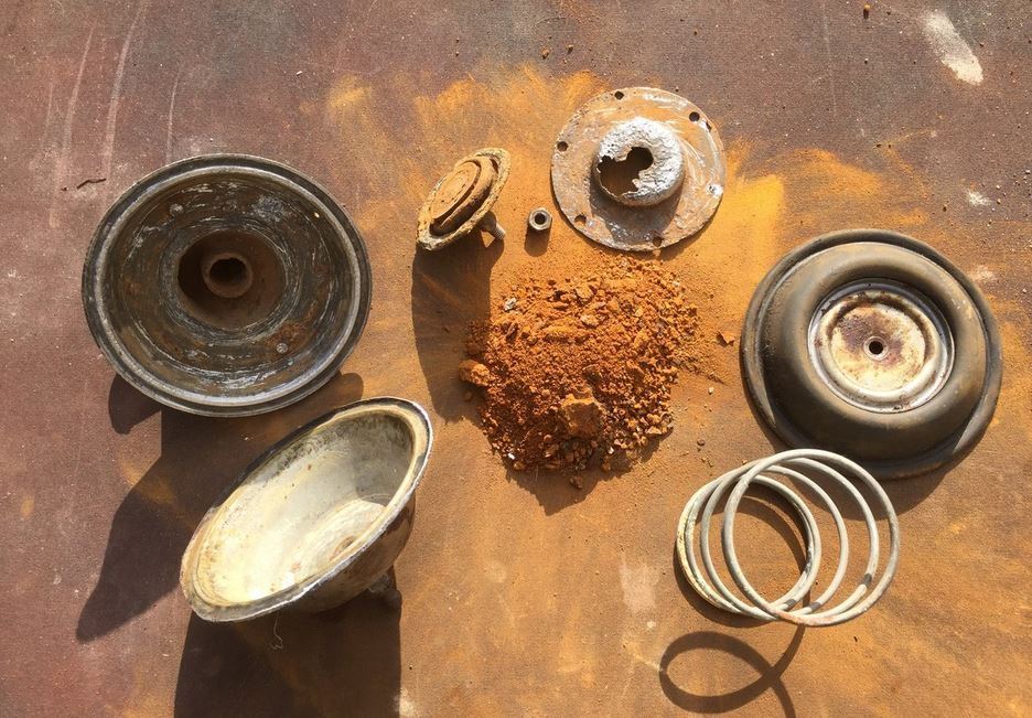

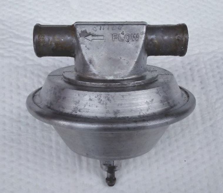

Jeff. On an S Type the heater valve (28) is vacuum operated & if the Diaphragm ruptures or the metal centre corrodes through ~ (more common) you suck coolant direct into the vacuum system & thus through the engine. Mk2 not so with cable operated valve..

Originally Posted by JeffR1
That makes no sense, while I don't doubt that what ever you did solved you white smoke issue, replacing the heater valve should not have done anything.
Unless it was leaking all over the exhaust manifold, I can see that.
the original valves have a weep hole through which they leak when the diaphragm tears inside, but not enough to cause white clouds of smoke burning coolant over the down pipes.
the clouds of smoke were indeed caused by the heater valve injecting coolant in the intake manifold and burning it in the combustion. I took the car to the mechanic and the first thing he asked was Did you have the Heater on when this happens? I said yes and he said it is the heater valve, replace it..
I found a replacement valve and the white clouds of smoke stopped.
If the MK-2 does not work like the S type, then it must be the cylinder head gasket or the brake servo leaking into the poster's engine.
