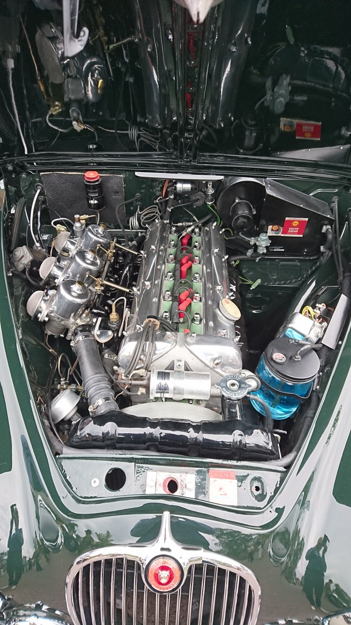

Still under build at that time: Lots of things still to do e.g. attach breather hose, attach decals, clean up wiring, Attach battery cover, Fit convoluted hose to air cleaner, Fit shroud to regulator, Windshield washer wiring cover is in the mail thanks to Alan Wiedie's valued assistance, etc. etc. I don't think the standard engine compartment looks that bad.

Meh...
As long as it's clean.

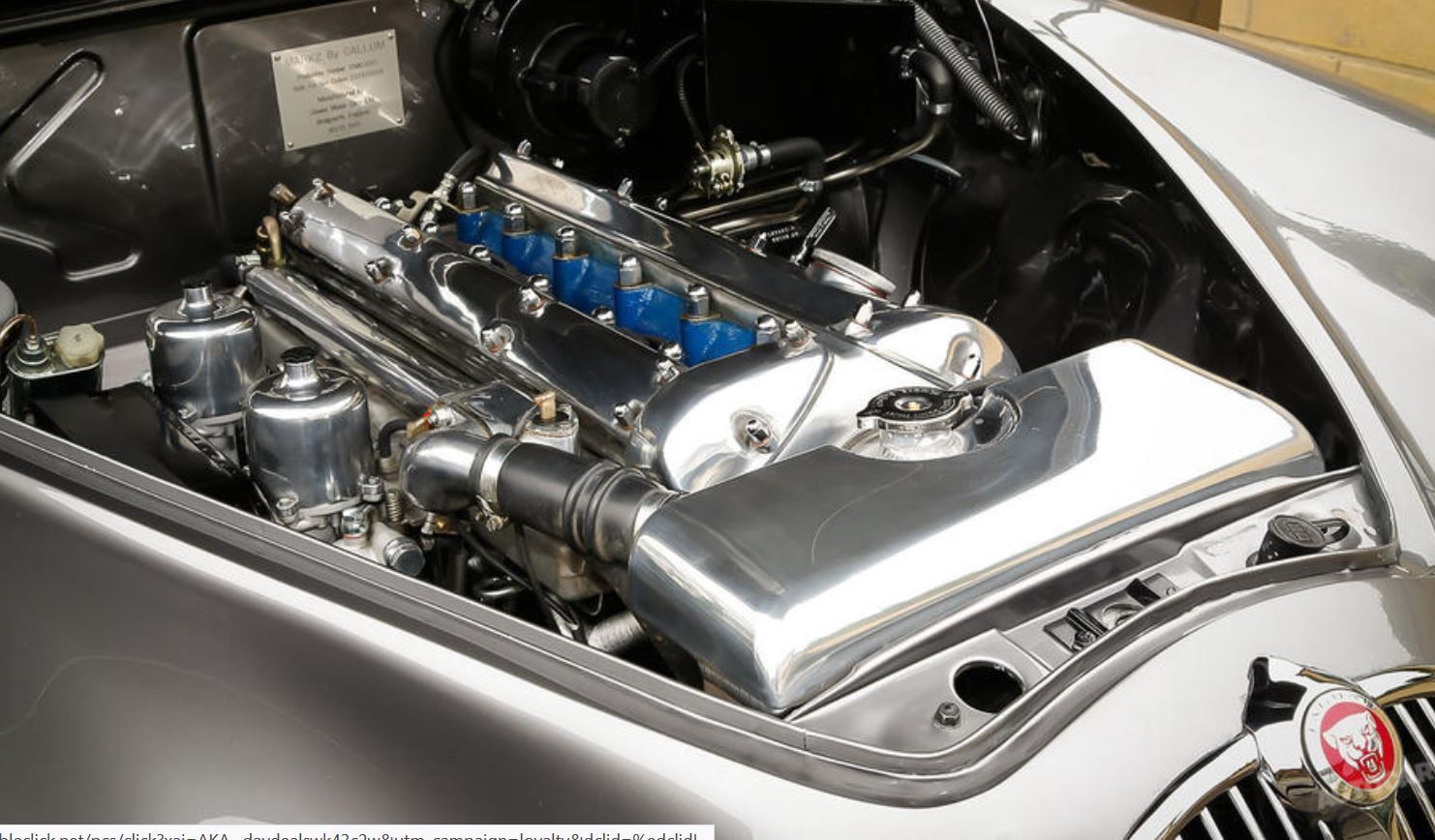

I'd like it better with an air cleaner and longer trumpets, but after so much polishing you have to show off the cam covers.

Very true Peter, and a beautiful engine bay. Where did you source the thin air cleaners? Regards, Morgan

Morgan, It's not mine unfortunately. It was produced by Paul Roach (roachclassics.co.uk), a UK restorer, as a Mike Hawthorn tribute. A company called Woodham Mortimer had it for sale in 2019. My car is more what you might describe as a wreck, one that no sane person would consider restoring.
My plan for eliminating the tin cans from above the engine is to do some surgery on the inner wing and put a big paper air cleaner under the right hand wing (fender).

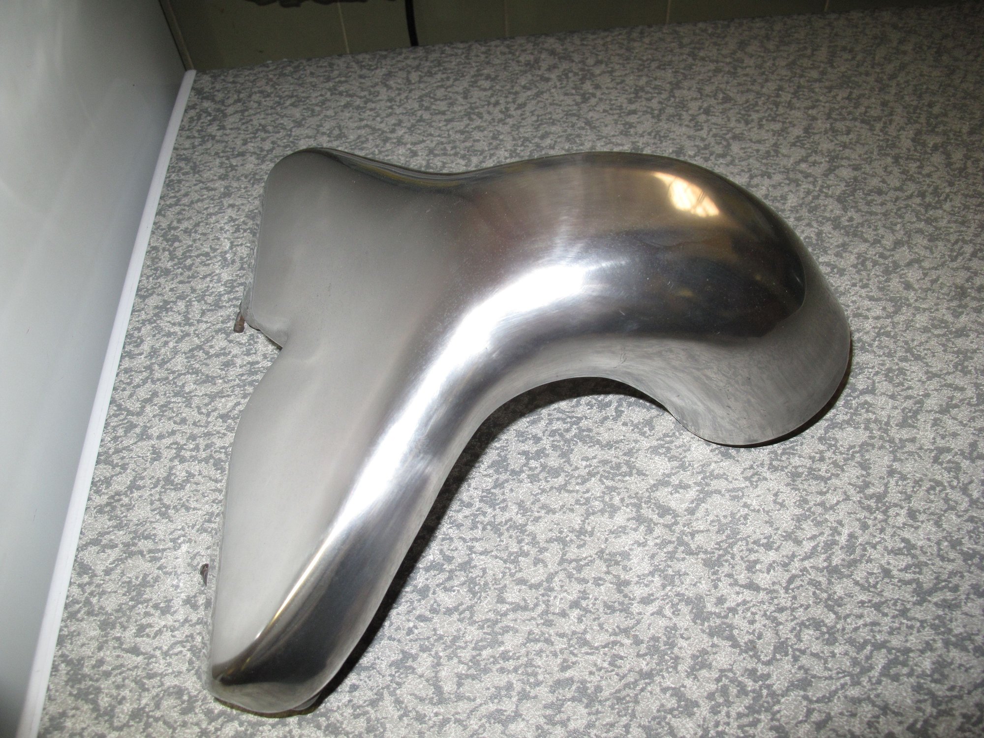

Callum had purpose made unit by CMC that draws air from under the fender for his 4.3 engine. Not the greatest pic but all I know that has been published. They are also widened purpose made fenders with more space under there.

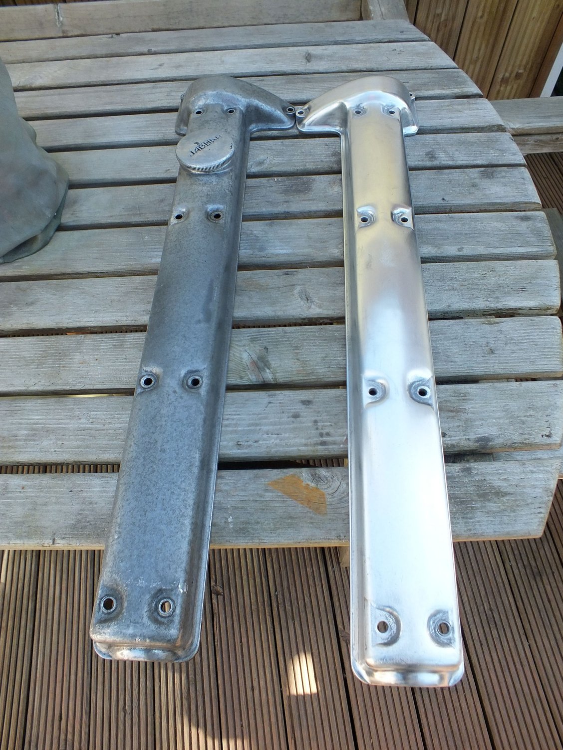

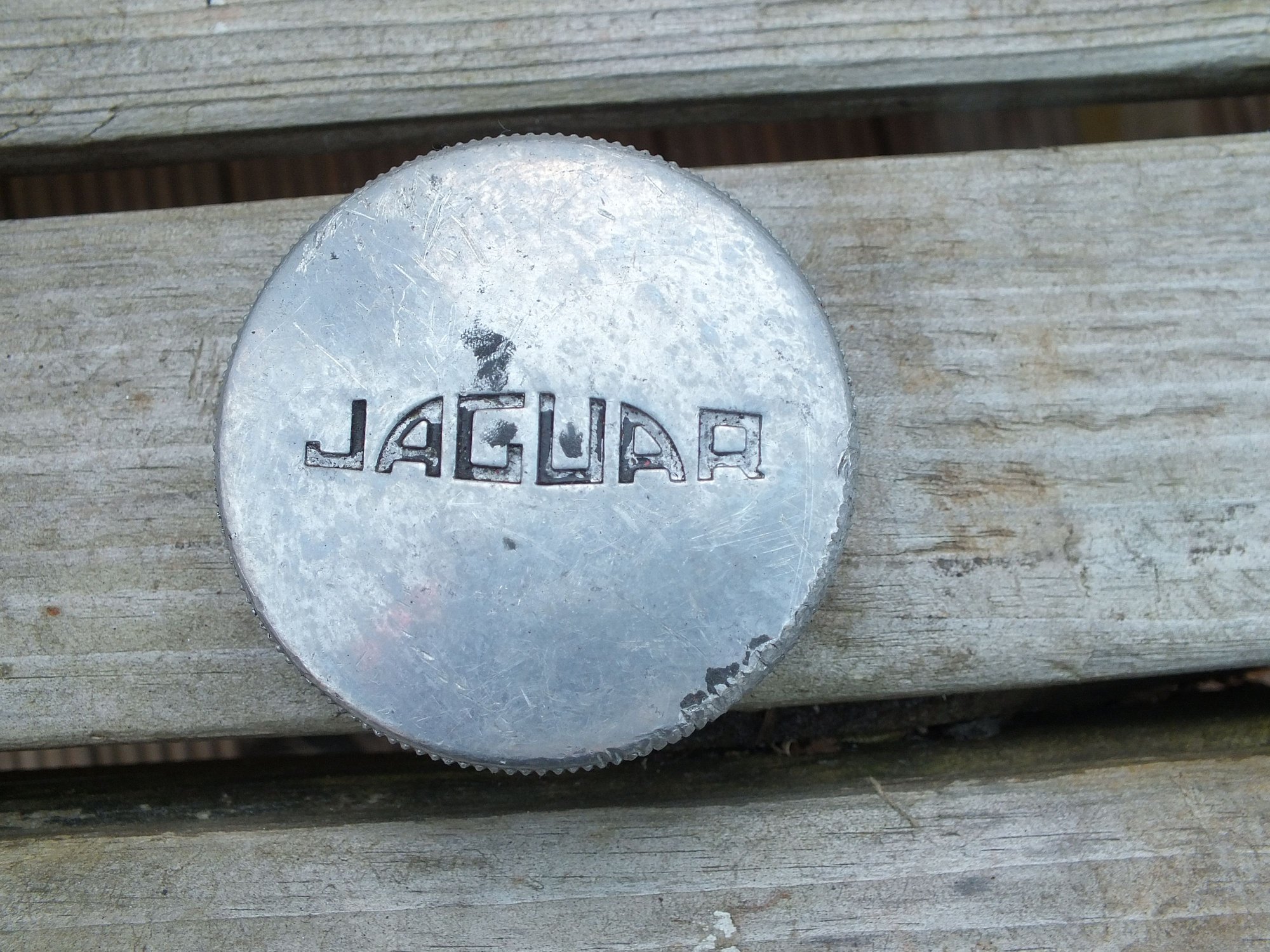

I have found the only way to clean any of the alloy around the engine is to remove it and do it on a bench grinder with a polishing mop. The whole point of getting it shiny is to remove any scratches on the surface which involves removing a small layer of alloy down to the bottom of the scratches. The polishing mop with different grinding pastes certainly does this but it takes time the first time you do it. Unfortunately I have yet to find a solution to alloy furring which is where the hot alloy of the rocker covers reacts to any dampness in the air (UK climate) and starts especially over the winter months to produce a white powder fur on all the polished surfaces. This marks the surface and you are back to removing the rocker covers to get a really good shine again. The brass header tank and radiator top are a doddle to keep clean but the alloy parts not so. I have tried sealing the alloy rocker covers in different lacquer finishing's but this all turned brown over time and started to peel off. Chroming is an option but I do not think this looks right having seen it on other Mk2s. At the end of the day it is a matter of keeping on top of it and every time you wash the outside of the car you need to lightly polish the rocker covers with a rag and Autosol then maybe once every three years or so take them off the engine and give them a re polish. Really it is down to how much work you want to put into it. I might be a bit over the top but I am the only car at the shows who opens his bonnet and leaves it open.
On the left as the rocker cover was when I bought the car. On the right a light polish.
On the right a deep polish on the wheel mop.
The Oil cap before.
The Oil cap after.
Close up of a slight polish at the top and a full polish below.

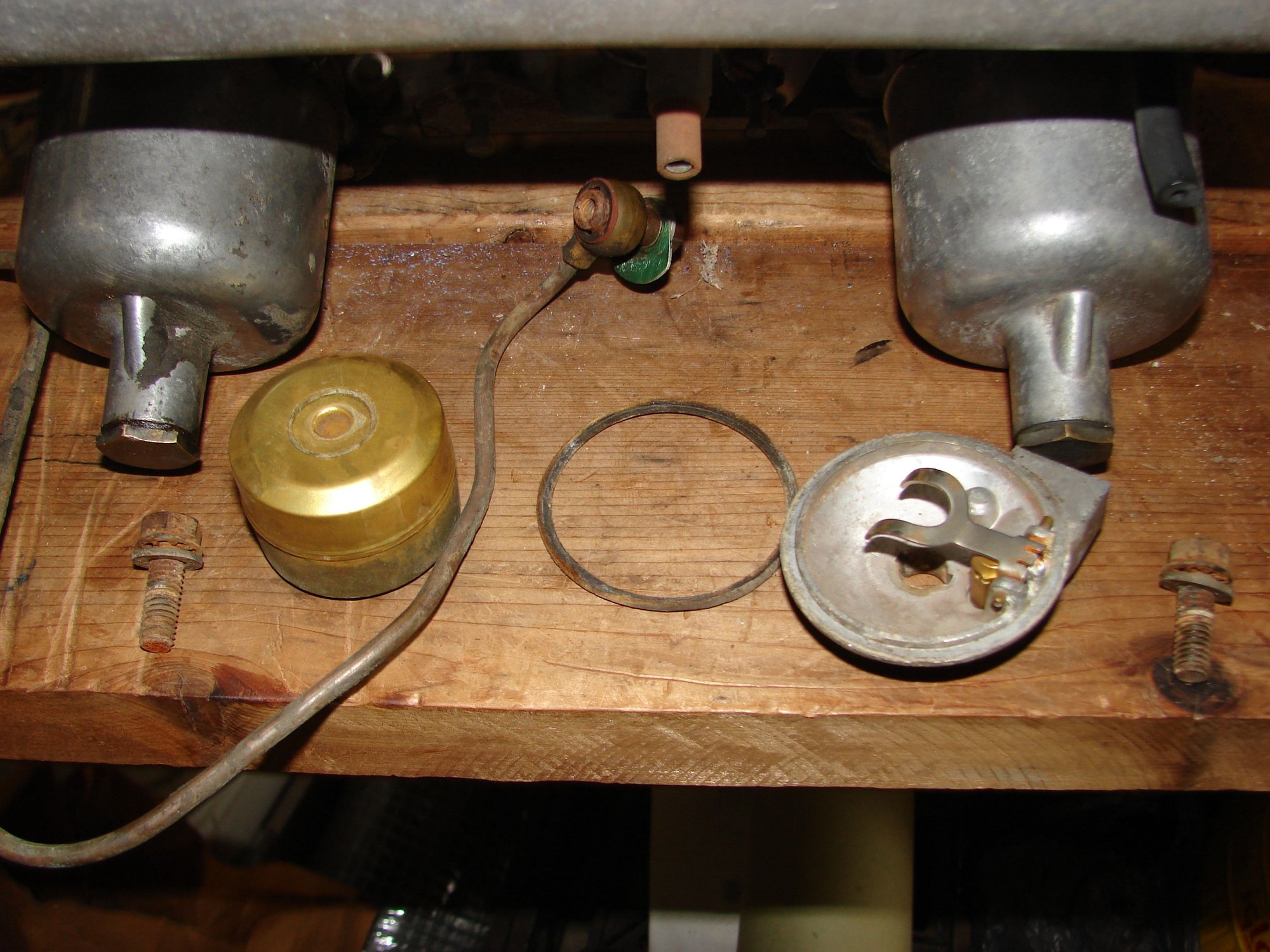

Yesterday the Mk2 intake manifold with carbs arrived. My normal practice is to get a beater example and practice on it before working on my go car. After my car is sorted out this intake can be sold with the carbs cleaned and rebuilt. The starter carb is incomplete on this but a junk starter carb is on the way. I took the front fuel bowl apart for practice because given the help from this forum it is a likely source of my fuel overflow problem. The black floats for Blue340 are in hand now. and I am ready to install both of them. I broke down and ordered a set of King Dick W combination and sockets. Per the advice above a Uni-Syn is on the way too.
