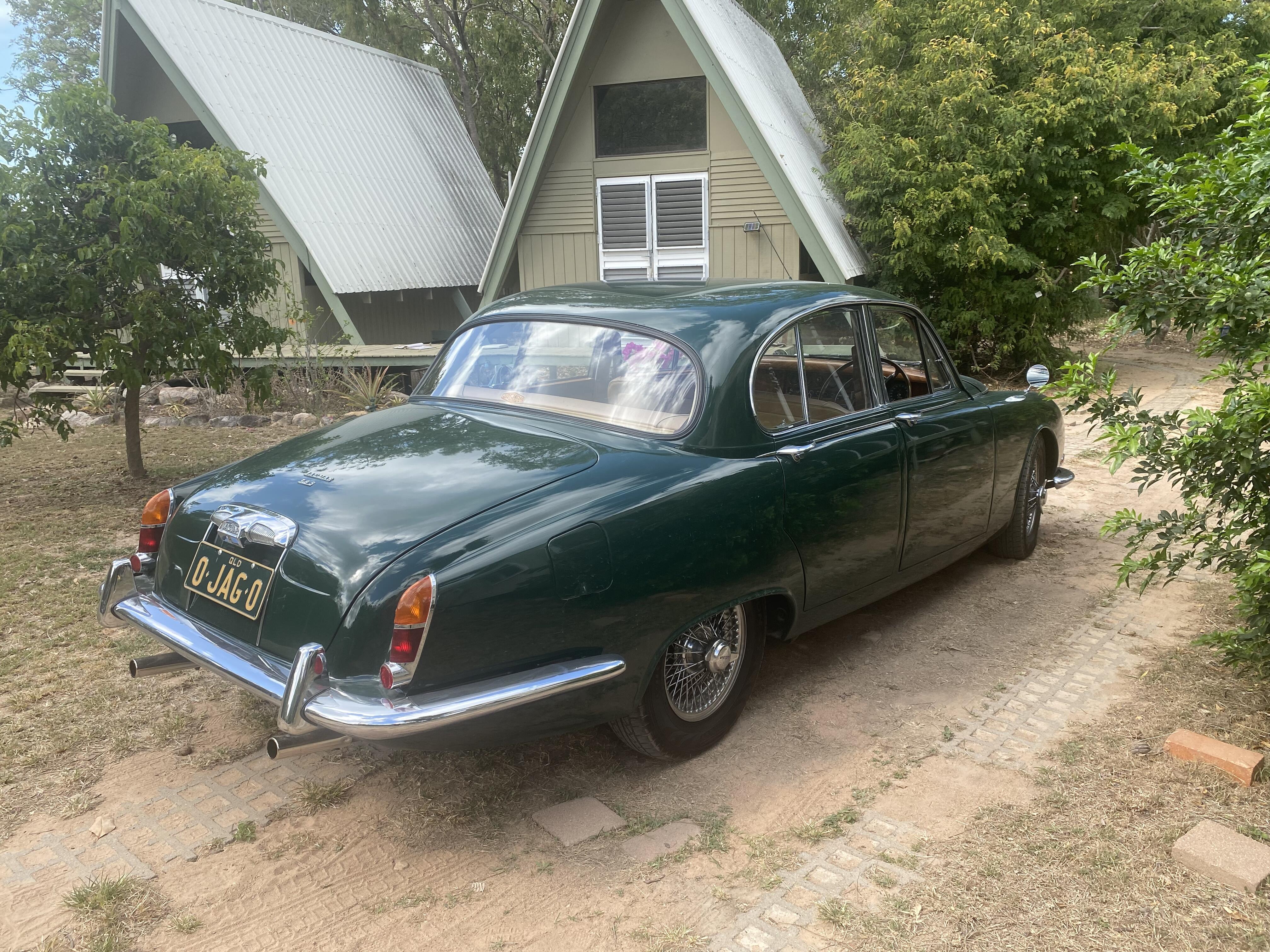

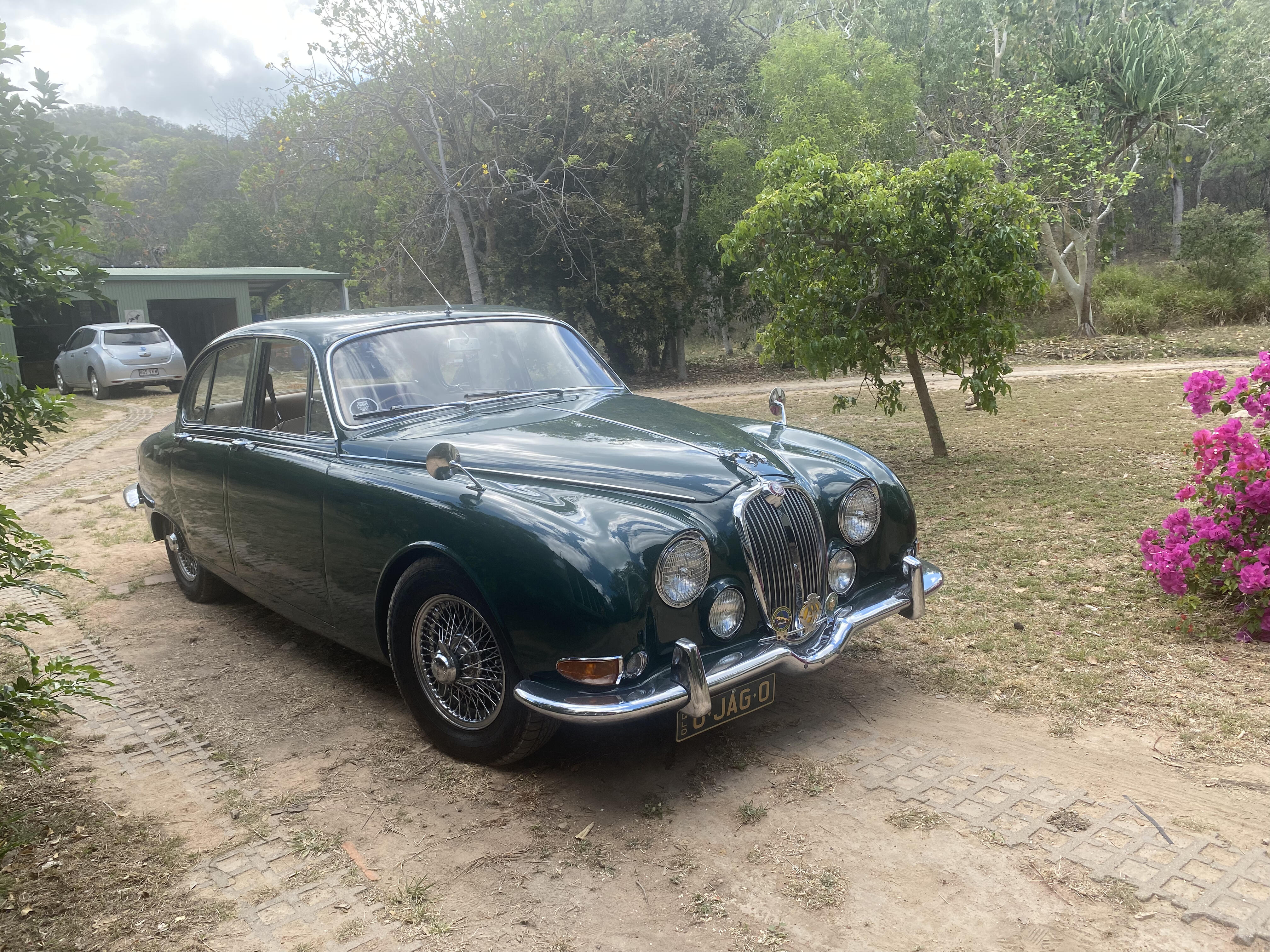

I forgot that I had pics of the car on my phone. It’s a bit late now but I thought I’d post them up anyway.
