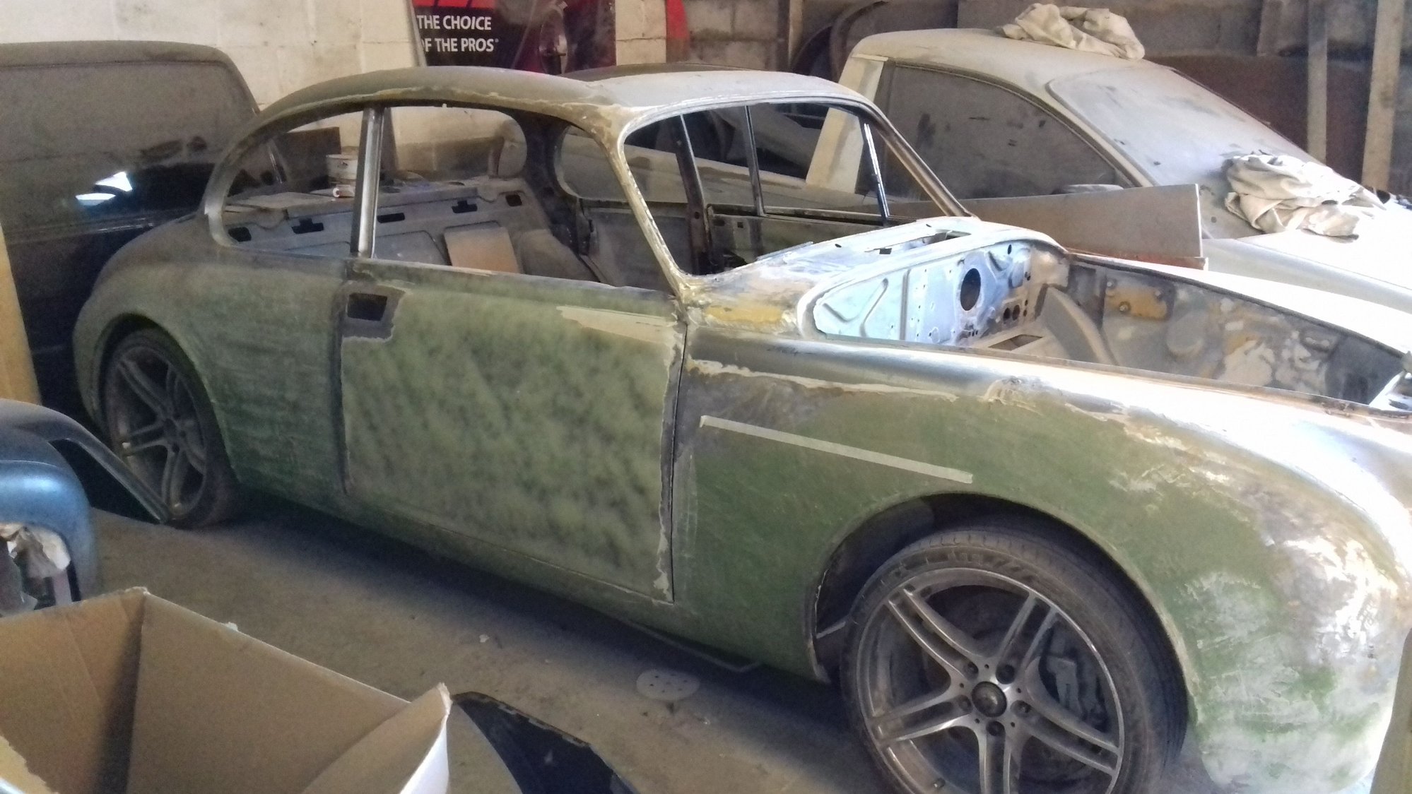

only the very late xjs had out board discs,and yes the inboard discs are solid on the IRS
and don't think you can do much to them,
I have just the HA4 solid axel,put in an LSD and discs on the rear will be 320 with 4 pots,
front will be 350 with 6 pots, running 19" wheels
