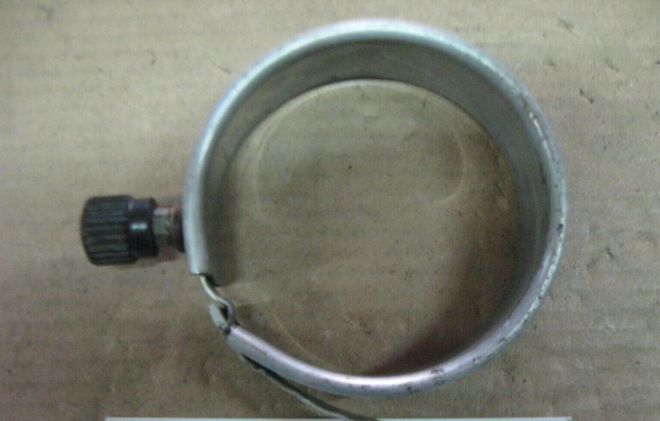

Yes. Most people think that the dampers run at approx underbonnet temperature. They don't. They run damn cold which is why the Mini suffered the carb freezing/icing issue. Venturi effect. And so came the electric tea cozy to keep the carbs hot enough.
SU heater ring. (tea cosy)

"Venturi effect" + Joule-Thomson throttling + latent heat to evaporate fuel (to be an anorak). In fact, a carburettor is rather a nice little refrigerator. Ice cream one side of the engine and hot dogs on the other.
Old Jul 17, 2022 | 12:13 PM
Glyn M Ruck's Avatar
Posts: 5,546
Likes: 1,495
Indeed ~ LOL! Tea Cozy above. I did not think I would find a Pic. There were many iterations of how people mounted them. Some rather amusing.

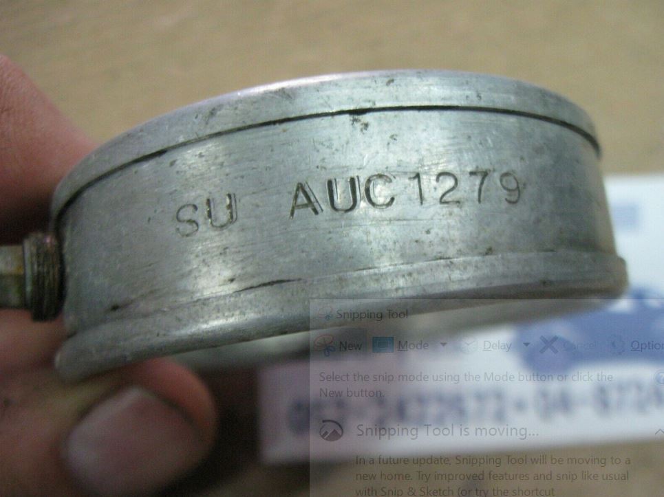

I have one of those "tea cosy" rings, came in a box of misc SU carbs I got at a garage sale. I wondered what the original application was. It also had an Otter switch with a heating element around it, not sure what that was for.

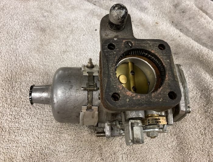

The carb I had with the "tea cosy" and spacer plate with Otter switch. I'd never seen one before.

I too have never seen before in the flesh. Only pictures & I did not know what it was. (Otter switch & gubbins)

These heaters were used in the late 50's, early 60's as diesel engine fuel heaters.
