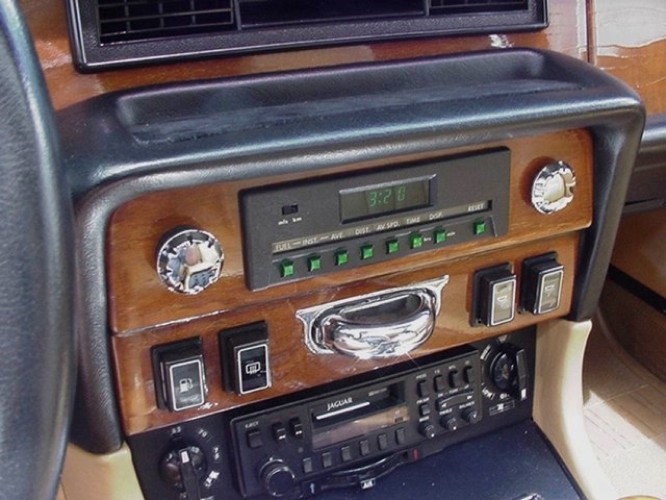

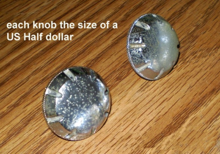

I had two 1964 metal knobs rechromed in 2012 for my XJ-6 and it cost around $70.00 including shipping back & forth. The knobs were badly pitted, but the business fixed them and delivered two pieces of art.
