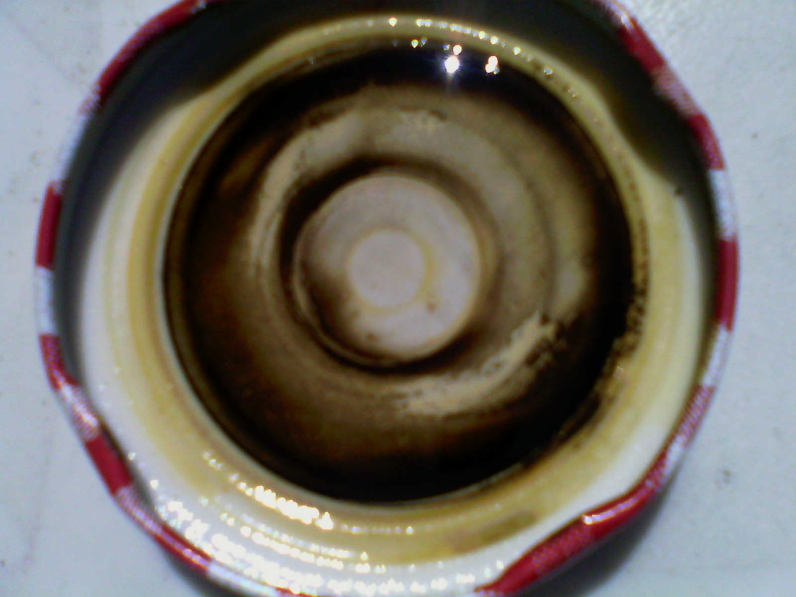

Engaged the advice and took a magnet to a glass jar sample of the gear oil.
The magnet was placed atop the steep cap to magnetize that area, and the jar turned upside down so an particles in solution might settle to the upside down top.
Next day, the cap was removed, and there was some very, very fine particulate matter on the cap.
Normal wear?
Normal wear?
