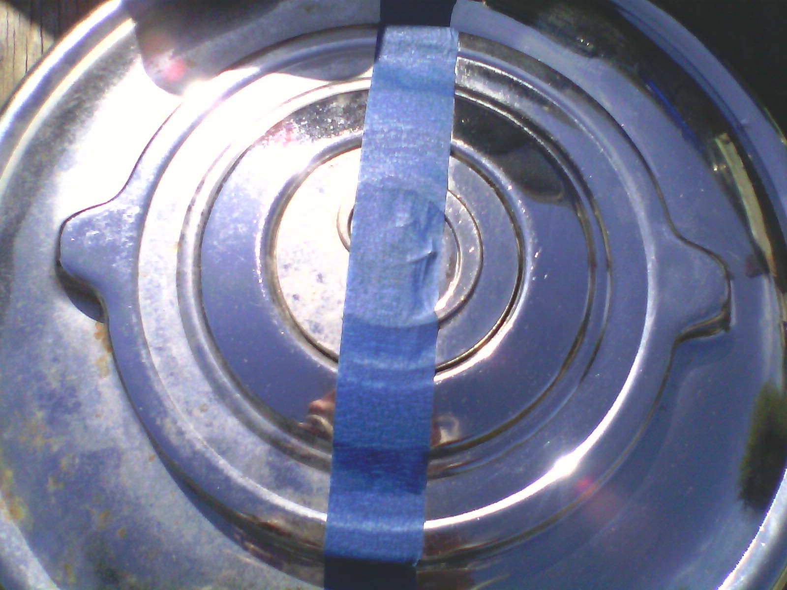

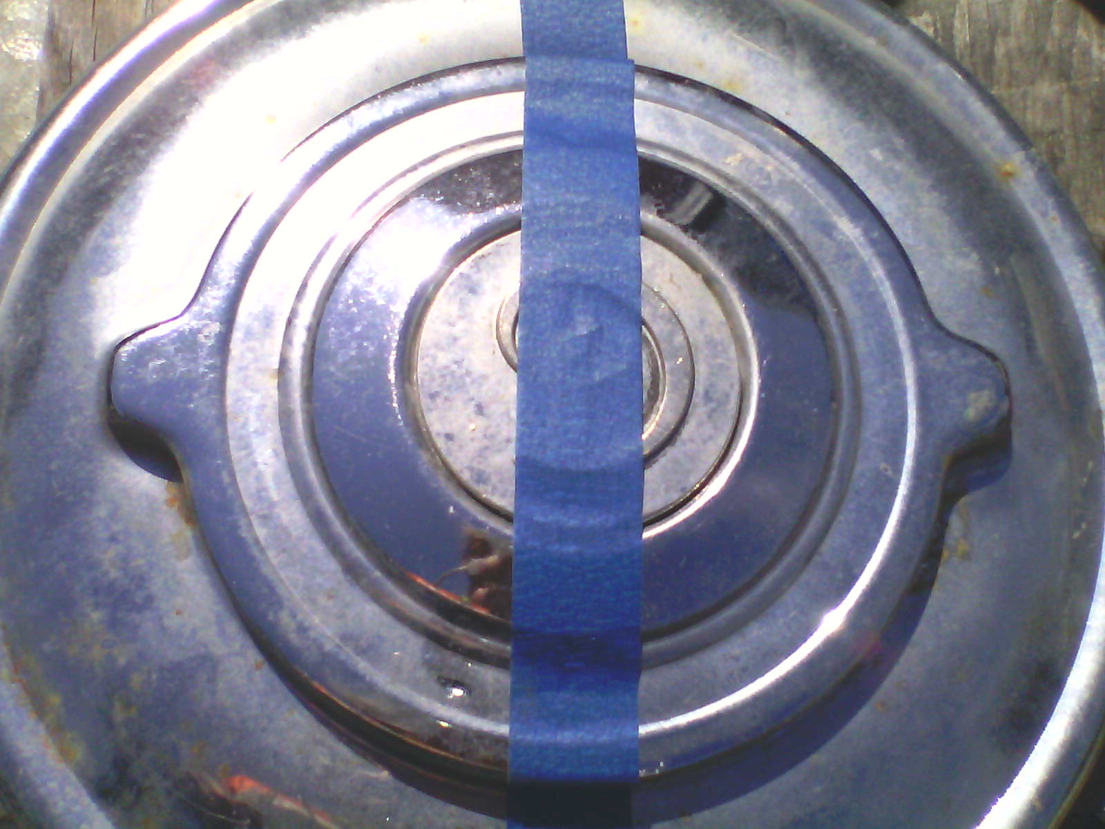

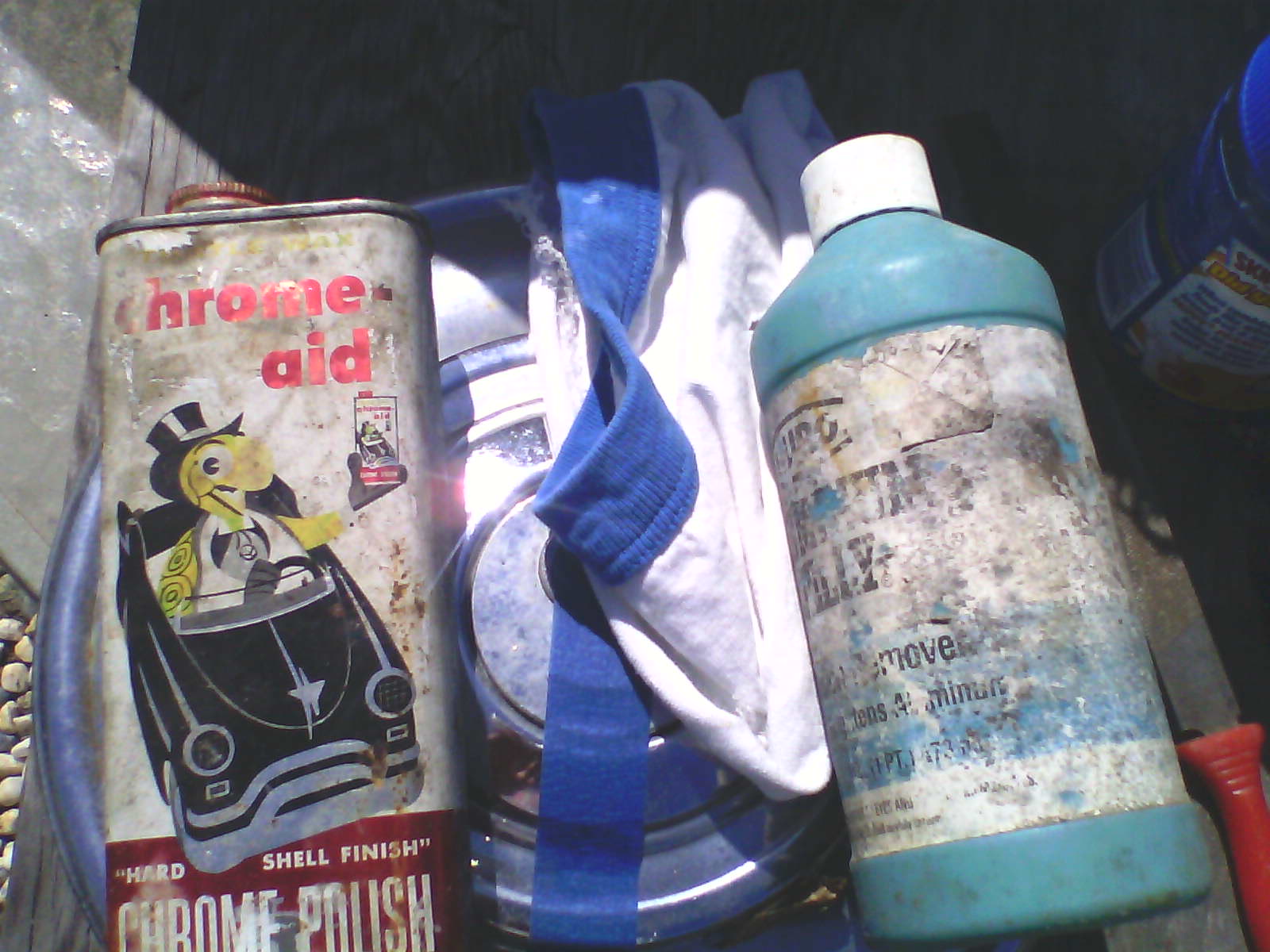

The hubcaps are being cleaned. There's a bit of rust and a dull, dingy look to them.
I took a hubcap and split the sides with blue tape.
The left side will be cleaned with Turtle Wax Crome Cleaner; the right side with Duro Aluminum jelly.
Both sides will be cleaned with an old cloth: a separate cloth for each side re
The Aluminum jelly was used first on the right side.
Pictures below

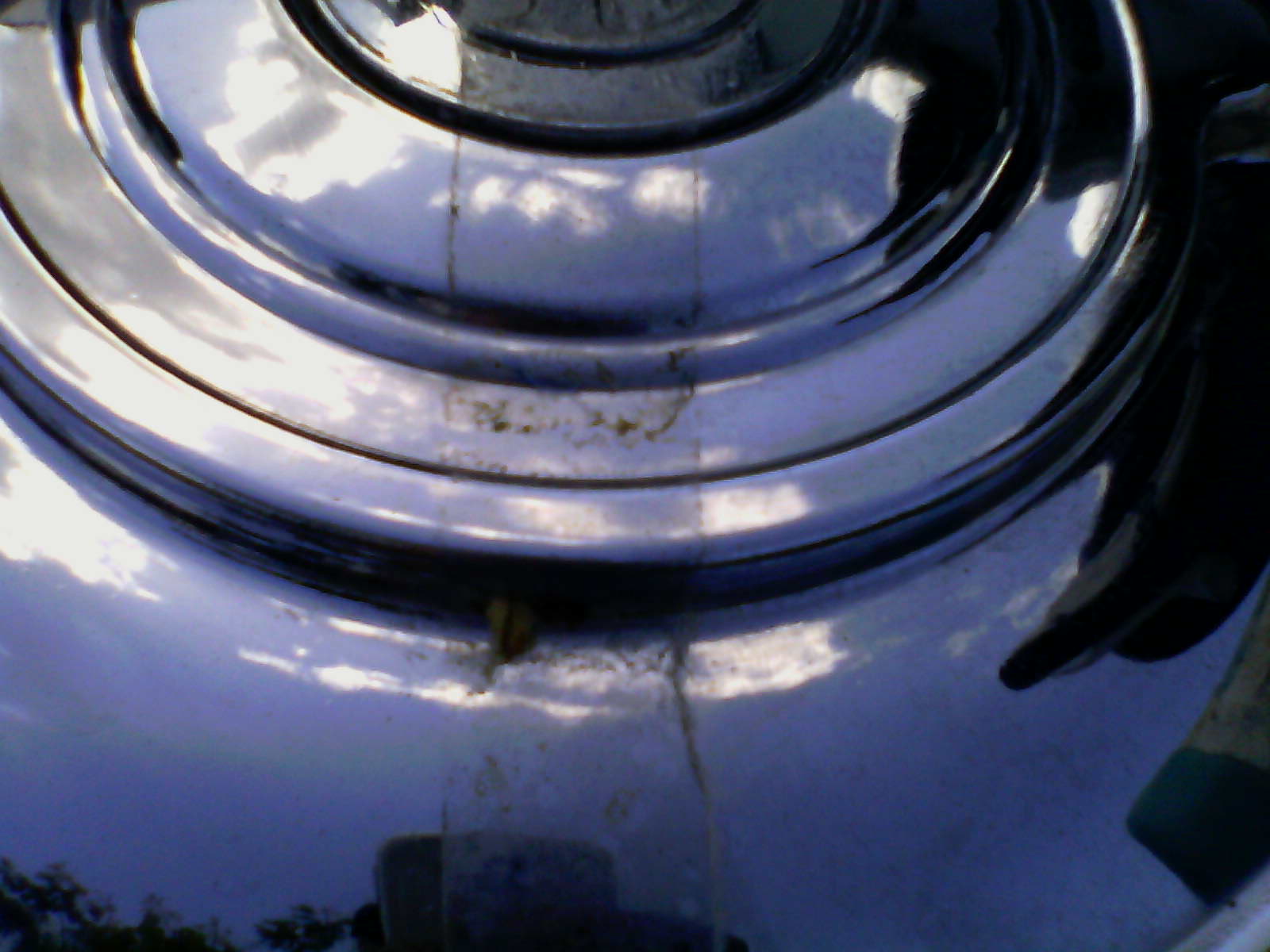

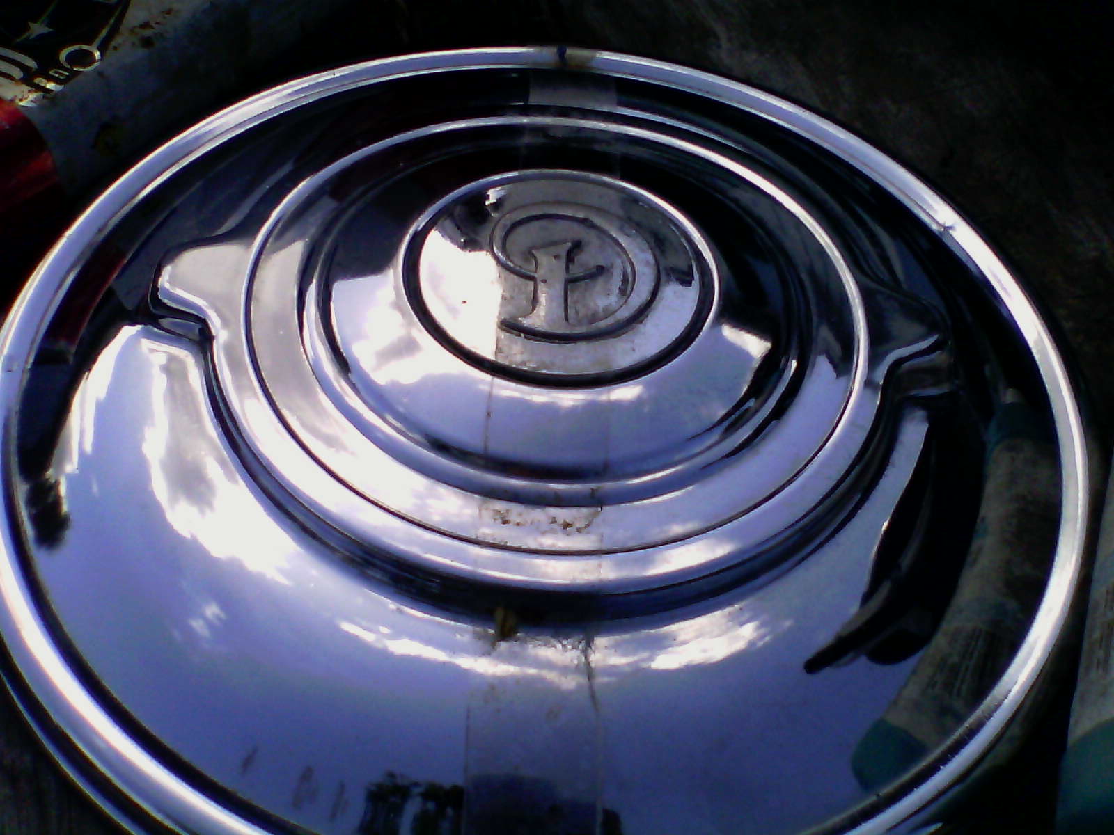

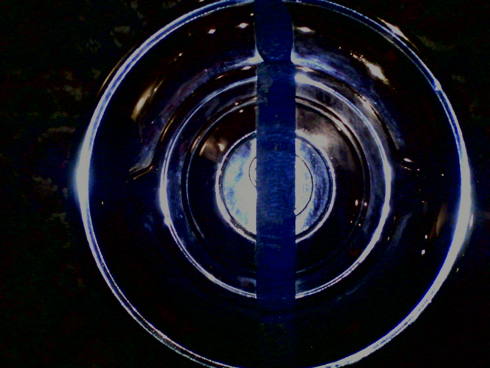

Here's the next set of pics.
The first pic is of the the second half of the first hubcap.
( The second pic is the side by side comparison. )
The third pic is the first side of the second hubcap.
I saw a difference between the two compounds utilized...
Will try the coke and aluminum foil.
Sounds fun!

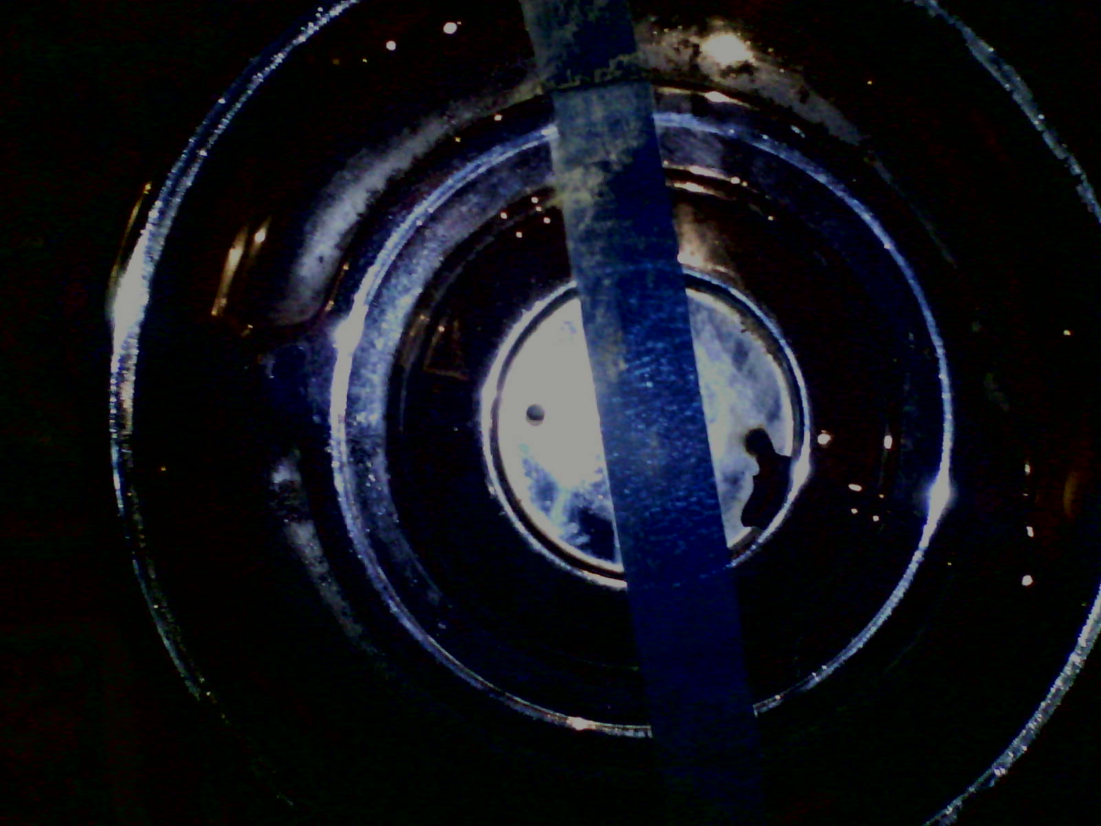

Old Apr 17, 2017 | 04:14 PM
1964Daimler's Avatar
Joined: Jun 2015
Posts: 203
Likes: 12
Did give it a go with the DIET Coke and aluminum foil.
Yes, it does remove the built on rust rather well!
The foil tends to clump up into a crinkly ball and becomes difficult to work with.
But the combination does indeed remove the rust.
Not sure about a better shine than royal jelly or turtle wax, though.
But the combination does seem to better at removing built-up rust.
MIGHT consider dunking a hubcap in Diet coke and letting it set overnight to see what happens....
Concerned that such a duration in the liquid might eat away at the chrome.

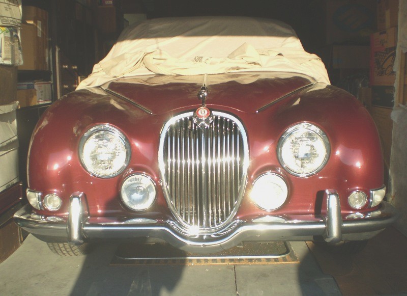

Old Apr 18, 2017 | 07:30 AM
Jose's Avatar
Posts: 9,139
Likes: 2,662
redtriangle:
who me? haha! check the chrome in my S type after the 3M-BRASSO polish

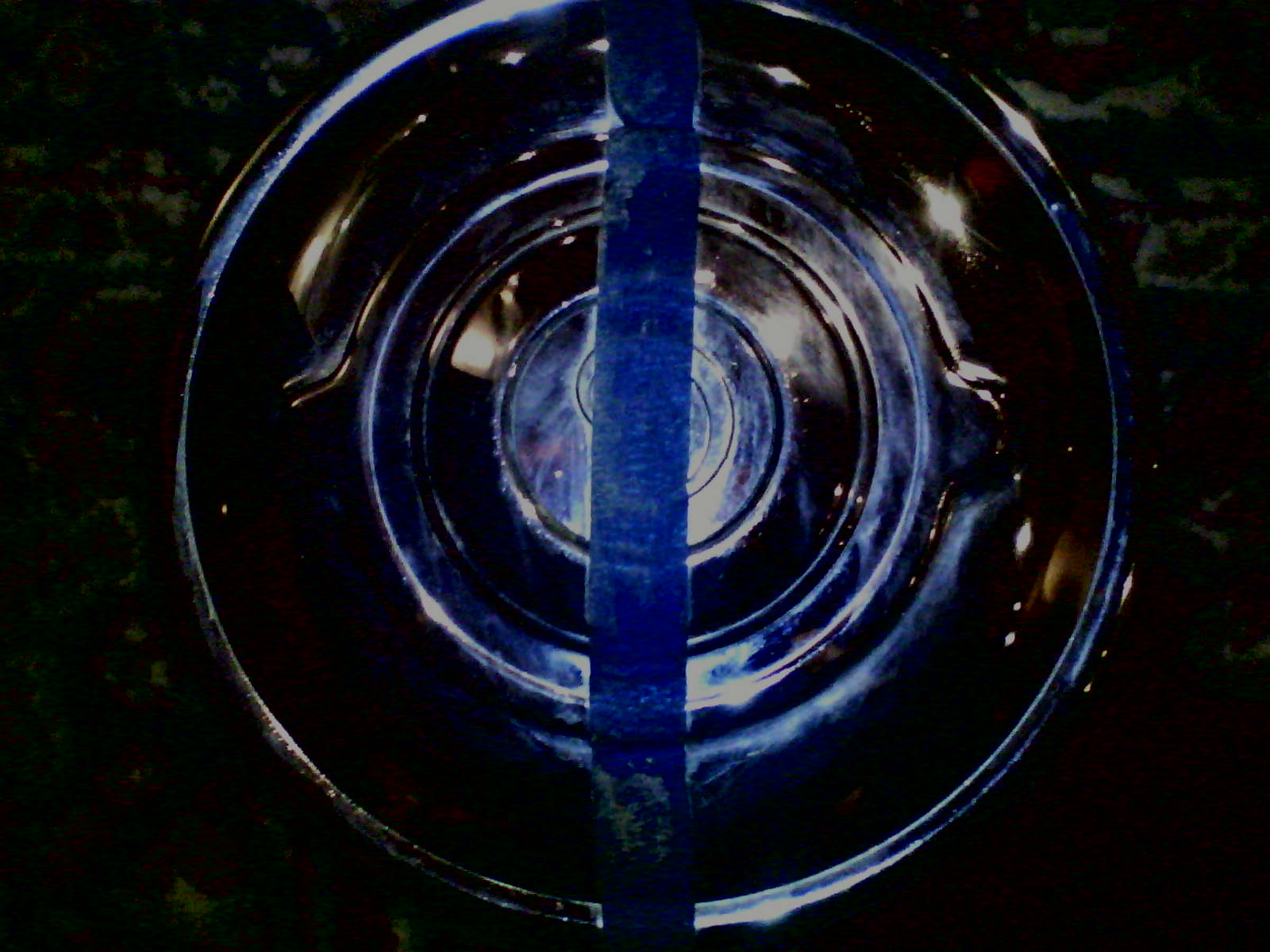

Here's the side-by-side of the turtle wax and aluminum jelly AFTER the tape is removed.
Both did well, in my opinion, but the Turtle wax was just a smidgen better.

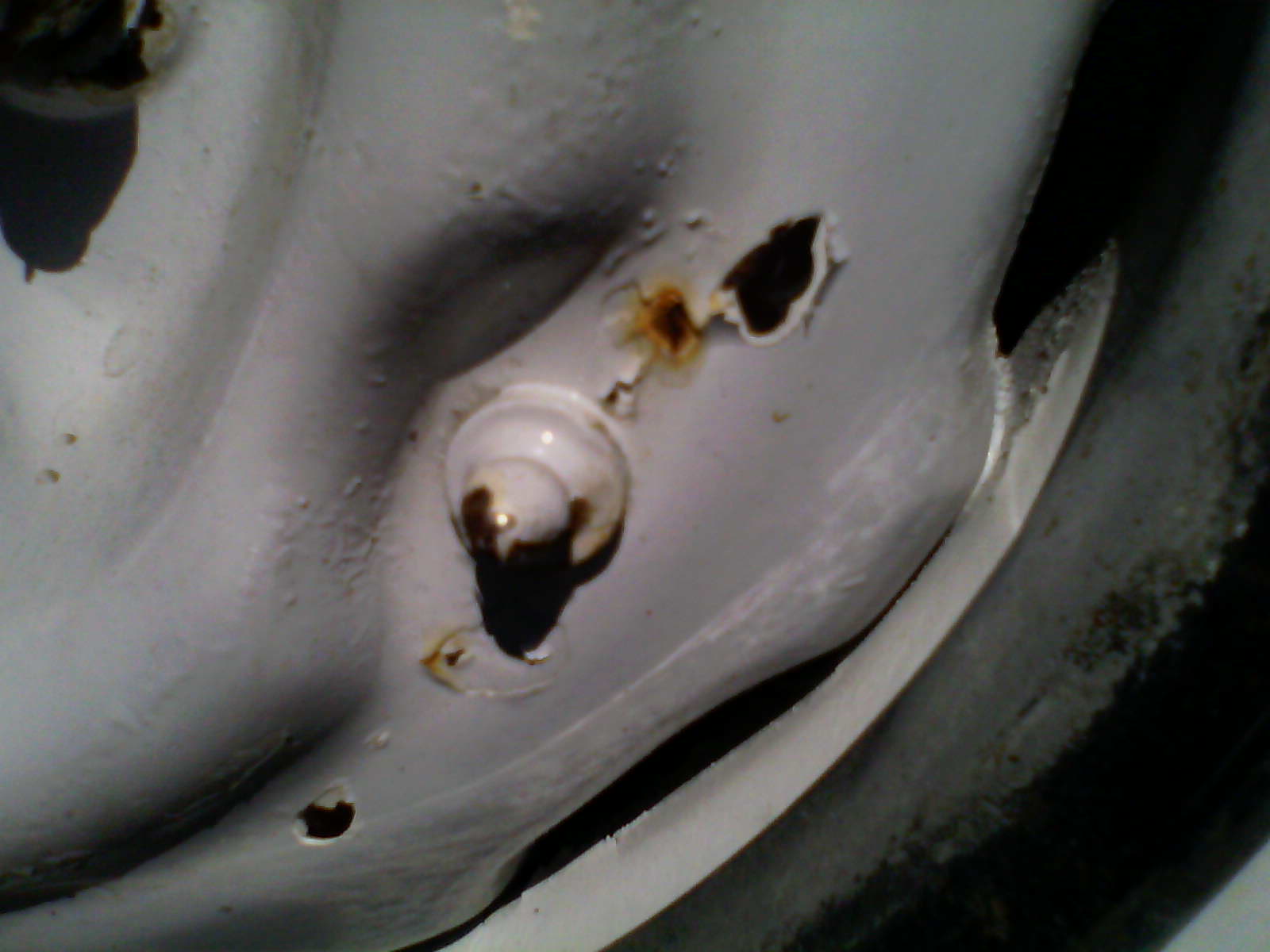

The last picture is one of the three "holding pegs" where the hubcap is placed.
How does one remove a hubcap here without gouging a dig into the paint on the rim?

And here are pictures of the diet coke and aluminum foil ( Right side of hubcap only )
Yes, the combination does indeed remove the rust well!
But it takes a bit more effort , but that may be due to the rust accumulation...
you wrap a rope or cord around the hubcap and pull it. Back in the 1950's / 1960's they used to sell a nylon rope with two handles for that purpose. I think Oldsmobiles, Buicks, and Pontiacs used to have a two-handle hubcap puller cord in their jack kit. I remember my father's Oldsmobile 88 had one.
something like the image below but with two handles.
Attached Thumbnails Chrome Cleaning - Side By Side Comparison-rope%3Dhandle.jpg
