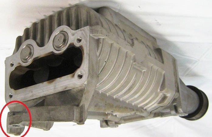

Yes slotting the mounting hole helps a LOT! The problem is that hole is invisible when the SC in mounted on the engine because the SC elbow is directly above it. So 2 big problems. First getting that bolt out. Not easy but possible. Next is the biggest one. Getting the mounting bolt back in that hole. Again it is possible but a royal pain!
Yes you can remove the SC elbow but that is unnecessary and just extra work for nothing. Keep it together as an assembly. It's MUCH easy that way.
I did not listen and when I replaced the under SC hose on my old 2005 STR I did not slot that. But I had a vacuum leak and had to go back in and remove the SC a second time. This time I did slot that hole and it was WAY easier to install. The trick is when that hole is slotted you don't need to remove that bolt at all. Just back it off and then slide the SC forward and off. Same when re-reinstalling it. No need to thread the bolt in. It's already started and now the SC will self center when you align the bolt and slotted hole.
Here is the back of the SC where the elbow attaches. Blocks access to that screw pretty good!
This mod was from the legendary "Brutal" a JLR tech who posted on this forum for years.
