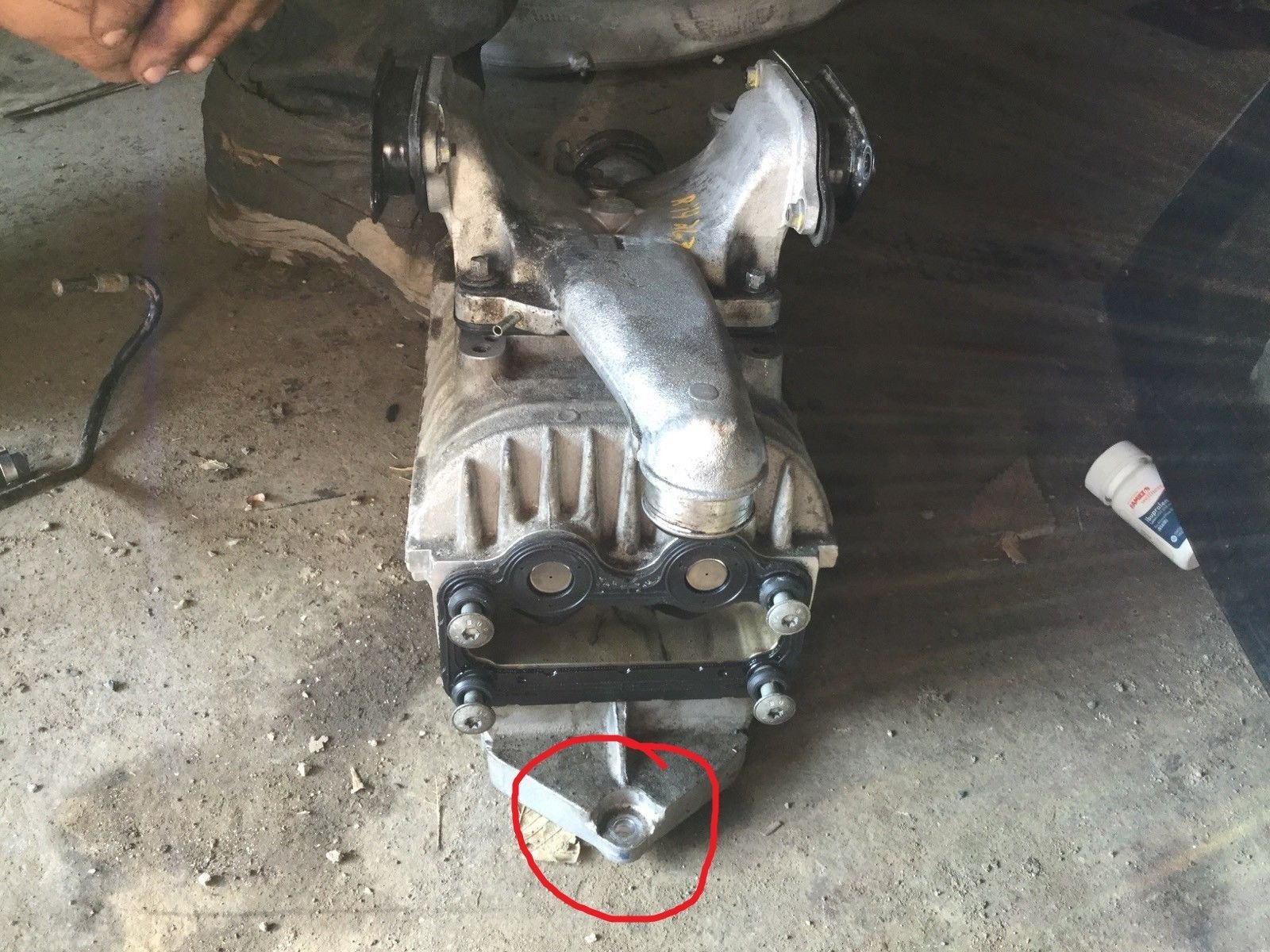

Hello all! Ive searched all over, purchased a Jaguar manual and simply cant find a single post to help me.
I have a 2009 XF 4.2 supercharged. The supercharger is grinding and I purchased a replacement used one, but cant figure out a way to remove the rear bolt that holds down the supercharger.
There is an elbow that is on top of it that is held on by 4 bolts, but as far as I can tell, there is no way to remove the two lower bolts with everything being in the way. The bolt that is holding the supercharger down is directly underneath it and cant even be seen unless this elbow is removed.
Attaching a picture to show the bolt that I need help unbolting. Any help is much appreciated. Thank you in advance!

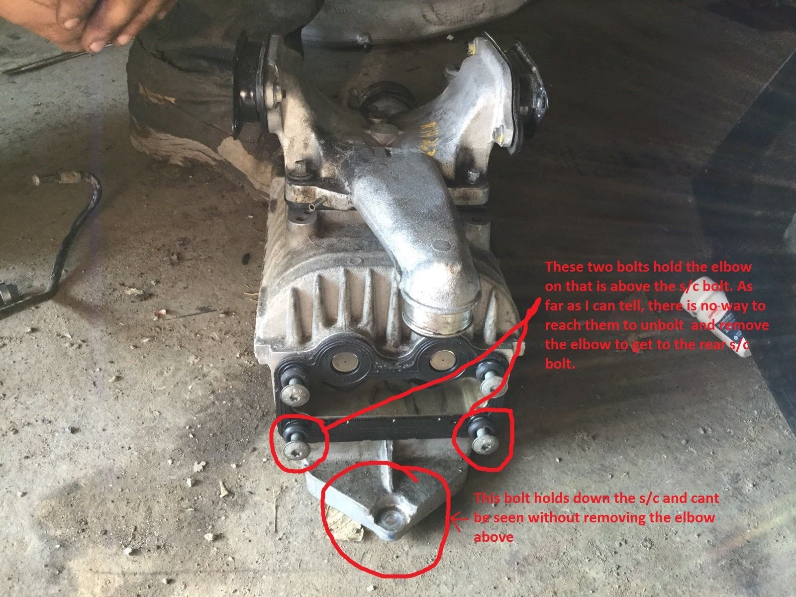

Here is the same picture with more details.

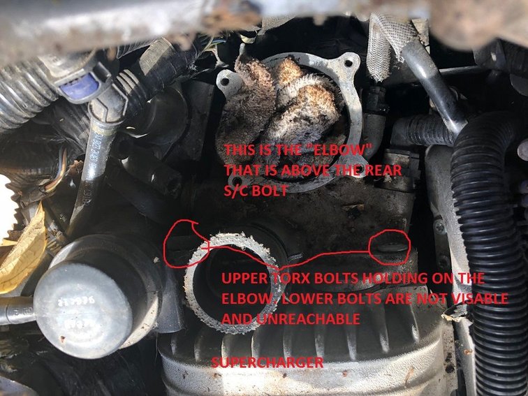

Last photo. This is the supercharger still in the engine bay.

The only way to get to this bolt is to remove egr valve and from there you can reach bolt with a short 10 mm ratchet spanner. There also 2 bolts side mounted under side of the elbow. A little tip once you get it off is cut out slot in said bolt hole. Helps for putting back in. Hope this helps..
