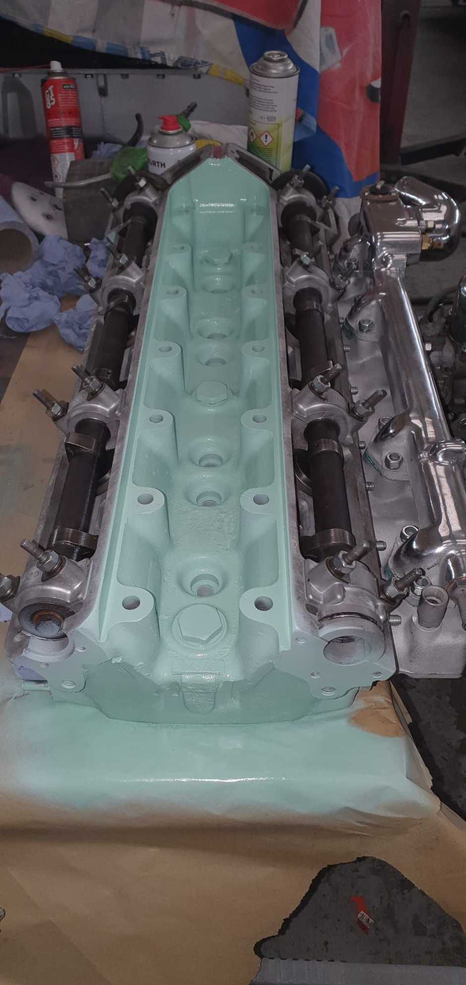

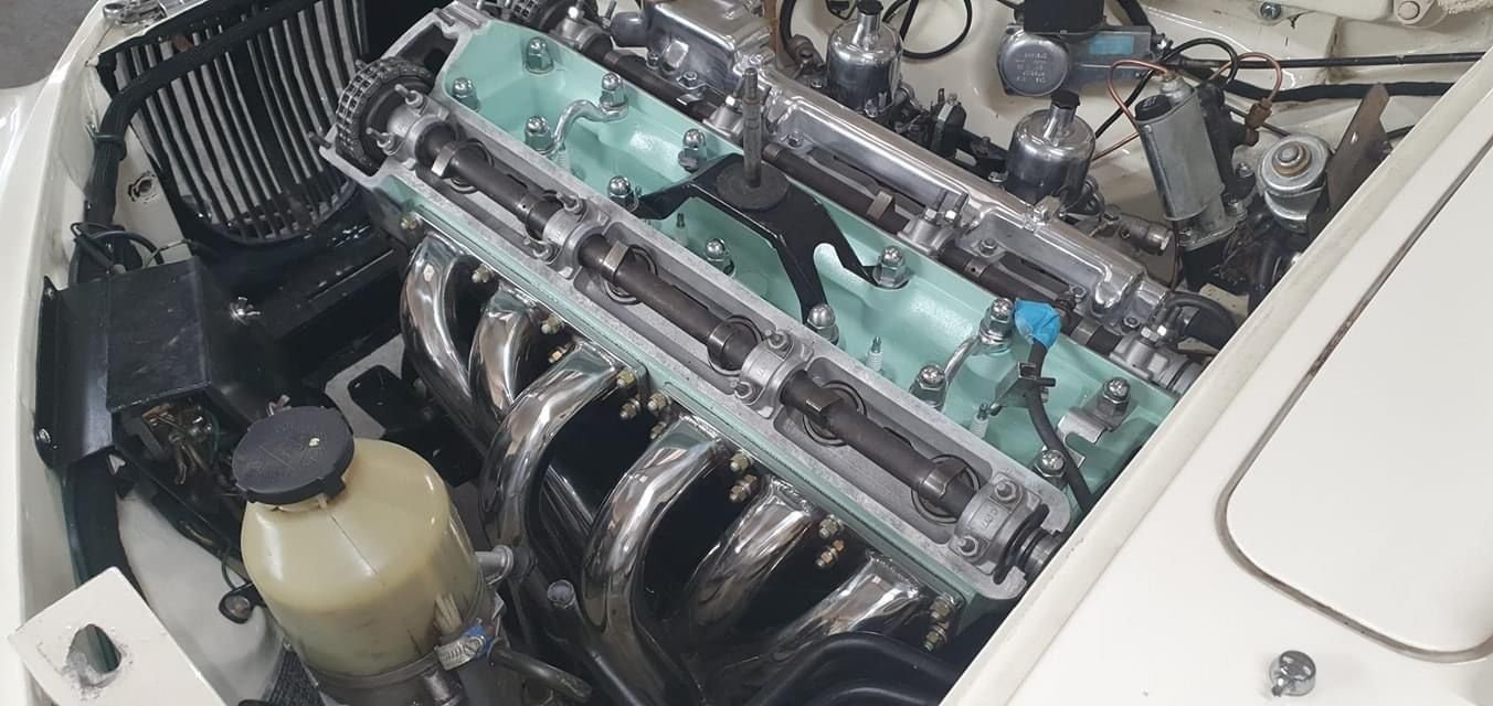

I had my 3.4 engine rebuilt last year by Thruxton Jaguar. With the exception of the crank, everything that moved in the engine was renewed. Flywheel lightened, big inlet valves, polished and ported - runs like a Swiss watch, and is well up on standard power. That cost be just under £12k including a head skim and water galleries welded.

Nice, that is in pounds which is about $15,000 US so probably with a new crank, it still a great value as it seems CJ would want about 20K, but Vintage Jag works here in the US was doing similar work for actually around $12,000 US and with $15K or so you could get some nice machine shop upgrades. Both of these and your shop are doing more improved internals for a reasonable cost given Jags are like Datsun Z cars more expensive than American V8's
