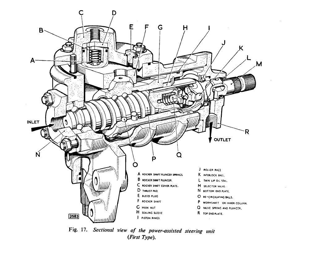

Your car should be fitted with what Jaguar call the "First Type" Power Assisted Steering (There were 3 types fitted as the cars became newer. Burman First Type, Burman Second Type & 67/68 cars Varamatic. (Full name: Bendix Marles Varamatic made under license by Adwest in the UK)

If you don't have a Service Manual/WS Manual.
You can download one here. Don't download the J H HAYNES Manual. Download the first Genuine Jaguar manual. Early units ran at 850 psi later raised to 1000 psi. Ensure your pipework is in good condition both high & low pressure. Cheaper to have pipework made up than genuine. I went genuine because I was chasing concours which I have now achieved ~ 100 points >. Now I can drive & enjoy. I only wanted to have it judged once. My car was not intended to be a trailer queen. If I can't drive it & enjoy it I don't want it.
Forgot to mention above. Be careful not to damage the input shaft seal on the input shaft splines. Wrap splines in cling wrap or similar covered with grease. There was a Churchill tool for the job.
