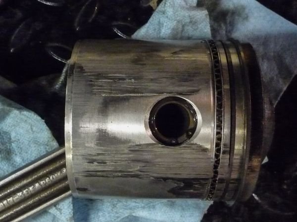

Out of interest. Were you running EFI when you suffered your heat seize?
Most likely, but I can't remember. I did the conversion quite early after I got the car on the road. The biggest reason was the starting carb was poor, and just the way my neighbouhood is laid out. I could start the garage , back it out of the garage and by the time I got the to main road the starting carb would shut off and then the car would stall on me right about when I needed to turn into traffic. It was frustrating to see the gap and the car would die.
Partly also it was the intellectual exercise, I wanted to learn more about EFI and doing a conversion like Megasquirt mean I'd learn a lot - and I did.
Old Sep 14, 2021 | 10:00 AM
  #29
Glyn M Ruck's Avatar
Posts: 5,546
Likes: 1,493
The reason I asked is that the cause of the heat seize could well have been the EFI running too close to stoichiometric. i.e. too lean & expanding the pistons into the bores.
Very common in racing two strokes when on the edge & running into oxygen rich air under trees overhanging the track or just plainly too lean. Pistons would look just like yours did. Bores would have the Nikasil torn off.
Have you any idea what your AF ratio was?

I had tuned it rich at the that point, so probably somewhere between 12.5-13. I had mapped it to only go to 14 under light throttle cruise. At the time I didn't have the VE table fully developed, so I was doing tuning; but had mapped it rich on purpose to prevent it going lean under most conditions.

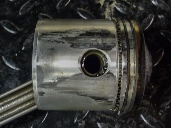

Not the best photos, but here are the two pistons that scuffed. It was cylinders 1 and 4, so those were fed by a different injector, the other 4 pistons were unmarked.

Are those stainless steel sleeves, if they are, that's what caused the scuffing ?
In the real world unless specifically designed as lean burn engines with appropriate clearances etc. etc. your AF Ratio should never go anywhere near 14 to 1 under positive throttle (stoichiometric AF ratio approx 14.5:1 for gasoline/petrol). Certainly not an XK. 11 to 12.5 max should likely be a permanent target AF ratio for max economy & decent running. Those pistons & bores are typical over lean heat seize ~ pistons expanded into bore. An XK should probably produce max power at about 10.5 ~ 12 to 1 reliably on a dyno. Likely nearer the 11 to 1 mark at standard piston to bore clearance. ( guessing from experience.)

Sleeves are steel, not stainless.
As rich as 11:1? Everything I have seen says max power at 12.5 for a gasoline engine. I've not put my car on a chassis dyno and measured power though.

Is that the rearmost cylinder? The twin SU manifold has been accused of providing a slightly weaker mixture to that far end of the engine and the cooling system has similarly been accuses of not cooling it so well. A richer mixture lowers the temperature in the chamber and at around 12.5 (as you stated) gives roughly the highest flame speed and power. Stoichiometric or slightly weaker is good for economy under light throttle or would be if the chamber had a bit more turbulence ..
Try it, Dyno testing is fun. But monitor at least IAT as it has a huge influence & can mislead you. Try & do it all in a couple of hours in stable ambient conditions. Try & find a decent Schenck or similar dyno. These roadside things are junk & float like hell. You might achieve peak power at 12.5 on a modern engine with all it's electronics, ECU, variable length runners, VVT & lift, sophisticated knock sensing & timing control, direct injection, better volumetric efficiency, reduced frictional measures & materials. combustion enhancing techniques, active alternators, higher compression, higher injection pressure & multipulse etc. etc. etc. ad nauseum ~ long list. These are just a few that come to mind, I'm sure I've left plenty out. Modern Mercedes Quadcam V engines with a combo of these achieve peak power at about 12.4 to 1. All these more aggressively used in the AMG's. I'm not considering turbo charging here because it's not a fair comparison. The little Merc 1600 cc V6 engines in their F1 cars have a thermal efficiency of over 51%. Our Jags are likely under half that.
I don't buy 12.5 on an XK with my time spent on dynos on a range of engines both new & oldish. Older designs need more fuel (richer mixture) for peak power. Some older Toyota & Nissan inline 6's I have run gave peak power in the low 11's.

Peter ~ the rear cylinder is no 1.

Sorry, missed the explanation above the photos.
Further to what you wrote on A/F ratio, log type inlet manifolds are not good at achieving a uniform mixture. Fuel sticks to the walls and droplets tend to go straight on most often into the nearest cylinder. In consequence, to avoid problems with a local weak mix, the average A/F has to be more on the rich side.
And I was tired when I typed the numbers last night and got it wrong. The scored pistons were #6 and 2.
