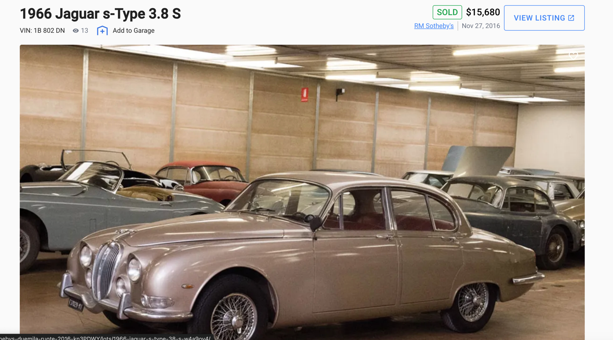

Saw the Golden Sand car again today but couldn't do the test drive because of really awful weather. Going back on Saturday for a drive.
It is in great condition, went round it with my magnet and all I can see/get to is solid. Wood is in great condition, engine started straight away (it was cold). General condition inside and out is better than the other car but as already mentioned this is a collectors car and the other has been driven. Door rubbers are not really rubber anymore but that is a minor detail.
It is missing its ID plate. When I asked the dealer he said that the owner does have it. I asked about the repeaters and apparently that is/was law in Italy (although it looks like a US import, need to do some more research) where the car was imported from 10 years ago. There the car was also part of a huge collection of cars owner by some dubious Italian "businessman" who went to jail and his collection was actioned by Southerby's (nice story anyway).
There is €4K difference in the asking price of the cars and I am pretty sure I can get the private seller of the maintained car down to €20K. I could probably get the car in the same condition in and out with the €5K. Such a shame the headlining has completely let go. Taking out the windscreen seems like a whole lot of pain and expense.
I need to go back and check out the maintained car again. I am going to take my time. If I need to wait for another one I will.
Just did some more research (well googled):
So part of the story matches.
I found it on the register. 1B 80311 DN

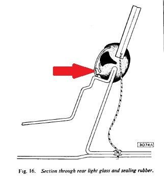

The only answer to the rear screen chrome cover is correct shaping and Loctite 480 & plenty of tape for a few days. It goes into a groove glass side but caps over the rubber body side. The windscreen is dead easy to take in and out. You have to take the windscreen out anyway because the Union Cloth lining has to go into the window rebate under the rubber or you end up with a mess as shown below.
Rear screen chrome PITA:

Glyn, that's interesting I had never noticed that the chrome only went into one groove in the rubber before. When my car is out of winter storage I'll have to post a photo of the seal, it clearly looks too large and bulges out at the corners.

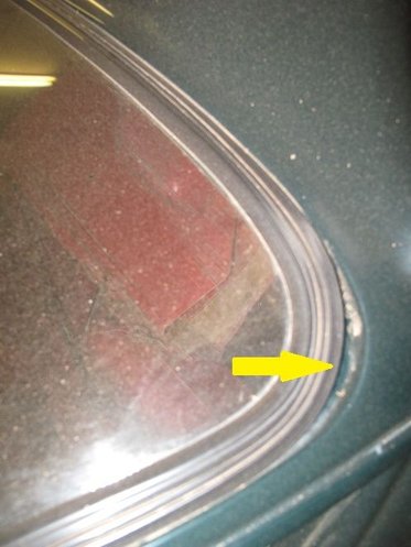

JB ~ there are some bad rear window seals out there and of course if you have a heated rear screen it takes a different seal as the glass is thicker. Loctite 480 does a brilliant job. Some people recommend Sikaflex. I found it a disaster.
I finally used COH Baines seals. They are a perfect fit both back & front. Dumped the others in the trash. LOCTITE® 480™ is a rubber toughened adhesive with increased flexibility and peel strength. It is expensive here but worth every cent.
