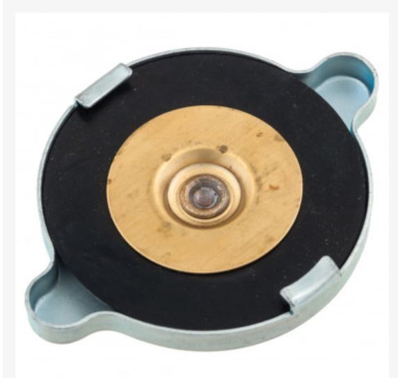

Those caps have been out of stock for a while. I got a new one from Barratts. You could modify a standard radiator cap to do the job. It only needs to seal around the top.

Here you go.
https://www.ebay.co.uk/itm/Stainless...-/163517563046

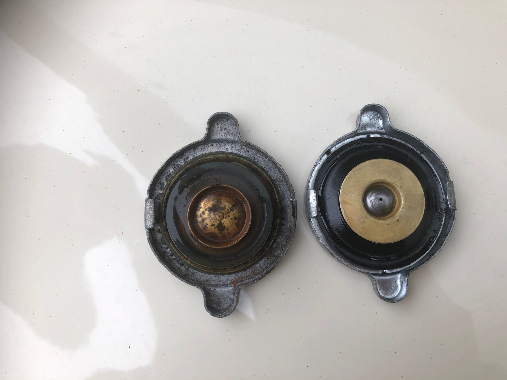

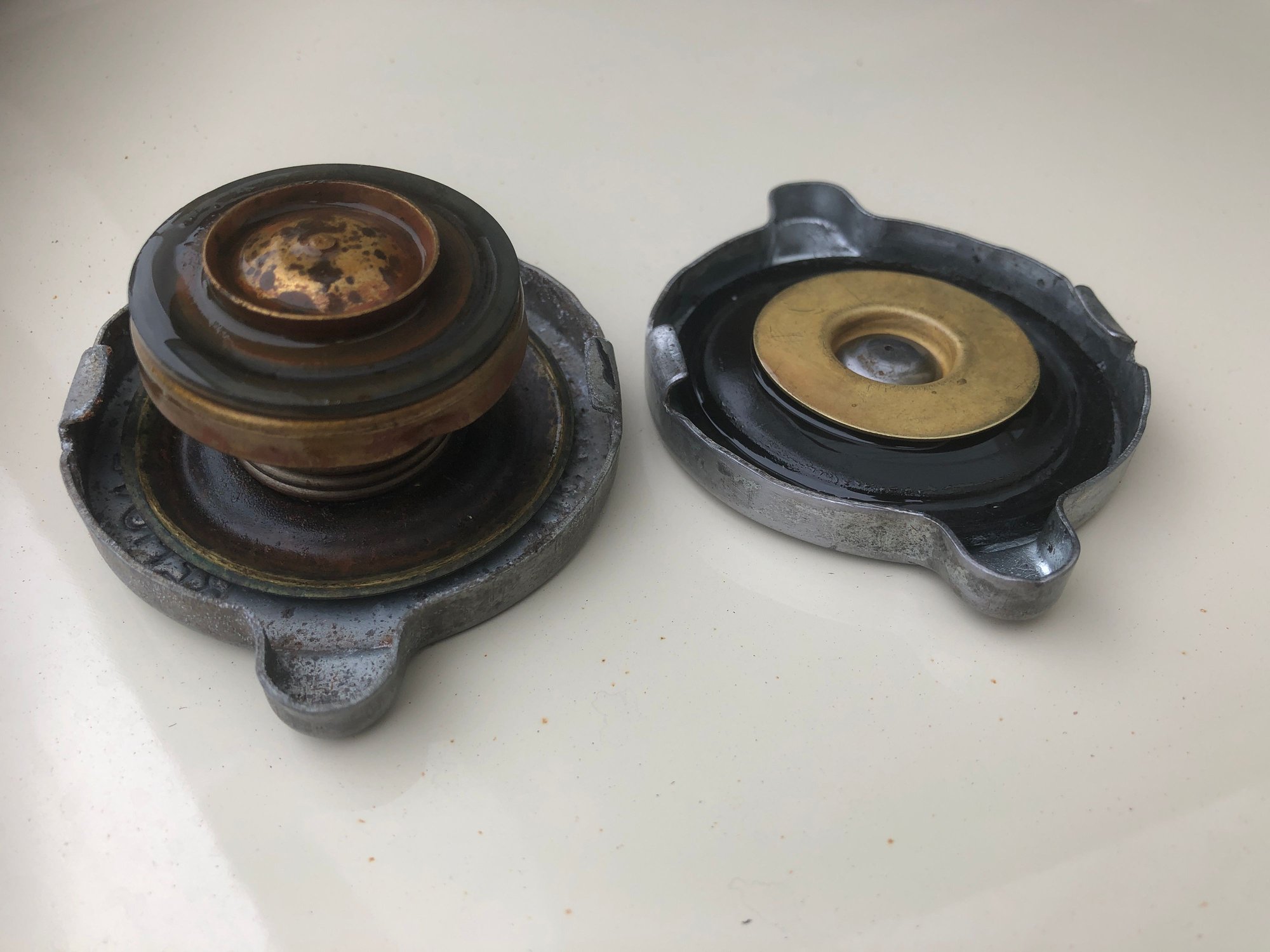

Some more photos of the cap and some next to the radiator cap showing the difference. When you buy one make sure it is vented. The original has a small pin hole in the top if not you will get a vacuum build up in the system which might impair the workings of the hydraulic system.

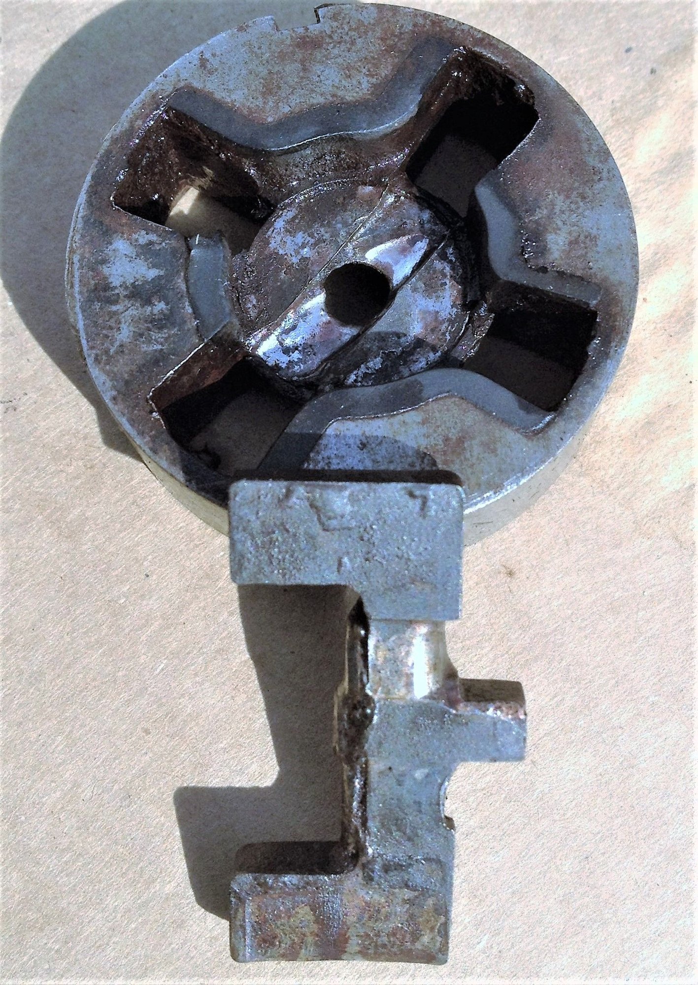

This is my old one in a photo (I have not found it yet though) compared to the newer one I was able to find a couple of years ago. As you can see it is a metal ring with a cross cut from the middle which is rubber bonded. The old ones tend to wear out the rubber and obviously the worse the wear the quicker they wear so eventually you get metal to metal with wear on the driving dogs that sit in the cross.
Even with this wear I did not find the pump made a noise and it still worked but I did have a problem with my PAS pump so swapped it out for a spare I had and whilst doing so found this damage on the dog and ring. I bought a couple of these rings and driving dogs from a guy who refurbished the old generators and he had a pile of PAS pumps lying around which he did not have any use for so was selling them off. I think I paid £20 each and made sure I bought two. In hind sight I should have bought everything he had at the time but there you go.
New PAS coupling compared to the old worn one.
Old PAS coupling showing the damage to the driving dog caused by the wearing away of the rubber insert.

The rubber mount is not to keep things quiet, but to cushion the uneven load of the pump on the drive dog.
You can clearly see what happens to the steel once the rubber is worn out on steel to steel contact.
XK's Unlimited made an alternator conversion and the power steering would just stop working because the conversion drive was just steel on steel.
It would eventually just wear and twist right off.
