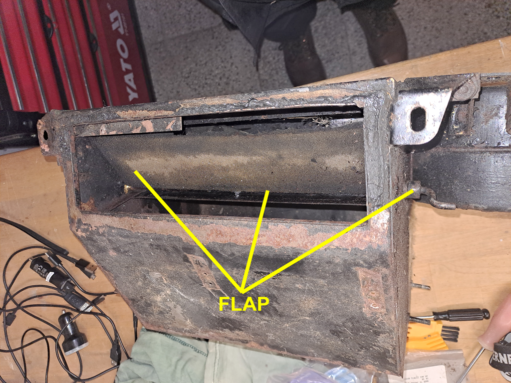

Does anyone know, please, how to get this flap out of the heater body in a non-destructive way? So how to pull out the rod that turns the flap? Thanks.

I just went through this with my 420. Assuming yours is the same...
The end of the rod that you can't see had a bracket brazed to it. I used my MAPP gas torch to heat it up and pull it off.
The flap is brazed to the rod and if you heat it up with a gas torch you can should be able to work it free. I could not sufficiently heat the entire length of the rod to free it. In the end I had to cut it out.

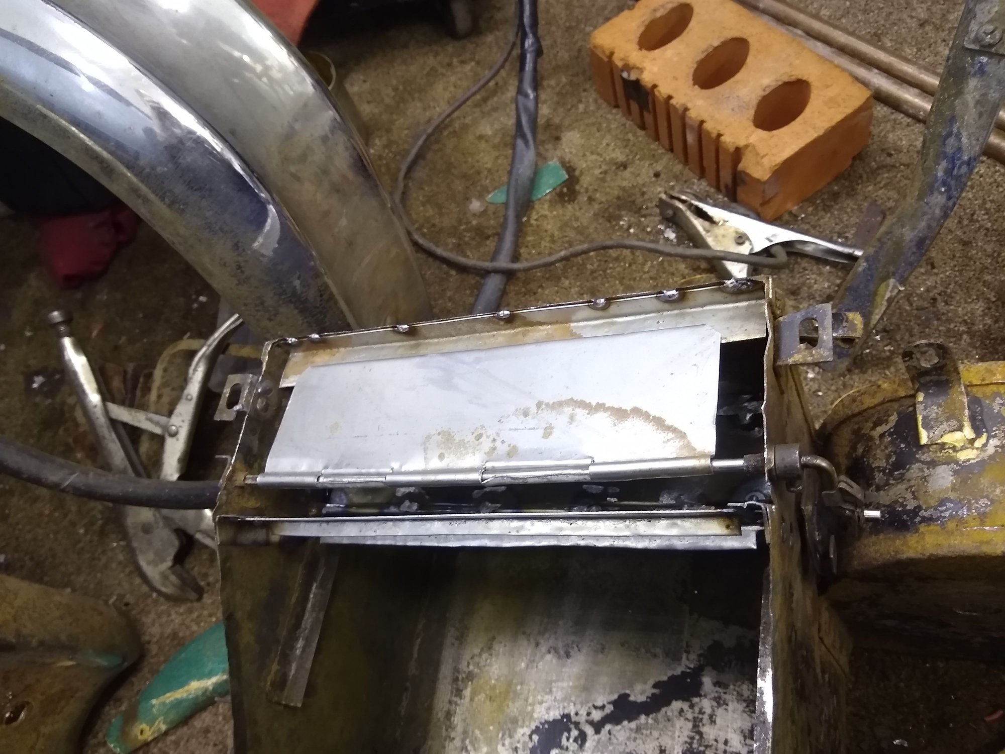

I had a similar issue when I rebuilt mine, I made some new flaps in the end, my heater was totally rotten and in the end I fitted it with a large fan and heater matrix from a modern car. I've not tested it yet but i'm hoping it will be a lot better than standard.

Thanks. I thought it would be like that. I will probably go the same way,
I'm just afraid that it is soldered with brass and it will be harder to heat up. At worst, I'll cut it out and make a new rod.

I ground the brazing down using a power file like this I https://www.toolstation.com/black-de...E&gclsrc=aw.ds
I then made a new flap as mine was rotten.

Solved. Somewhere in the back of my mind I assumed there must be a non-destructive easy way. And is. I heated both ends of the rod to a red color using a propane butane torch. This burned off the rust in both the hole and the rod. I sprayed it with rust remover and reheated it after a few hours. I can already turn the flap with one finger. Tomorrow I will repeat the process and lubricate with WD. I think this could be a happy ending for this little thing. And all that's left is the rest of the car
