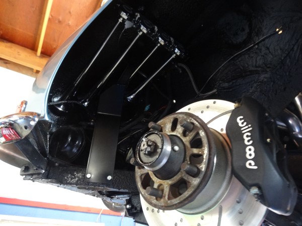

There are Wilwood 4 piston better quality brake kits for these sedans that work very well as I have made that upgrade on my 3.8S. These vented brakes give me very good braking even with my upgraded 450-460 HP. To me I think this upgrade is well worth it.
As for other options that really depends on if you are building this to sell it or keep it, etc. I have made extensive performance upgrades so if you want input on that just let me know.
