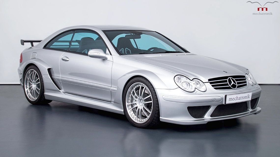

We won't talk about the foul up they make trying to roll the wheel-arches. Must have the widest tyres possible. Adhesion works on weight per contact patch ratio. Wider is not necessarily better. Of course compounding plays a huge role but they want them to last 70,000 miles. You can't have it both ways. And of course scrub radius is completely misunderstood so they widen the wheel to the outside only & force toe out under hard braking.
The right way to wide body a car. All are road legal & have leather upholstery & cup-holders,
This thread does not belong here so we will take some license on OT.
