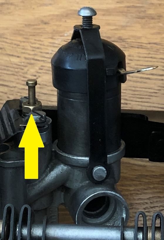

This is not about the AED turning off or on, it's adjusting while it's on and that is done with number 48, this is how to adjust the mixture so the car won't stall, anticlockwise to make it rich, and clockwise to lean it out.
Yours needs to be made rich, I would start with 2 or three flats counterclockwise.
This has nothing to do with setting the mixture on the carbs themselves, and that sounds correct. don't touch that.

Glynn, I have not been able to find any air leaks any where in the intake circuit.
I think I will increase the richness of the AED as per Jeff then go back to scratch with the timing and then the mixture of the carbs themselves.
