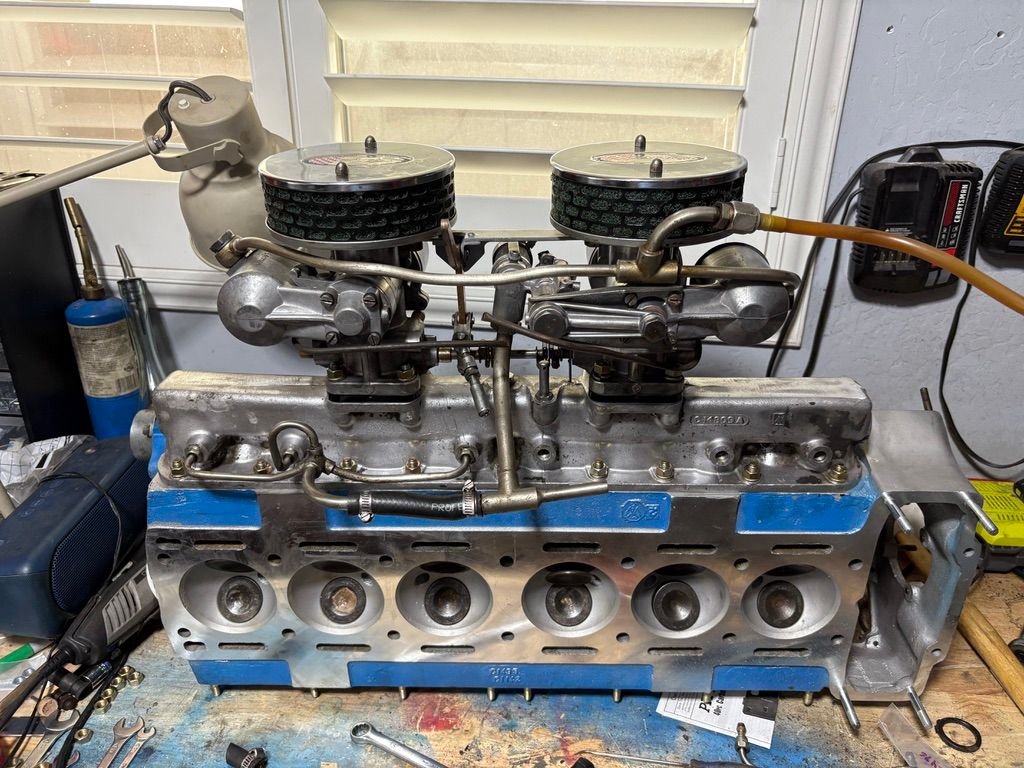

Does the pipe vent to atmosphere or feed back into the carb?
My MK II was aquired without an engine so I am restoring her blindly with no visible points of reference save the service manual and moss motors exploded diagrams - but they only show isolated parts of the puzzle.
Any help appreciated.

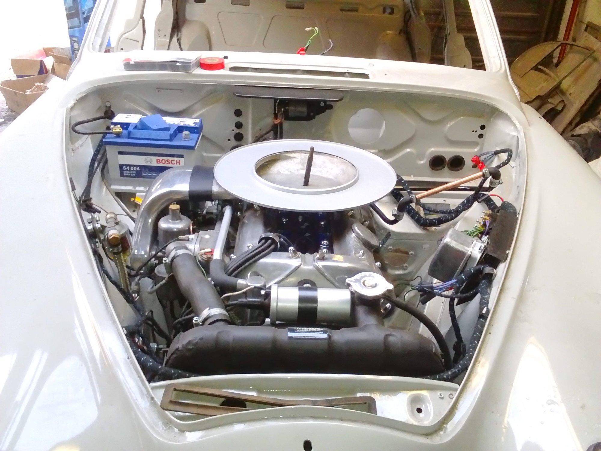

The 3.8 has a round filter casing with an aluminium section below, the breather on the front of the head connects to this.

Mine has pancake filters, so I can’t do this
