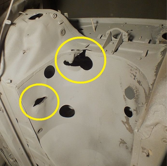

I hate to say it but I agree with Jose. The mistake was changing the VIN plate to match all the new bits that had been added. My S Type has only had one other owner from new. The old boy sadly died before I bought the car but during my restoration I found the gear box had been changed. Different number than that on the VIN plate. There were also holes in the gearbox tunnel that had been cause by a catastrophic explosion of the original gearbox that had not been repaired. The old gearbox was replaced with the same BW35 gearbox but not from an S type Jaguar according to the ID plate. I still have the original gearbox number on the VIN plate and it does not bother me.
This is the damage I found. What ever caused these holes circled in yellow must have scared the crap out of the driver when it happened. Shame I never met the old boy to ask what actually happened.

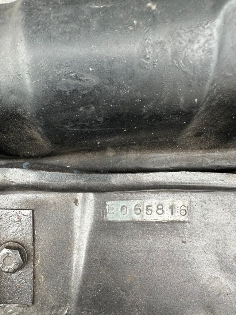

It does not actually have a BW66 transmission and the engine is LA which means it’s older than the car. The big problem for me was that an incorrect number was stamped next to the bonnet latch. It was a body number and not the Car/Chassis number. It’s pretty much the first thing you look for and anyone who has done a bit of study will notice it can’t be right. Stupid thing is the Dutch authorities used this as the VIN number and registered the car with this number. So technically it is legal but I think it would be very difficult to sell with a clear conscience. I know it would have bugged me and I want to be able to enjoy my car.

I agree but its the fact that someone has stamped the Body Number next to the bonnet latch means someone has been messing about with the identity of the car. It was lovely and it was very difficult to walk away.

I am a little confused over Rishi's last post.
In MK1 and MK2 cars the body number should be stamped next to the bonnet latch on the left-hand side of the car. (or to your right if facing the car backwards)
I have had 12 of these cars over the last 40 odd years (I still have 2) and that body number location is standard practice.

Isn't it the car number, not the body number that's stamped there?

It should be the Car/Chassis number not the Body number that is stamped there. The number starts with an E (a body number indicating a 3.4), it should start with 22 (a chassis/car number for a 3.8).
