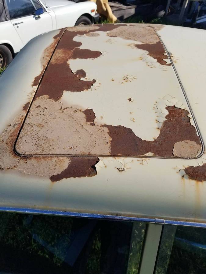

I have found another S Type for sale. This one has a metal sunroof that looks like its factory? I can imagine this is could be a rust trap, I don't see how it can drain? Any thoughts on this?

If the drains are not kept open on a metal sun roof you end up with a mess. The tattiness of the solid wheel car can soon be sorted with parts from John Skinner and a set of wires from MWS.

The drains run down the A and B pillars on an S Type (Webasto solid). I'll also bet you can knock a little off the price of that car with some negotiation from the 21000 Euros IIRC from the ads you posted. wouldbeowner from Australia has the same sunroof properly maintained. You can search his threads.

On my Daimler Double Six, the arrangement for draining water that gets past the sun roof consists of tubes that run down through the A-posts. The drains haven't caused me a problem, though we did swap the steel roof panel itself about twenty years ago.

The times you suffer blocked drains are in wasp country like Australia, SA etc. where they can block a pitot tube in an hour or two. Bill Mac can give us a long lecture on the subject as he has elsewhere here and his interests in aviation.

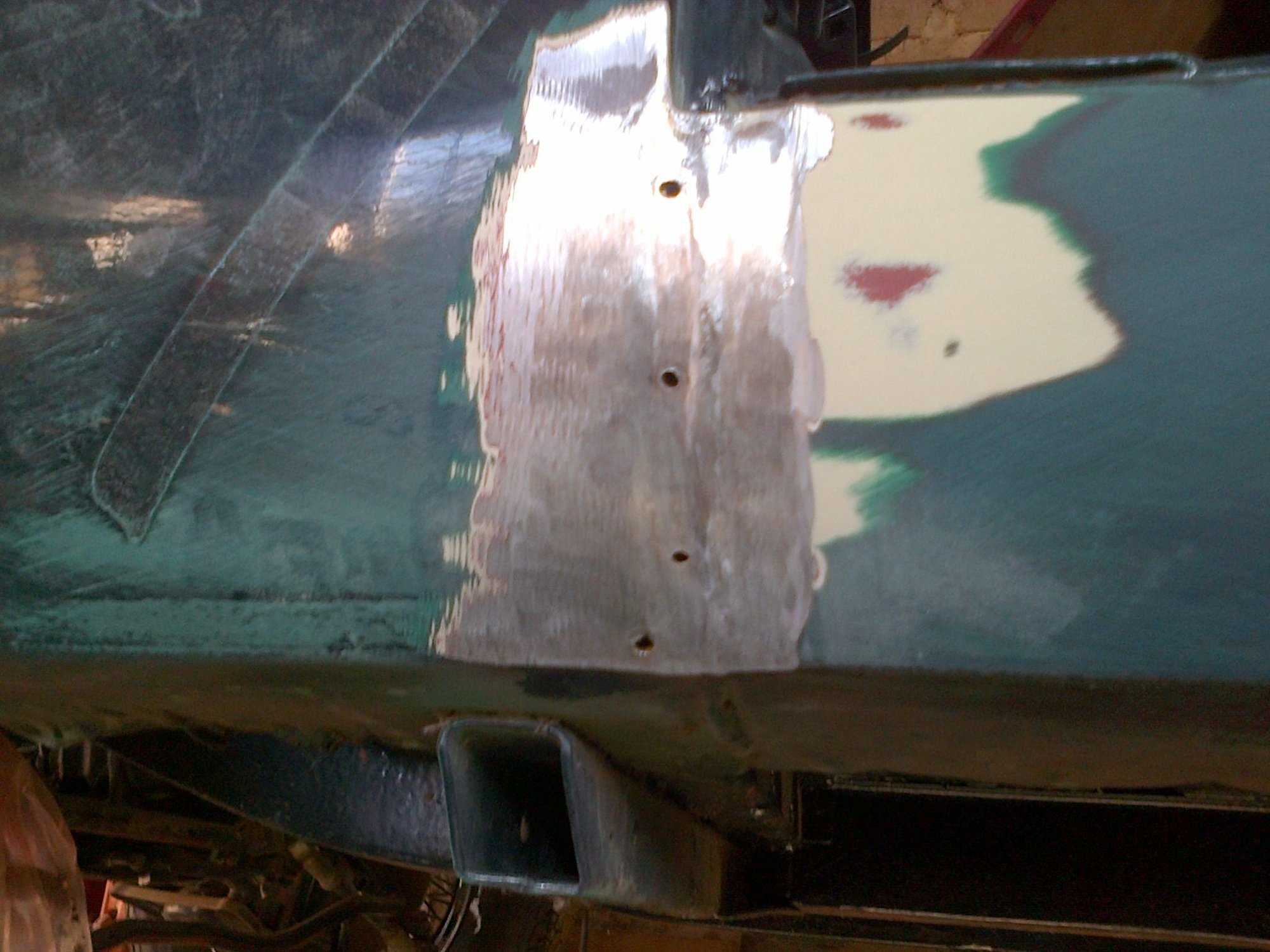

Just remember where the sills meet the front fenders is lead wiped so your fridge magnet wont work there. This seems the best buy thusfar. Depends how long you want to go on looking. Don't worry about black smoke. That means it's over rich on the starter carb needle. Only worry about blue smoke which means it's burning oil. This does seem a good honest car at least. Take a screwdriver and scratch some of the Dinitrol off at a rot spot. It is a good product.

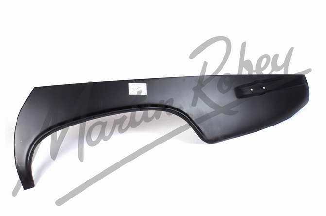

How big is the patch where the magnet won't stick where the sills meet the rear arches? It might just be a minor welding job to fix.
It's just the corner, maybe a couple of square inches (in a triangle)

That is very easily fixed by welding in a piece. No rampant rust.

Martin Robey can sell you this for 400 Pounds Sterling. I would not waste my time & money. Any good metal fabricator can fix what you need.

Certainly at the front, the wing to sill joint isn't easy to make smoothly so it's not surprising to find some filler. Filler or not, unless there are invoices for bodywork that includes that area (and preferably photos), I'd be very much inclined to cut a few inches out to see the condition of what's behind.

The front joint is lead wiped:
First respray. My car.
1) Media blasters coat ~ probably red lead
2) Filler coat
3) Base coat Spies Hecker
4) Clear coat Spies Hecker.
For rear sill joint just pull the plastic plug & take a look.
PLUG fitted here:
