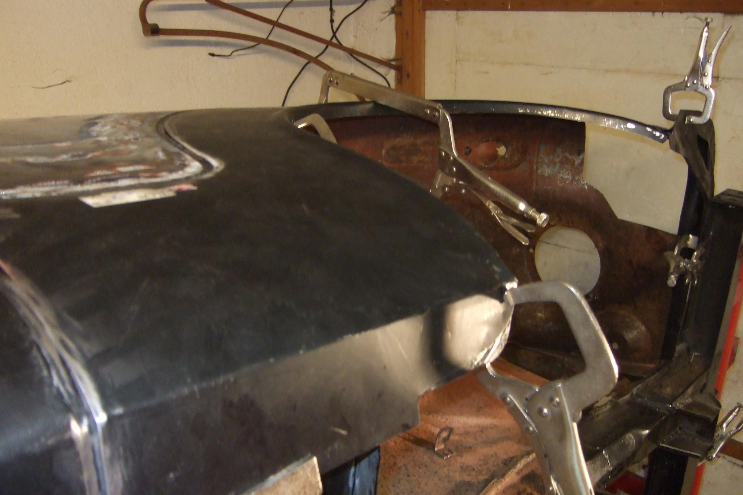

I have used them = no problems see my blog to see how they look although I used the complete section not just the rear. I attach a couple of shots showing the section in place.
