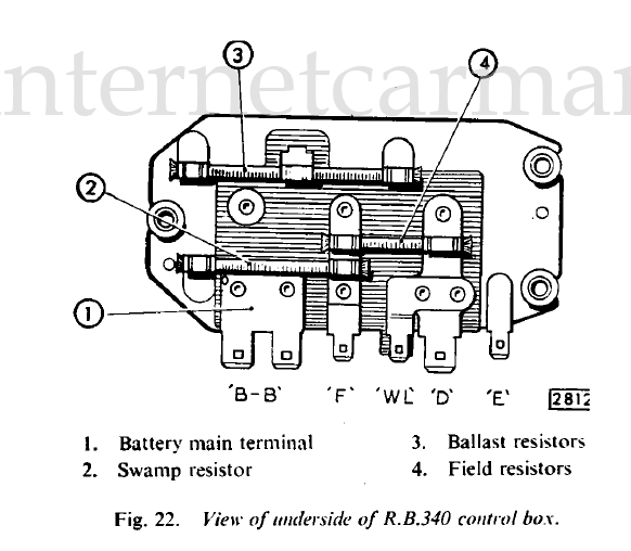

RB340 Voltage Regulator. See B - B that Bill refers to i.e. No1.

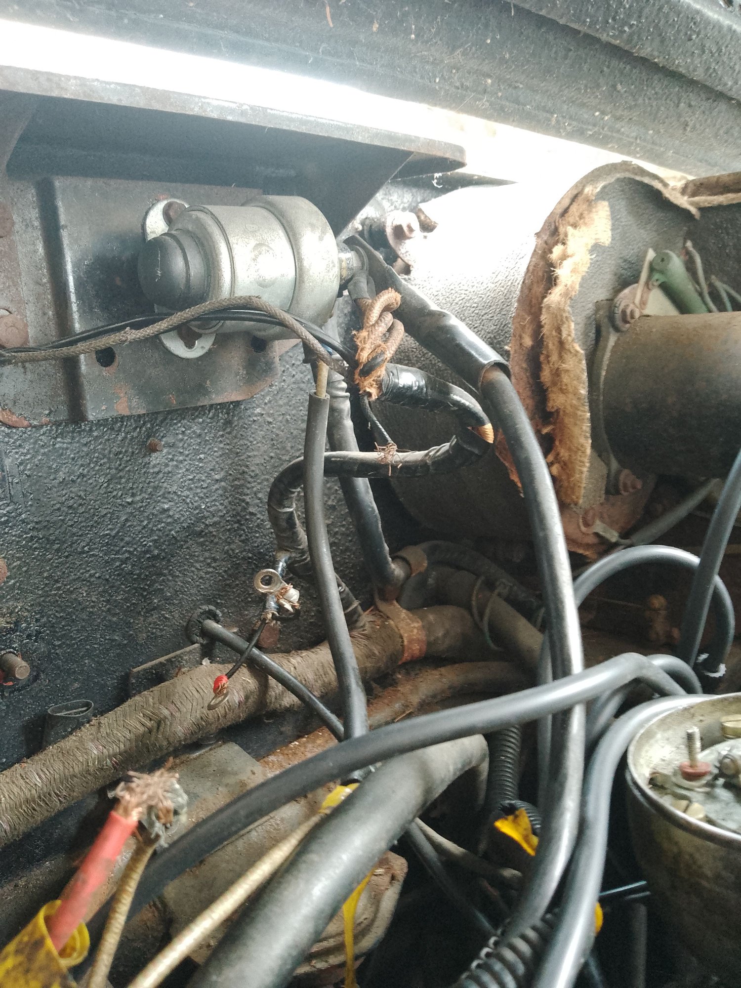

Default broken black wire

Just took a photo of something strange,,, theres a black wire with copper flex on the loom just below the starter solonoid that was obviously connected to something and has been cut,,, I suspect someone was fiddling around trying to figure this out before me,,,plus the 2 feeds to the coil someone has put a red collet on one ,, which of these goes to the points?

Originally Posted by aston0708
As I said earlier check connections at under-bonnet starter solenoid. That looks a bit of a mess. I will check wiring diagram.
