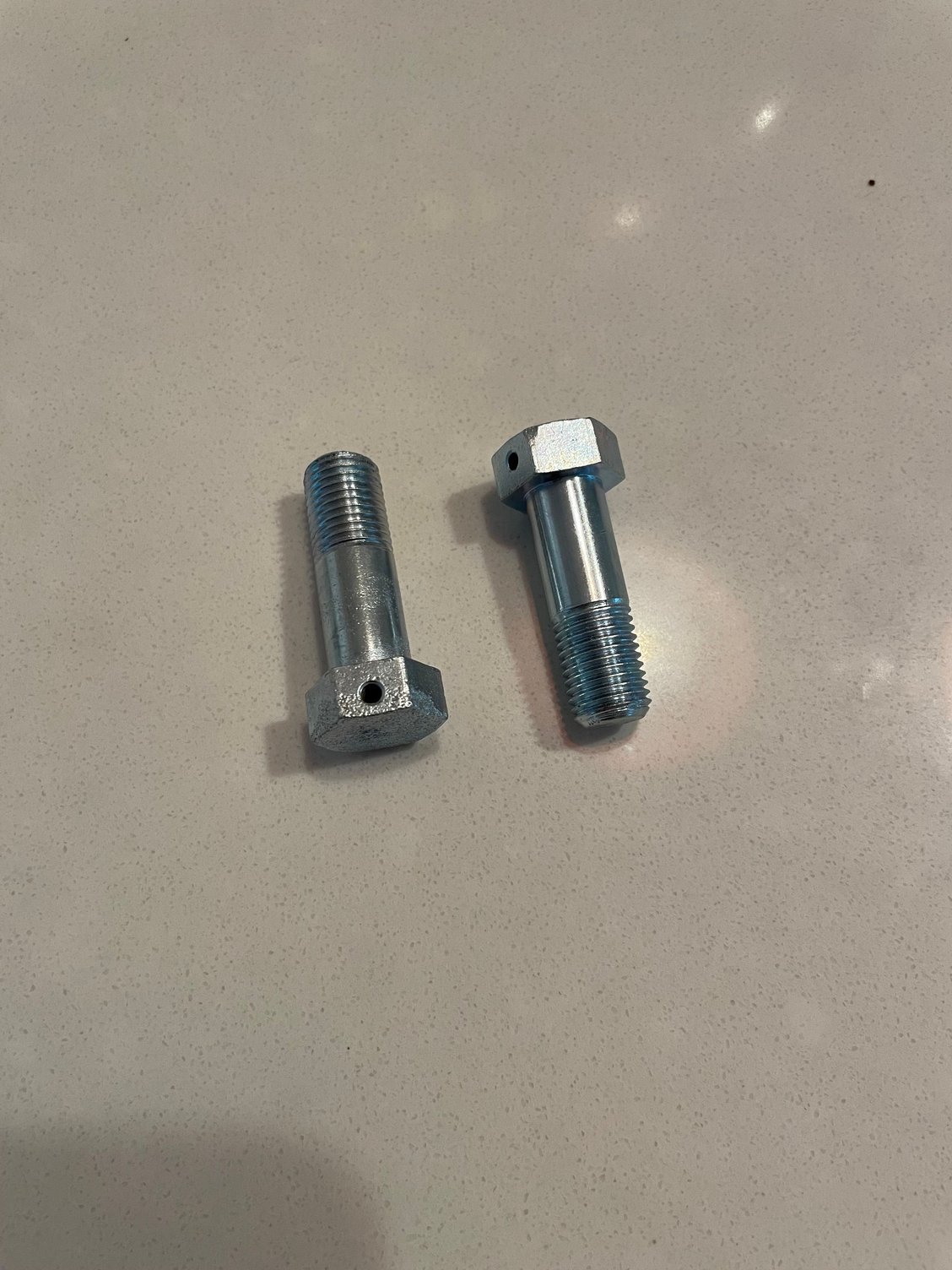

Can anyone tell me the size and length of the rear brake caliper mounting bolts? Mine seemed to have disappeared.

I happen to have mine handy. They are 7/16-20 and 1-3/8 long (measured from under the head), These are special bolts in that they are only partially threaded and have holes drilled through the heads for the locking wire.
Rear caliper mounting bolts
